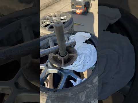

Anyone having done commercial wheels and tires work with any of the Coats brand 2020’s; 3030’s and 4040’s machines and others; knows this can be done easy-pleasie. Quick-quick.
I load up and now in detail study the videos in-use of their installer bars end forms.
I will not bore you with these. As a straight-on, flat, center slot stabilized bar system; probably not applicable to my offset round bar.
But this older Coats system bar end is:
Neat top de-beader wouldn’t you say? A sharp fellow could duplicate that and get the de-beading up off the ground, up to waist height too. With No more extreme flexing of the bottom post mounting.

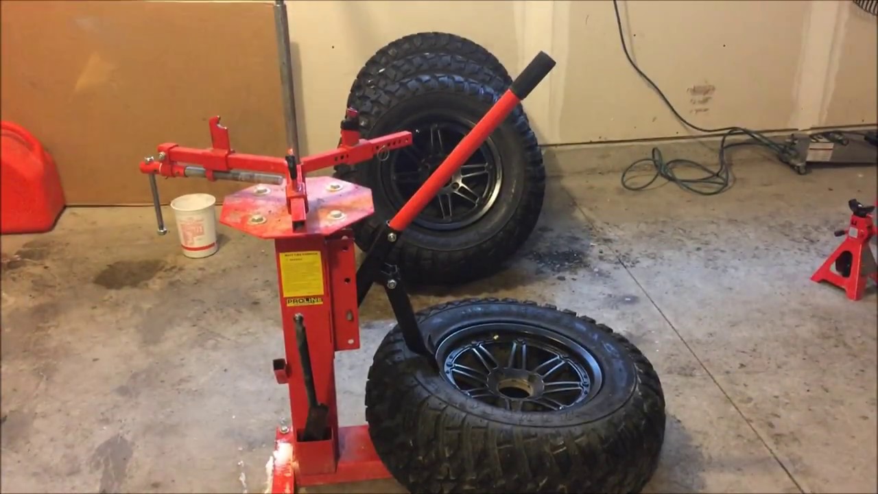

I was doing an inventory of all of my wheels and tires needs working and realized just how many small, mini and one piece hub wheels I have in my life!
14 in just this one picture. Plus 6 wheel barrow. 12 riding lawnmower types. 6 bicycle wheels and tires.

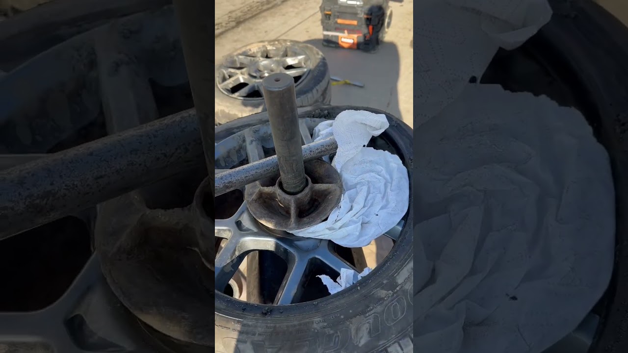

So modify the Harbor Freight post stand to mount accept shaft axle types? See the round white tube shaft I’ve inserted in the center for axle hole holding. . . then need a block raising up to that level . . . and some way to hold the wheel and tire from rotating . . .
Or additionally buy a Harbor Freight Mini-tire changer system. Youtube users showing these need use modifications too.

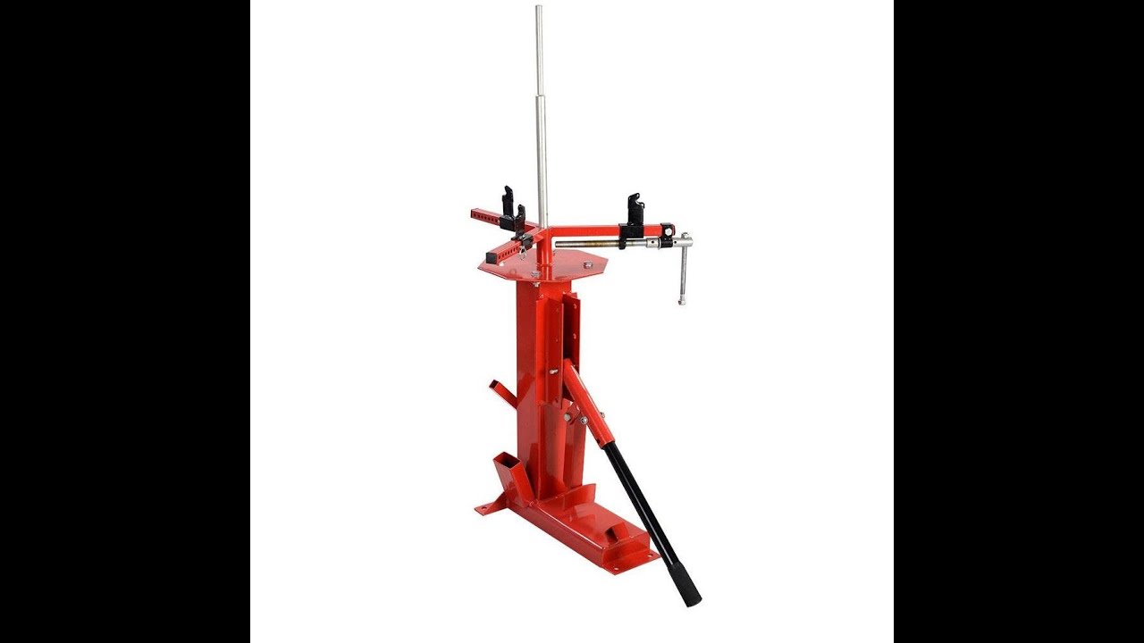

So instead I am changing my base system to this wheel rim-clamper style system:
Skip to 18:00 minutes on this last one
This changer system shows in Amazon . . . listed as no longer available.
E-bay available in the USA from three different sources $139.-198. USD.
$133. USD but shipped out of the far East.

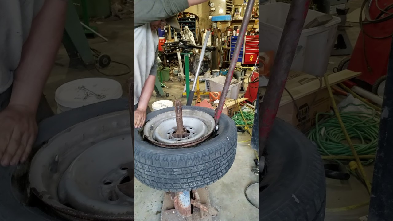

Here is a side-by-side video I had hoped would show both working. (No such luck.)
Does show the operator preferring the Rim-clamper system bead-breaker. It is stronger, with more range of adjustability.
But then the operator shows the same-same, you-know-no-better; mistakes; in the majority of these videos.
NOT lubing up adequately to allow the tire rubber to slide. Off. Then On. Then NOT needing the extreme forcing.
NOT keeping the off-side of the demounting/mounting tool-heads tires bead firmly pushed DOWN IN THE SMALLER DIAMETER CENTER DROP ZONE. Then creating slack at the steel wire core bead hoop.
Do these, then with the proper developed tools you will not need both arms and whole body ripping, tearing, and extreme torque twisting of the tires off and on.
One hand. 35-50 pound of force. The other hand then available to do the off-side pushing down.
DO rags wipe the lubes off as best you can before airing up and seating.
The best lubes are the commercial brands wax based, brush-on types. No-Mar’s water soluble gel. Both Ph neutral to not cause later wheels metals corrosions.
