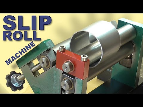

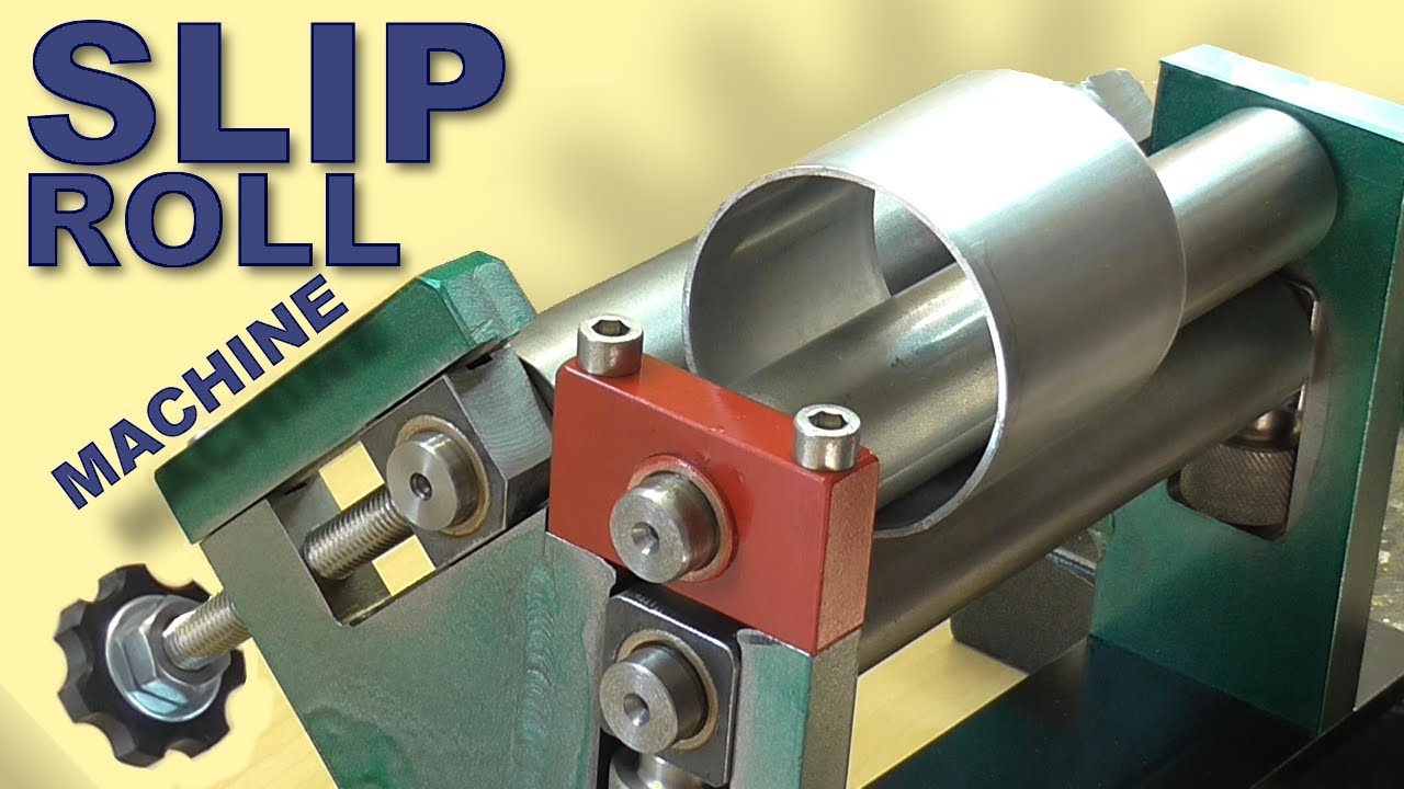

I think I remember that Matt Ryan built something similar way back in his thread. I’d be interested in seeing what you are doing with your slip roll, Rindert. I’ve thought about building one myself for a while now but never got it bumped up in the queue.
Hi Tom,
Kind of hard to give a word description that would tell you anything you cant just see by looking at youtubes. But one critical part is the bearings. I’m using spherical bearings from aliexpress, because they will not be destroyed when the rolls flex, and because of very high load capacity. Machining is not yet complete, but I think you get the basic idea. The two end pieces were tack welded together to simplify machining.
That’s impressive work Rindert. Do you have a mill to rout out those pieces?
This tire tool was junk. The plastic parts were too fragile and brittle. Definitely “do not recommend”.
My friend has a mill. He let me use it.
