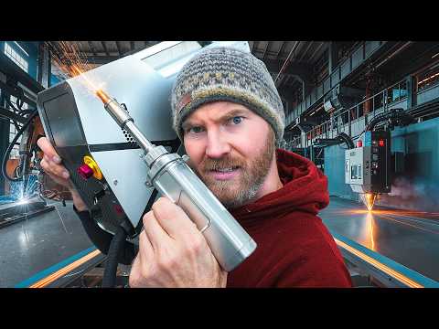

This i think will be the welders of the future once the price come down to what the average Joe can afford , i like that this is being tested by a non paid guy that i have watched for a few years on his Diesel heater project ,so i would take his word over any company blur .
Does everything I would want out of a multi-purpose machine. I would like to see it tested by some one with actual test equipment, like the Torque Test Channel. If it was priced around $2500 then it would be in the same ball park as a Lincoln multi-process unit with a spool gun but with the ability to laser clean and cut. Really not that bad at 5 grand. That would be the equivalent of about a hundred eggs in the U.S. I’ll start a go fund me page and get a lot of saps to buy it for me.
I am guessing it will take quite a while for these to drop in price. If I had the extra 5k to buy one, I would have one. I can’t justify it at this point though.
And I think he got it for free for his video “it was nice of them to send me one to test”.

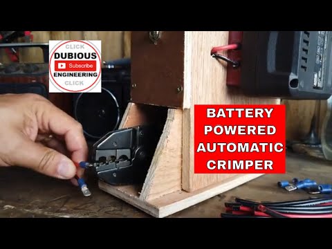

I found out the dental pick they sell at harbor freight work extremely well for removing wires from small connectors. And I also found out, I suck at crimping the small connectors. ![]()
It is best if you have the correct crimpers for the size of connector, wire gauge, and brand / style. Sometimes you can get the factory ones at a swap meet, or surplus, otherwise way too expensive for hobby use. I bought a used pair of (factory) crimpers at a ham-fest once, and they work excellent. the “one size fits all” crimpers can work, if you get a good pair, Molex brand, or other quality made. Most of the time I use solder-pocket connectors, solder splice and heat-shrink tubing, or just screw-clamp type terminal strips. Your results will vary! ![]()
part of the issue for sure. ![]()
The other part is I am using the jst 2.0 connectors, and they are too small to hold them correctly with my fingers. I figured out, I needed to make a ‘jig’ of sorts to hold them at the correct distance from the crimpers. Part of that issue is I am using 20ga wire instead of 22+ ga wire the connectors are designed for. (the other end of this wire is using 2.54), and it is really too thick so I cant bend the tabs parallel before I start… I just plugged it into a male connector and trimmed off some of the plastic to hold it, and while not perfect, it actually turned out okay.
The racheting crimpers I have are knockoffs of the higher end ones with the same adjustments. But they pressing down perfectly square either.
Yup, and the time and effort needed to get thru the learning curve doesn’t seem worth it to me, because I wouldn’t use the skill often enough. So I just use solder whenever possible.
With the right size wire, it isn’t that hard. I think I ruined like 4 the first time I did it.
Only needing exactly 2mm of wire showing and the not bending the tabs parallel first got me the first time.
This was just too thick of wire, but I didn’t want to wait two weeks for shipping again. I would have melted the insulation even if I used the low temp solder paste.
If I can solder, I usually do or I will do both. Tiny connectors and too large of wire isn’t a good combination. ![]()

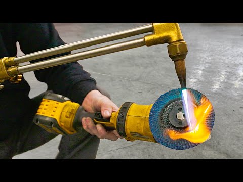

This guy tested various methods of how to rejuvenate flap wheels. He isn’t quite as entertaining or scientific as the guy that tests power tools, but still fairly rigorous.

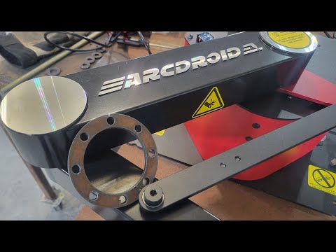

Here is a neat little tool for 2500 bucks.
You attach your cutter like a plasma, gas torch, laser torch, etc or if you just want to draw, I suppose a pen would work too. It has an onscreen that you can design simple stuff or you can draw up your own designs in a cad program and feed it to it. It doesn’t have the largest reach. There is another manufacturer that has a $10k that lets you move it during the cut so it is continuous. And really the nice part is the size of it, you can stow it away in a small spot.
