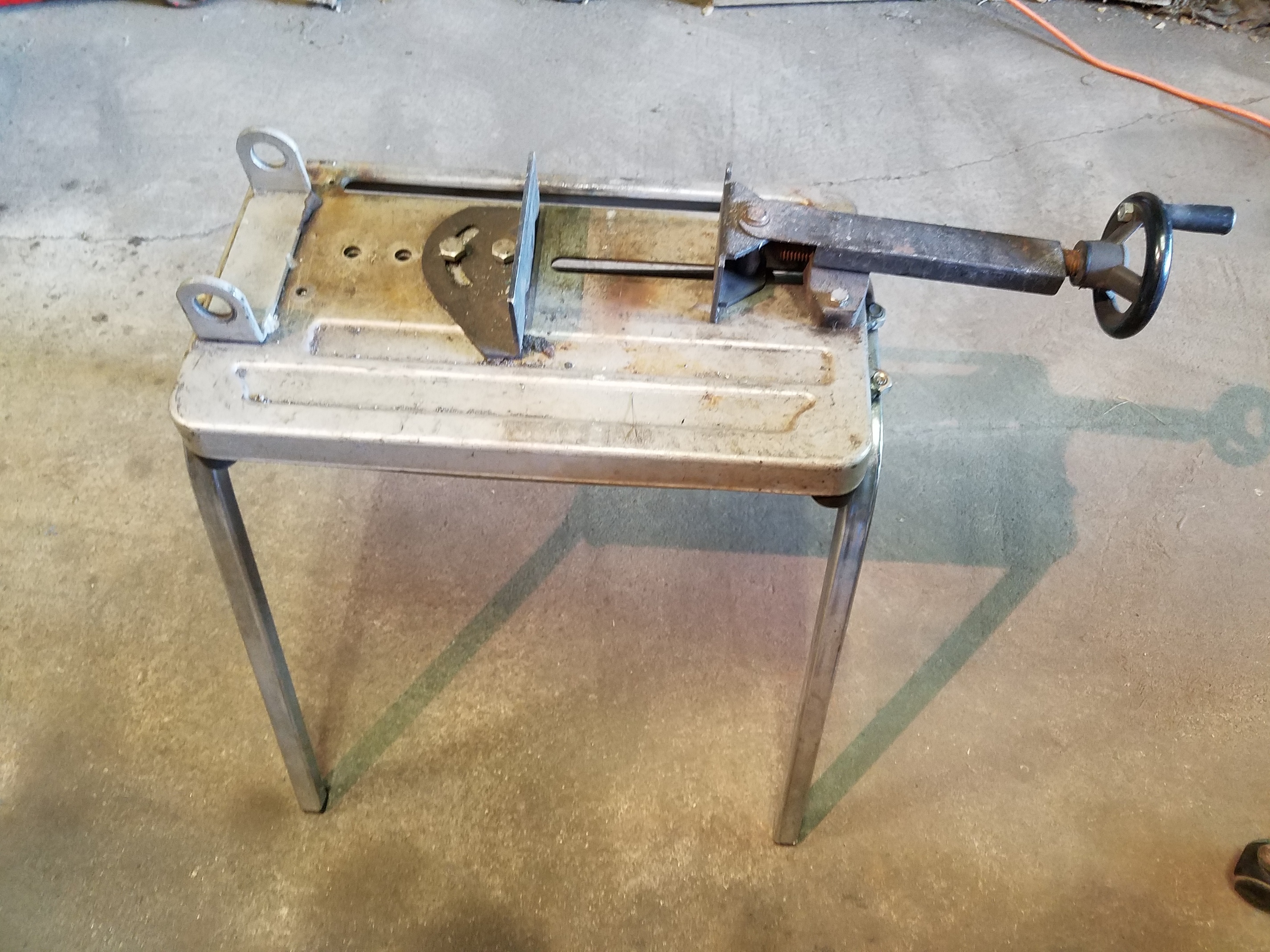

I had a cheap Chinese chop saw that lasted ten years or so but it finally puked so I re-purposed the table and vise for a welding/holding/assembly table.

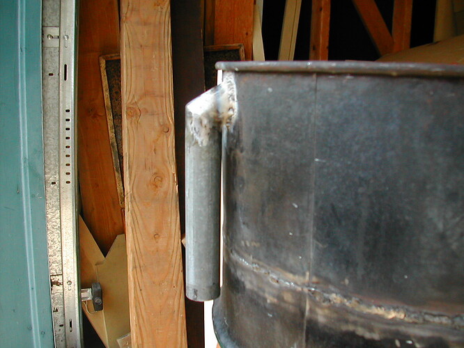

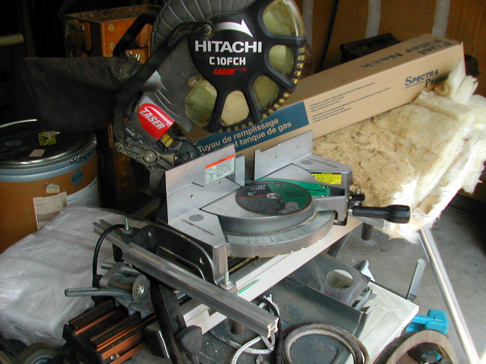

I was able to use this mitre saw with a thin abrasive blade to make nice angled cuts to make this drain pipe. Make sure you clean the sawdust out of the machine first, or you will start a fire.
How do get the nose of your mig welder in that tight spot between the barrel and the pipe?

If no other local complications, heatglow – hammer – “trumpetize” the pipe-end first.
Sorry, I did not observe, that it was connected to Rindert’s “fastbent” application!
In this special case welding from inside the barrel would be easier, to the ready-made knee.
(mirror-welding)
That must be the soup drain, nice job welding.
I cheated. Fluxcore wire doesn’t need a gas sheild so was able to do about 2" stickout.
Nice! I’m going to go cut that little piece out and do that
Yup, chicken noodle.
That is a tight space to weld, good job
I would never have guess you did with flux welder, they do have some advantages over gas. Great job.

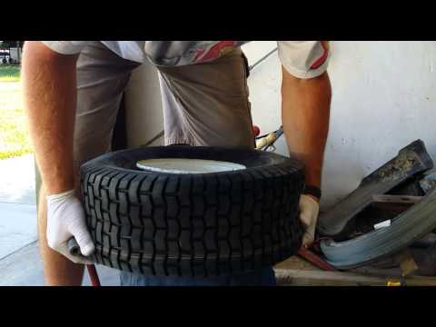

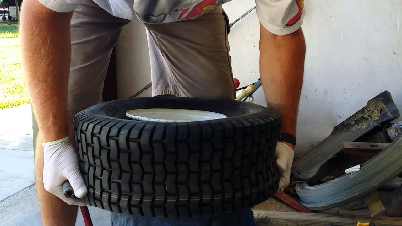

Not woodgas related (unless you have a wood powered riding mower!) but I found this REALLY helpful today.
Ever tried to mount a tire and had trouble seating the bead? Here’s a neat trick.

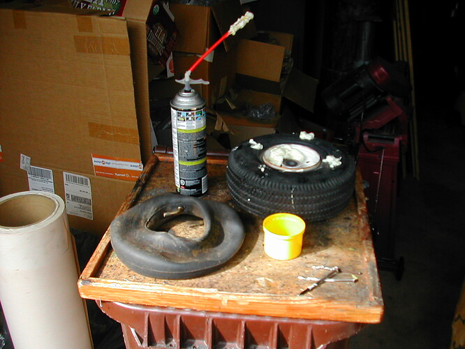

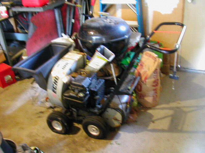

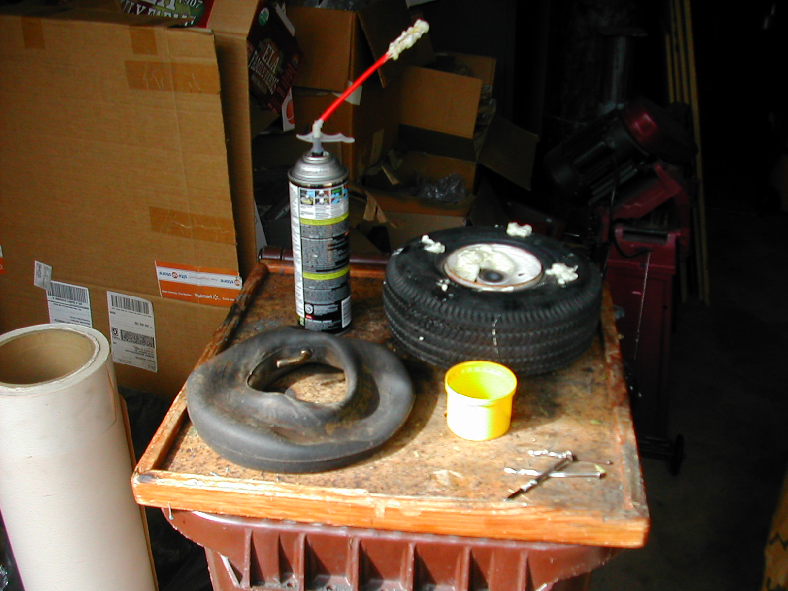

I have an old Chipper/Shredder/Vacuum from the 1970s. The tires were very bad; cracked, dry rotted, and everything else. I filled them with large gap filler foam from the building supply store near me. I had to explode some propane in them to get them to seat. Messy job, but they turned out alright.

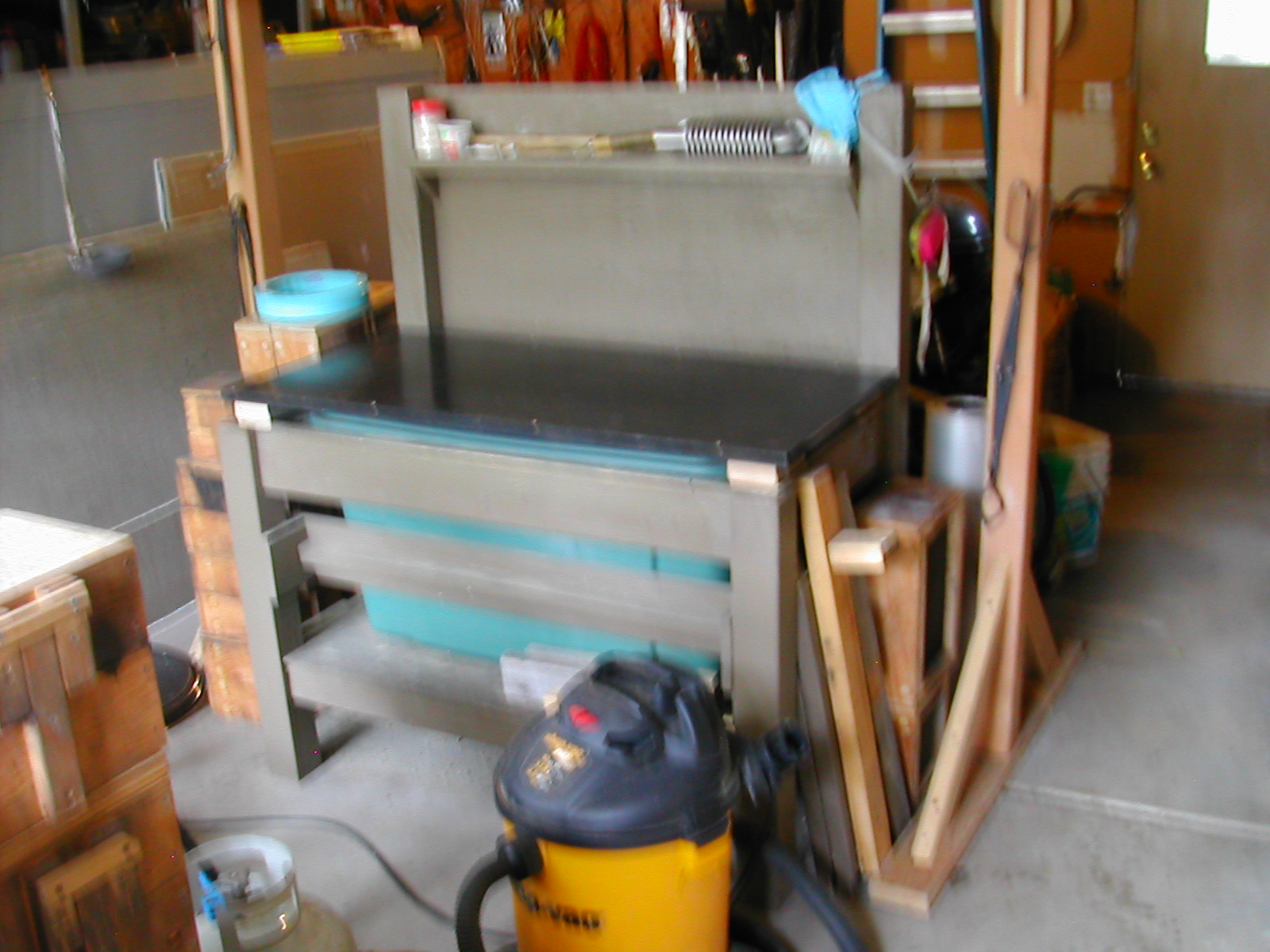

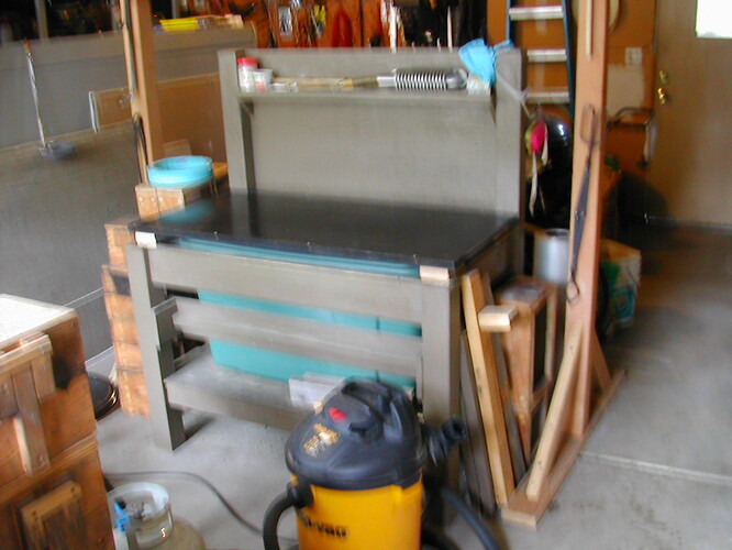

I scrapped an old treadmill and got a lot of good parts.
The deck makes a very good work table top.

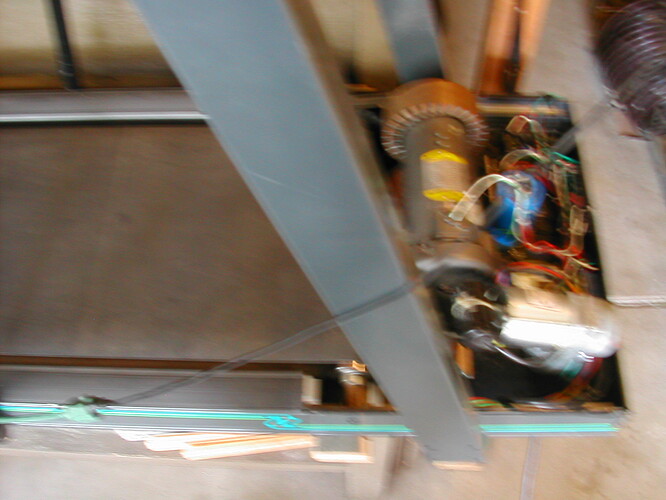

I am using the incline motor and ACME screw for a foundry mold separator machine I’m building.
I am going to use the motor base plate, 3/16" steel, as a table for the foundry mold separator machine.
I got about 30lbs of good aluminum that I am going to melt and make things out of.

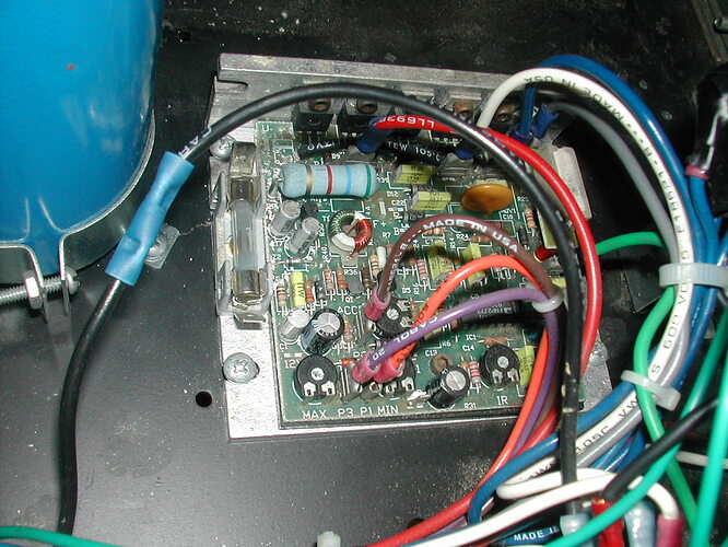

The main drive motor for the belt is huge and heavy, 3 horse power continuous, 3.9 peak. And it’s variable speed!!! I wish I had a milling machine to put it on. It might make a good driver for a wood chunker. But I already have a 1 horse power single phase motor for that.
Take a look at Dave Gingery’s series of books, he has solid instructions on making a mill. I saw a scaled up blog of his lathe, worked well. His machine tools are largely based on cast aluminum…
Thanks Garry, I’m an old fan of those books. And I do pour aluminum. I might end up doing as you say. But I have have my eye on an old Machinist Corp, made in Spain, at the place I used to work. Its going to be a heavy one to move, but thats the way good ones are.
Rindert, I have one of those sitting in my basement for years. I am not technically inclined like you so there is will sit until my wife decides it has been long enough. I fine it hard to believe that belt drive motor is 3 horse. TomC
