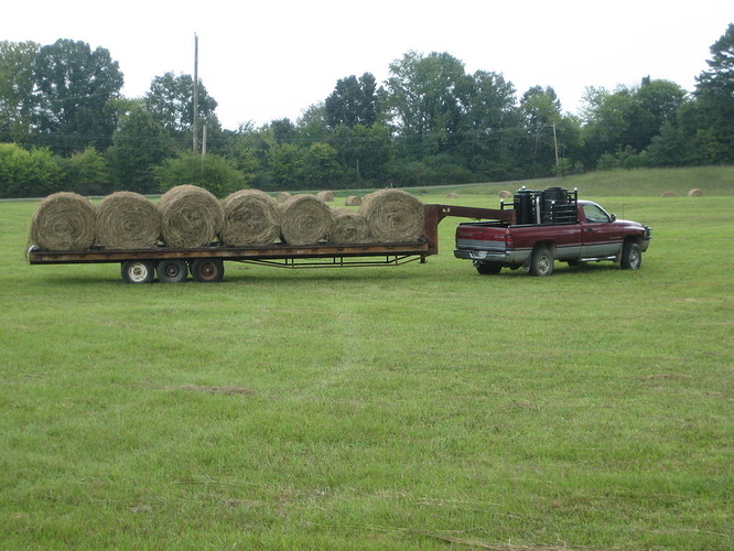

I will be out the door in just a little while and firing up my wood burning work truck . I will be pulling a 40 foot trailer hauling hay . I expect the weight and the load will be over the 10,000 pounds you mentioned . Also the trucks weighs about 9,000 pounds.
I will be making short 8 mile round trips and will be able to run 100% wood. If I were making longer trips and staying up with traffic I would need to add in a little gasoline to avoid overheating the gasifier.
When hauling cattle to market I can usually make a 20 mile round trip with no gasoline if traffic is light.
One can build a gasifier big enough to handle the loads at higher speeds but if the same gasifier is operated at slow speeds without the heavy loads the gasifier will run too cold and tar the motor .

According to the identification tag in the door of the truck the GVWR is 8,800 pounds .
I am not sure what the total loads would be, however the trailer are heavy and plus the weight of the loads being 5-8 thousand pounds ?
As long as I keep my speeds down , on level road and no need for heavy acceleration I need no gasoline. Usually when I add gasoline ( hybrid ) it is not for the lack of power but to keep the gasifier from over heating .

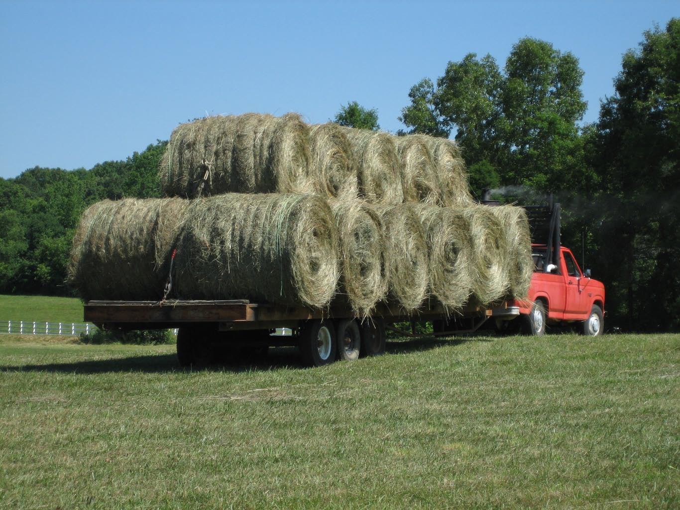

The GVWR I’ve learned is the total max weight of the truck with people, cargo etc… the GCWR is the overall weight of tow vehicle and trailer everything. You minus the GVWR from the GCWR and that’s apparently how much trailer weight the vehicle can tow. I can probably look it up if you don’t know if I know more about that specific truck, It’s beyond impressive that it can haul those loads on the wood gas, in this photo of yours that’s definitely well over the weight of my 35’ 10,000lb travel trailer. Basically I’m trying to make sure the truck I get will still be able to pull my trailer once converted to wood gas because you’ve mentioned in your videos it loses 30% power. So I’m thinking you must have a heavy duty truck and I need to go for the same amount of power. Unfortunately that link to the thread on hybrids says I don’t have permission to view it, youtube links work though. THANKYOU!! :Dgrin:

The truck and trailer will haul much more weight than I usually haul but I can’t see through my mirrors . Also with the hay stacked like in this picture a couple of men can’t roll them off , must have a machine. They weigh 750-1000 pounds each.

Looking at the last photo I see an F150.

Good after noon Wayne K did you have too hybrid the f 150 much too haul that load home.

The ole ford is a F-250 with a 460 cabureted motor .
It is only about a 4 mile trip home with this load so the gasifier does not have time to overheat .
. No need to add gasoline because I don’t need a lot speed on this trip .
This being a carbureted motor it is more difficult to drive hybrid compared to EFI. The best way to work this truck hauling heavy loads would be driving until the gasifier is getting hot and switch to gasoline allowing the gasifier to cool and repeat as needed .
