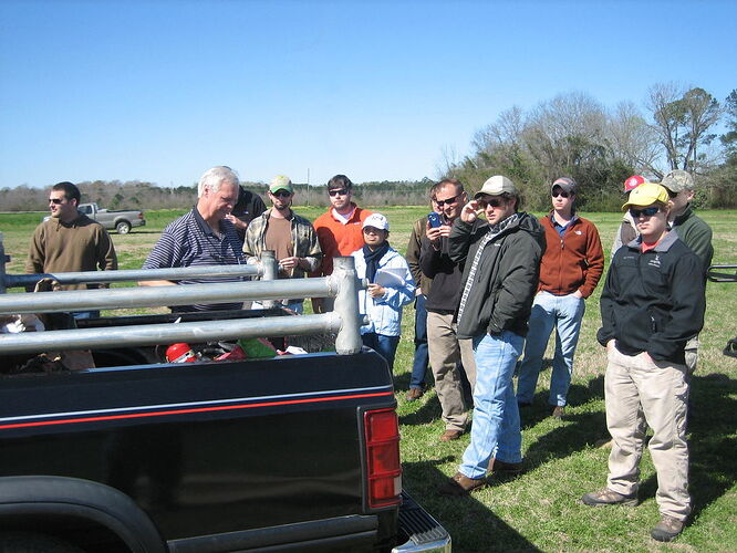

I put about 350 miles on the Dakota today going to Auburn University.
Here is a pic from there of the bio energy class.
Hard for the students to see the flames but they could hear and feel it.

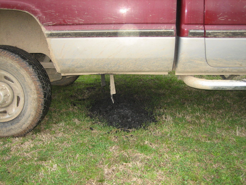

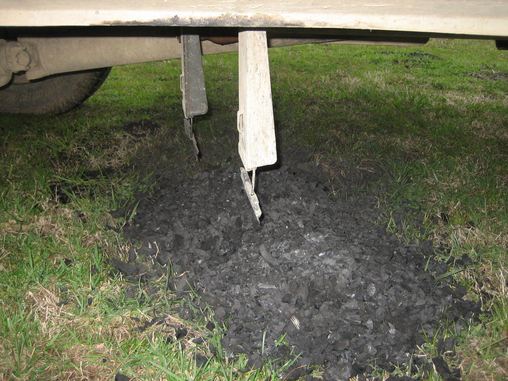

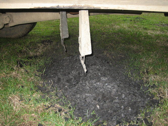

I dumped ashes this morning and this is about typical. This is 400-600 miles of ash.
Hi Wayne,
I was expecting to see a lot finer ash. Is some of that char that would still burn say in a barbecue grill?
Don
Hello Don,
Yes Don it could be used to BQ. But most people like to use it as bio char and mix it in there gardens.
I try to dump in the garden or any part of the farm that seems to need more nutrients.

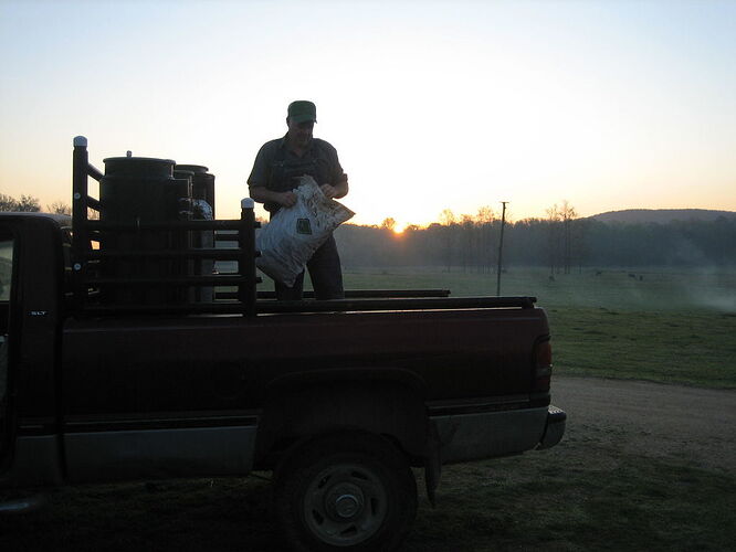

Early light up and gone.
Told the wife I had things to do and places to go!!

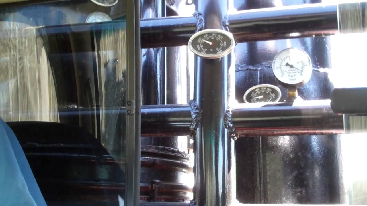

Once I reach a reasonable cruising speed it seems to take very little throttle to maintain this speed if it is level road.
I think about 1/8 throttle to keep this speed.
BBB

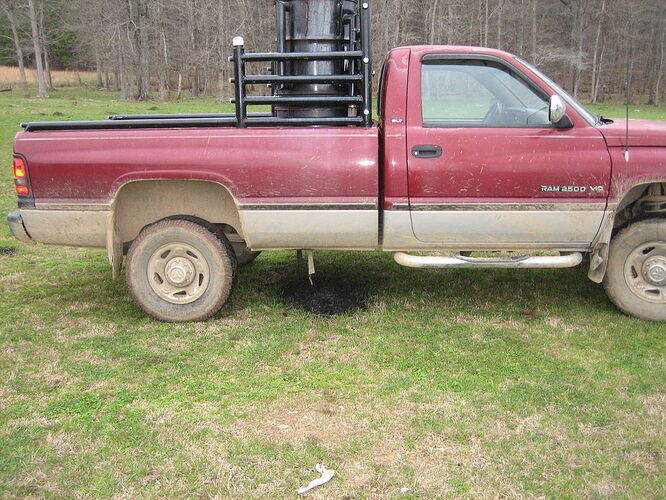

What are the dimensions of the cooling rack on the V-10? What size pipe, etc?
Hey Chris , I will check the size tomorrow morning and get back with ya.

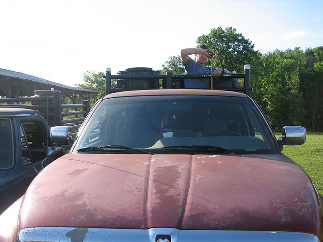

Good Morning Chris Franklin,
On my V-10 cooler the horizontal pipes are 2-3/16 OD with the exception of the two 2-3/8 horizontal pipes at the rear of the cooler.
Because I am pulling gooseneck trailers and to keep the trailer clear of the cooler I ran a single pipe ( vs. two or three ) on each side of the truck
The vertical pipe I used is 2-7/8 OD.
If you can find 3 inch square tubing for the vertical part of the cooler it will be much easier to build. (Take a look at Chris S. cooler with the vertical 3 inch square tubes.)
(2 inch PVC pipe will fit the 2-3/8 OD steel pipe)
I have some 1-7/8 tubing I will be using for the horizontal part of the Dakota cooler I am building.
You may need to hook to one of your trailers and judge where to stop your cooler rack so you will be able to make sharp turns.
I have the trailer hitch located over the rear axle and have 64 inches of clearance from the rear of the truck to the cooler.

How high above the cab is the cooler?
Chris,
We just measured it. 12" or so from the cab to the top rail.

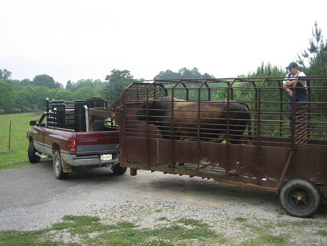

The wife and I was lucky enough to trap a couple of yearlings this afternoon and took them to the cattle sale.
It was about a 35 mile round trip with an old heavy steel home made trailer .
After about 15 sec start up on gasoline not another drop was used on the trip
