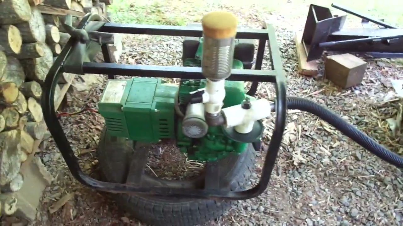

I have seen videos of Don Mannes, Gary Gilmore, and Wayne Keith running portable generators from their vehicle gasifiers. I had been wanting to try that, too, and got a chance to do it today. I have a 4000 watt no-frills generator with which I can run the essential devices in my home and/or the water pump. Starting the water pump puts quite a load on the generator when running on gasoline, so you can imagine the struggle when running on charcoal. At first it would not start the pump motor. After a couple of tries, I adjusted the air mixture valve until it pulled the starting load just fine as you can hear in the first video. The engine sounds a bit odd in the recording, but in real life it sounded normal. Here are two brief videos of it.
