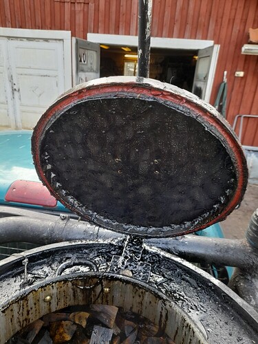

Jan, I would try it with the lid you have, because it is hard to seal the lid with positive pressures but a vaccum helps seal the lid down tight. My lid leaks too when using the pusher blower. But on a vaccum blower it is sealed up good.
This unit is making some nice engine quality gases.
This is a lid for a central vacuum cleaner that I used on my first attempt 25 years ago, it did not work so well then either.
I have made a new cover for the S10 that works quite well, but I have made it flat, which is not good for the condensation, I got tips from JO and Don for it, so I will probably do the same.
