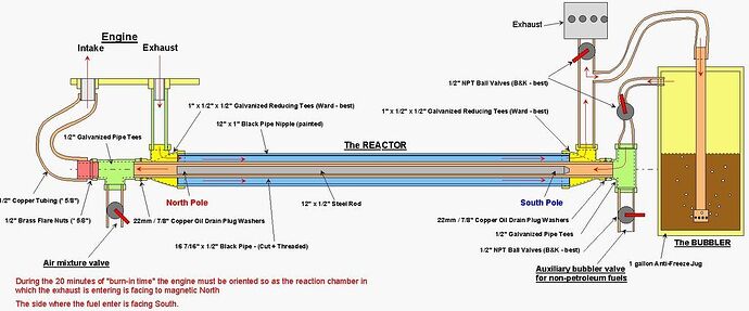

Hi Richard and fellow wood gassers
I completely agree with Brentw on the Geet process.
I saw it on youtube, studied it very closely and then built a unit to run a 11Hp Brigs and Stratton, the engine ran a 12v 90 amp alternator that I had several sealed beam head lights attached to so I could place the system under load.
I ran the engine and Geet bubbler on 100 ml of pure petrol to get a datum to start off with. I can’t reminder the exact time but it ran for a good few minutes with 6 x 60w sealed beam head lights burning.
I then ran it with 50ml of petrol and 50 ml of water. It ran for less than half the time and there was a little water left in the bottom of the bubbler.
Then I tried 50 ml of petrol and 50ml of diesel , it ran for a good deal longer than on just straight petrol.
Then I tried 50 ml petrol and 50 ml old engine oil, it ran as long as the petrol/diesel mix but left some tar in the bubbler.
In conclusion you can vaporize any hydrocarbon in the Geet system and mix it with water/mountain dew/sugar what ever it will vaporize a little of the H2O but it won’t help your fuel consumption !

thanks Patrick, my adhd is so bad i completely forgot to add a few important things:
in the geet info it talks about how synthetic oils are extremely hard to crack, apparently organic hydrocarbons with low additives vaporize easily, crack easily and burn with minimal ash formation. the geet info says synthetic compounds will gum up the geet.
also i didnt state the parts about intake and exhaust restrictions clearly: paul said restrictions would help power. obviously a huge restriction hurts power and my build proved it further.
(another crazy story paul told was a cross country trip with no engine oil and no antifreeze, and no working ignition system was needed for his geet engine van) i began to wonder after that…
from what ive experienced many things that guy said were completely insane, or the EXACT OPPOSITE was true
and patrick, just wondering if you could answer a few things since i only ran mine for a short period of time on gasoline mixed with a bit of water only (then i ripped all that junk off), i never used oil:
did you see any plug fouling, or exhaust smoking, and did you ever try a run without your rod in the geet, did the geet gum up on motor oil?
thanks
and anyone else with geet experience feel free to chime in

Hi Brent
No did not try without the rod.
And no did not seam to foul up the plug, and no I did not strip the system to see if there was any fowling of the internal tubing. After my test I decided that the guy on youtube (Paul) was having a laugh.
After looking further there was no footage of Paul running his Geet system for any length of time!
All were short bursts that any vaporizing petrol would run and not consume any of the wonderful fuels he claimed!
