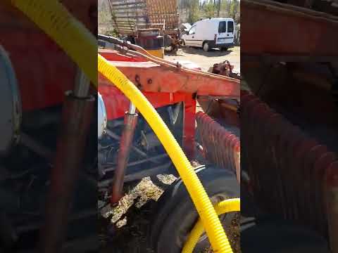

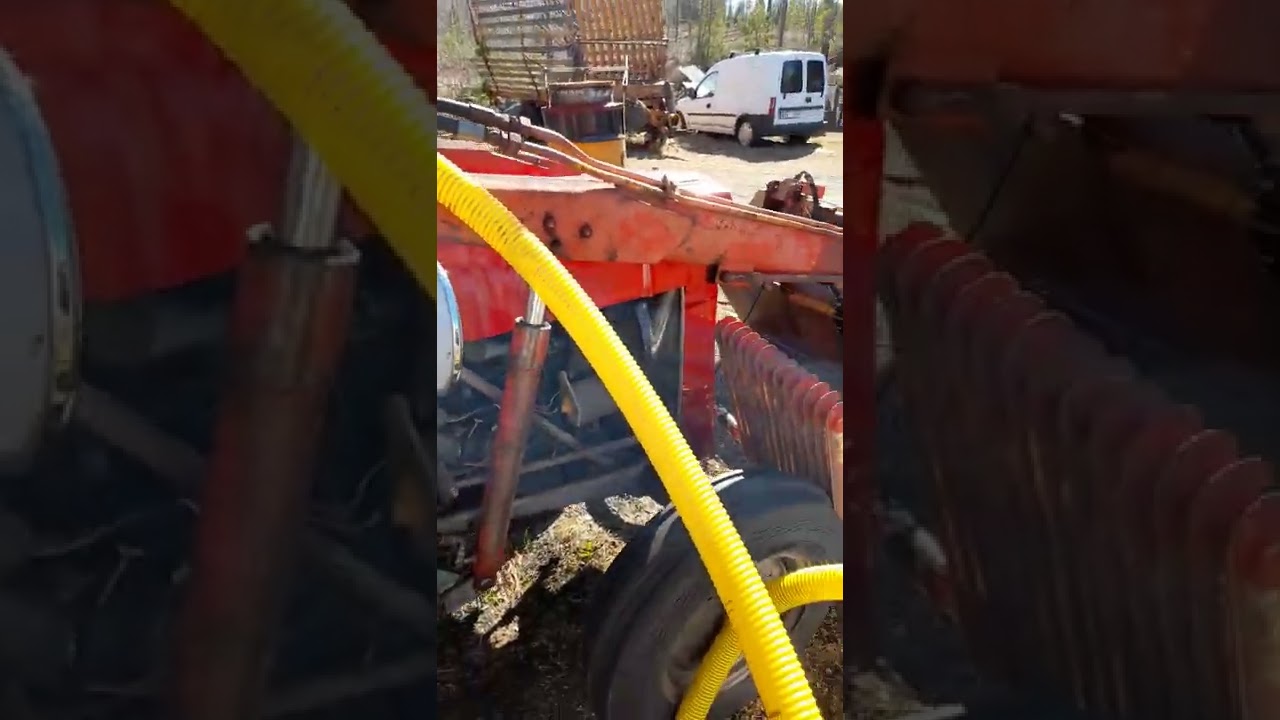

I tested the unit on the tractor yesterday, it does not work to go up in rpm, is it because I drive the gas through the oil cleaner, or is it because I have not changed the ignition, or is it something completely different that I do not understand?

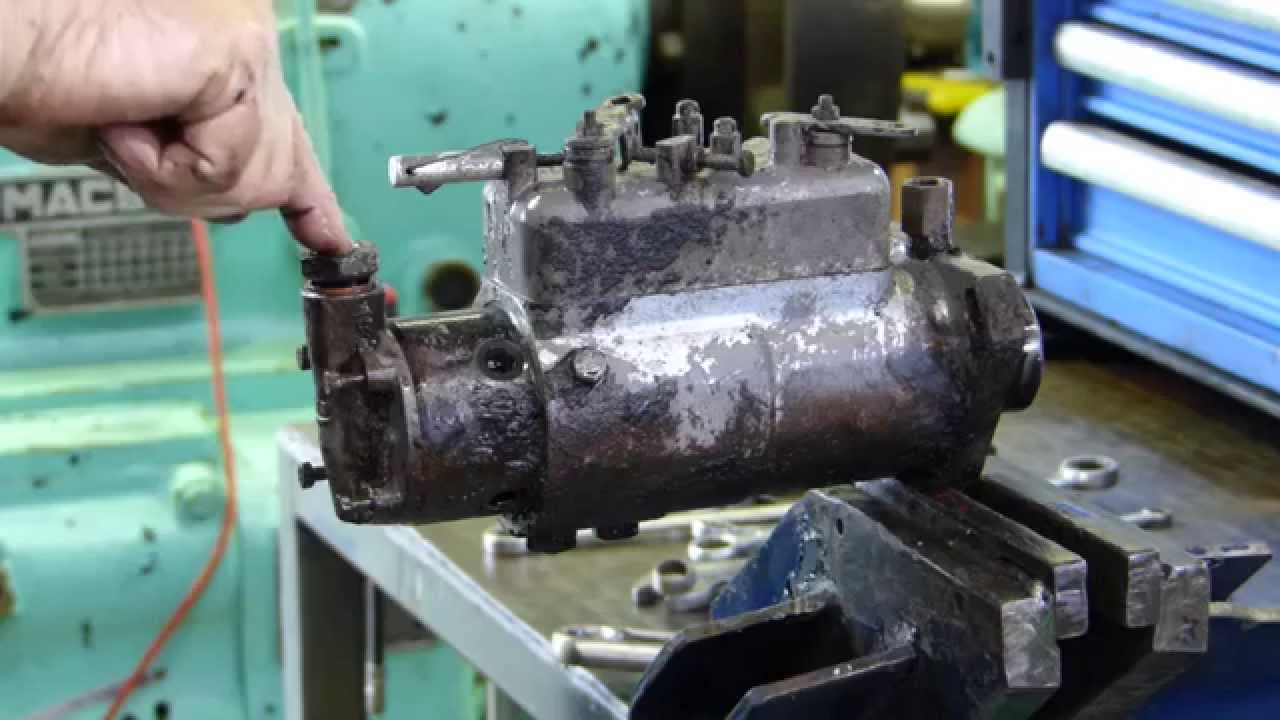

Hi Jan , as far as I can make out from the video , you have restricted the diesel pump and set the demand lever to Max , which should suit , then you try to raise the revs by enriching the mixture of wood gas and air , which should work . But the Lucas diesel pump , grrrr , how I hate it :angry: , if I think carefully about the principle of operation , I find that the stop lever and the speed governor springs operate on one element and that is the metering valve which doses the diesel fuel from the low pressure to the high pressure , in this case it is set to a certain minimum opening , which is sufficient to keep the engine running at lower revs , but when the revs would increase, there is not enough flow through this opening and there is no ignition in the engine. Grrr , … You’ll have to loosen the stop lever a bit so that the engine only revs with diesel fuel , … when you load the tractor (say with an electricity generator), you will only see the power of the wood gas. :grinning: :thinking: :fire:

Yes, as I understand it, G closes the diesel, by the rod goes to the right, and presses M. M presses N to the left and stops the rpm on the engine, if I can put a fork in the spring P and pull it to the right, so would not the engine rpm stop?
Why add a fork, since the lever K stretches the spring J, which pushes the spring P, which presses the position of the dosing valve O over the lever N to the limit previously limited by the lever G. The centrifugal regulator will still limit excessive speeds or set speeds .
I do not think I understand this, but if I were to remove the spring and shaft P, would not the engine go up in rpm on gas then? Then there is nothing that holds against the regulator?
The preload tension of the spring P presses the position of the dosing valve to the limit position set with the lever G, the amount of fuel should be sufficient so that it can rotate unloaded to the final speed, and wood gas will give useful working power.

Jan, watch the video well, on the left is the stop lever, on the right is the speed adjustment lever, below is the spring that returns the stop lever to the operating position and at the same time the speed adjustment lever to the minimum position, so if you install a suitable spring on the stop lever and so you limit the amount of fuel, this limit would vary depending on the position of the turn lever, so it would optimize diesel fuel consumption, I hope you understand.

I think I understand what you’re saying, but I do not understand how the pump works.
If O is locked in idle mode (is the amount diesel?)
And N is completely gone.
And K in high rpm.
Would rpm then go up on the engine with the help of the gas?
Ideja je, da O ni v popolnoma zaklenjenem načinu, ampak minimalno odstopa na več goriva, ko se K premakne v visoke vrtljaje, s čimer se poveča odprtina za gorivo, tako da motor dobi dovolj goriva za visoke vrtljaje. Krmilna črpalka za gorivo s svojim regulatorjem zagotavlja stalen tlak na dozirnem ventilu O, ne glede na Ŕtevilo vrtljajev, zato je treba ta ventil za velike hitrosti Ŕe malo odpreti. Ko je traktor v obratovanju, boste videli, da se pri tako omejenem gorivu skoraj ne more premakniti z mesta, kaj Ŕele vleči kaj za seboj, ko pa dodate plin, razvije delovno silo.
