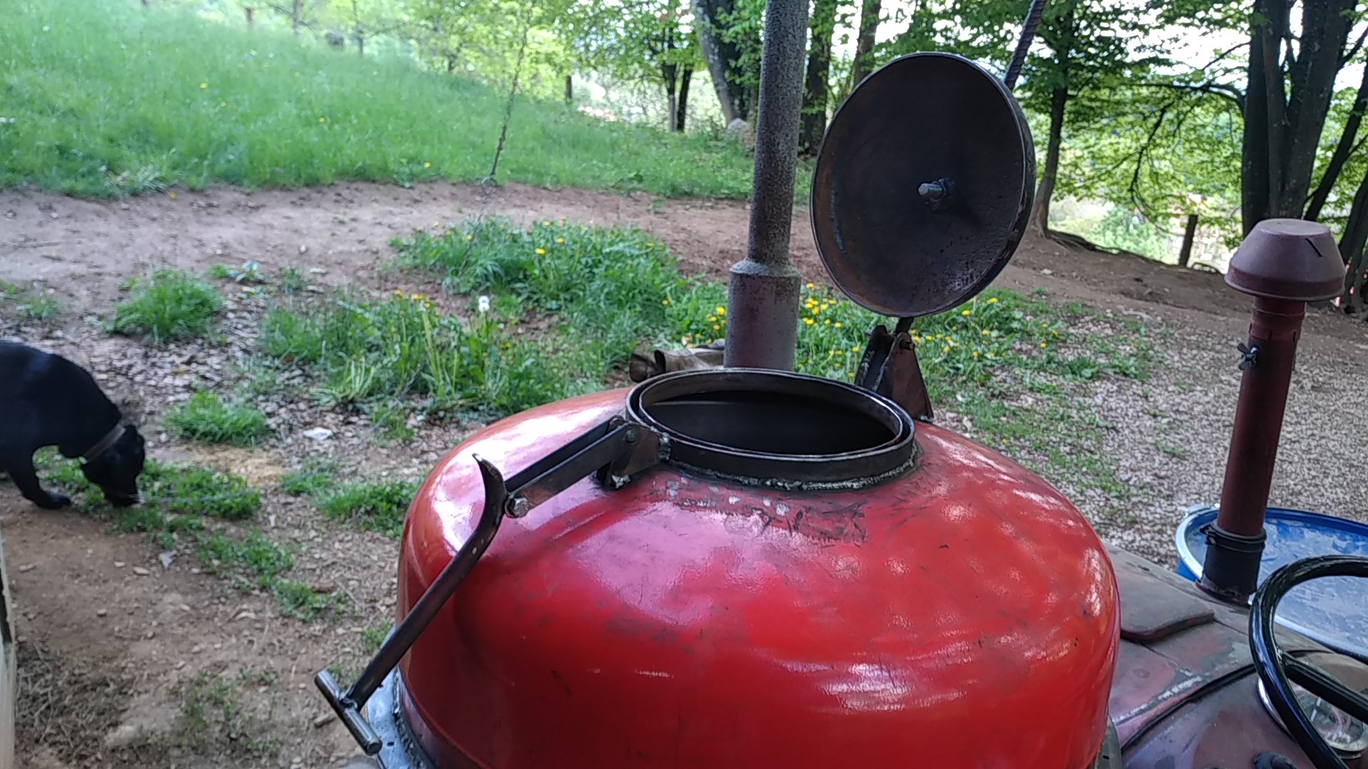

Here I am attaching pictures of some details, condensate drain, gas outlet, filling opening with lid, …
So you will have a hot hopper with a small portion on top for condensing?
I want to say they had adapter kits for Imbert gasifiers to achieve this style once they found out how useful a Monorator was.
tone, on my first gasifier i have had also the gasket on the part of the hopper, was easier because made of a car rim, and when it was not so thight i could give ash around, also in case of a not more so good gasket…and the gasifier stands normally under the roof, only outside when is used for work…but than it was not so practicable because when it was outside for some days for firewoodcutting and rain comes, it must be covered or water stands in the groove of the gasket, what cannot escape, and for a while provocates rust under the gasket, so i modified to gasket grove on the lid part…
maybee for longlife reasons of your gasifier would be helpfull you make another piece around the lid, in way that the gasket grove is protected from entering rain water…
nice work your gasifier and the hearth construction
That was my thought too when I saw it. Also it would keep junk out of the groove.

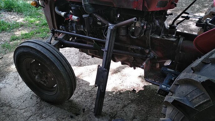

First picture, is it to touch the grate?
Looks very good, you got it in against the tractor, even though you have a whole oil barrel.
Interesting your pivot down gasifier Tone.
Yes, a lot of tractor maintenance points then easy opened up with it swung down.
Smart. Very smart.
