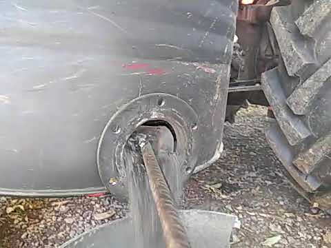

Ash cleaning ..
Looks like your reduction is effective!
Unbelievable, no charcoal at all just soot, do you run on chips or pieces of wood?
Good proof of your design goal Mr Tone.
Pure grey ash.
The wood carbons nearly 100% converted to gas and sent downstream.
More operating hours will show you what metals in your system must be readily replaceable.
Then just like your nozzle be re-designed for in service quick changing out “maintenances”.

My exact thoughts, proof of concept very well completed! But now to find the weak points that need improved. I was pondering this morning how well this would perform in a mobile high demand over the road application vs it’s current “lumbering giant” configuration. Eagly looking forward to more reports Mr Tone!

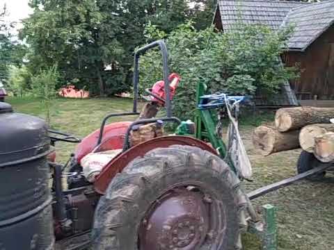

Marcus, Steve, I’m not worthy of the title “sir”, that’s enough Tone,… Jan, I feed the gasifier with wood chips from branches of various shapes and sizes,… Marcus, today it worked to drive the mulcher, tall thick grass, brush, steepness,… it was in operation for 5 hours all the time with almost full power 20-25 ks, it worked very well, the condensation in the funnel secreted some water approx. 1.5l, and in the front of the refrigerator less than 0.5l, all a little water in total, maybe 10% of the weight of the wood, the surface of the condensation zone was at a temperature of 60-70°C, the gasifier below was at a temperature of 110-120°C, the gas at the exit was approx. 90°C and at the exit from the refrigerator 35 -40°C.
Ha, that’s probably about what my gasoline Fergie will run in a full year :smile: I’m glad you’re able to make use of the tractor and gasifier.
You probably saved 30€ worth of diesel right there. If you push it to 10 hours a day you could quit your job :smile:

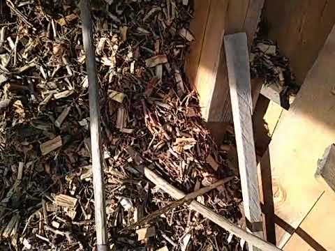

This is my fuel,.. Bob, thanks for the kind words, but as I said before, hanging out with you all was the inspiration for the gasifier, thanks.
Just by a look at your fuel I would call this more of a biomass gasifier then a wood gasifier. A few handfuls of that stuff would very quickly clog my char bed! And yours eats right through it, very impressive :+1:

Biomass means all kinds of AG waste leftovers, too.
Some EXCELLANT, like tree fruits stone-pits. Tree nut shells.
Others absolute melting gooing crap fuel in a downward fuel flow linear gasifier.
So . . . . Tones woodie-biomass TS Gasifer.
I agree with Marcus here 110% what you are burning is what is sorted out of the people who burn wood chips, Amazing. Tone just looking at what you are burning you have develop something in world of gasifcation no one has built. Only if the build can hold up to the heat in the vains that is holding up the charcoal reduction area. With your welding skill I think it will with no problems. This whole concept design is a game changer from what I can see. Chipped fuel, twigs now no problem. Just dry it out and use it.
