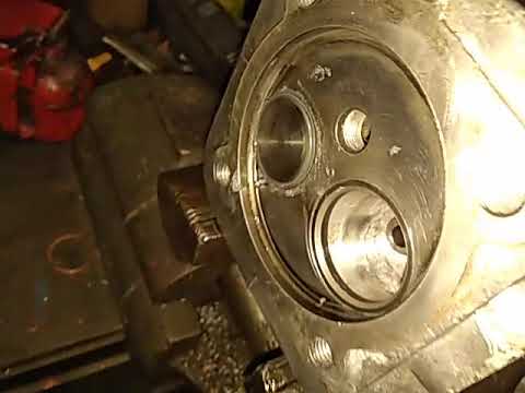

Some progress on the “tuning” of the LA 490 engine, I sanded the intake and exhaust duct a little, changed the valve guides, sanded the valve seats,
 I need to shorten the valve stems and the tube, which is actually the stem housing,

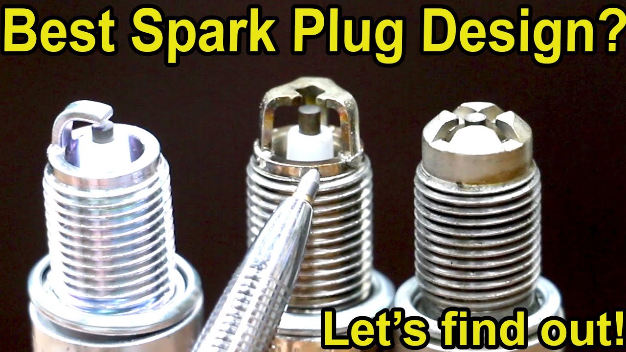

what kind of spark plug is this
it is from the yellow motorcultivator
better for future chargas application
ciao giorgio
Is the spark plug made by Autolite?
I have one similar to this.
The idea is to have more sparks for even burn.
Yeah makes sence
 but l have yet to be proven that that actualy works. Electricity takes the path of least resestance and all pegs will never be the exact same distance
I have a slightly different one, where the legs are cast or sintered into the body of the plug. Mine only has 3 legs as well and you’re apparently supposed to gap it to have the open side facing the exhaust valve(s).
I consider it more of a spark redundancy. There’s been a few tests on them on YouTube.
I have one in the hot built Honda Clone for the motorbike project.
the spark plug is from ngk japan
interesting film cody

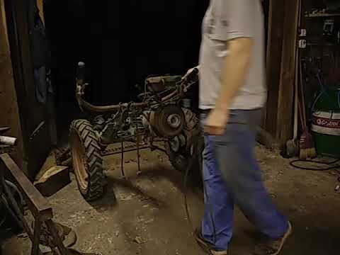

 the machine is ready, the compression is like on a diesel engine, but the power
 abnormal
Fantastic :smiley: what do you fuel it? High octane?
It sounds like a ww1 propeller airplane.
Tone we need to buy a new camera and microphone for you! I’d like to hear how these engines really sound.
Yeah, compression is so high it sounds like a diesel!
And I have seen how strong your arms are,the poor little Lombardini doesnt give up :smile: :smile:
