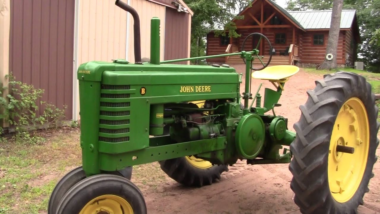

There were some American one cylinder tractors. I don’t remember ever seeing one. Maybe at the old engine shows and I didn’t know what I was looking at. Had a friend who restored a John Deere B. Looked like brand new. He just took it to shows. No work. Video of starting one.
