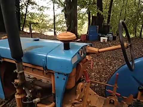

Giorgio, I’m a little ashamed to perform in front of an audience, but here’s a cold tractor start. I tried to show the mechanism on the magnetic ignition, which enables a good spark for ignition, despite the slow engine turning, I lower the cold start flap on the carburetor, otherwise the closing lever is missing, I check the fuel level in the carburetor and start the engine with my foot.
Good video Tone.
You show the magneto impulse-coupling well. Many small engines “Easy-start” use a spring-loading then releasing, fast-spin system for starting now also.
Your tractor she like her choke enrichment, yes.
I see you are growing back your winter hairy bear-look again.
Best Regards
Steve , Steve , ha ,ha , you wrote well,… hairy bearish appearance ![]()
Can that starter kick back? I never owned a motorcycle with an electric starter. Back then it was considered sissy. Many times I just about got a broken leg and at least a heavy shot of pain from that kick back. Now I think about how stupid that was when all I had to do was get one with a button to push.
thanks tone for the nice video!!! and showing the mechanism…smart to start with the leg…better for the back …really nice engine…

tom. my honda cb 250 , in my youth time, i had always kicked by foot, though having a electric starter…never kicks back, there was a mechanism what allowed to push only in one direction…the tractor would have the same…?
