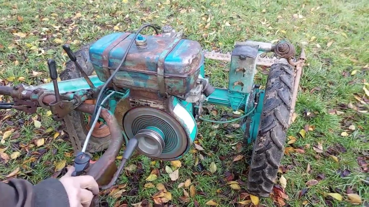

I brought some gifts for the rest of you guys too, made a few videos :wink: hope my camera caught the sound a bit better this time. Still, the sound of the mower engine is impossible to comprehand from a video. Its mean, its agresive, touch the throtle too much and it goes crazy. Imagine Mike Tyson in his best years snorted a foot long line of coke and then did one line of chilli powder. Thats what this engine behaves like :smile:

That mower sounds like my race engine I have for a motorized bicycle! Is it around 200-300cc?
Also the diesel sounds amazing. Very healthy engines.
Exactly. Ha, its a 490ccm. Ment for kerosene originaly, hence the super low compression ratio. Tone fixed that problem :smile:
