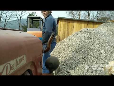

In the next thread I mentioned the video about the shutdown, I increased the playback speed 10x, 15 minutes after the shutdown, flammable gas is still coming out, which even the wind does not extinguish, this is the cleanest and most calorific gas that I can produce, because it is produced without adding air, the air supply is completely closed. Even during operation, very little air enters the gasifier when it is heated to the working temperature, because due to the hot reservoir there is a large expansion of gases in the upper part.
“He was working so well, but you tore him apart, you crazy head”. Such and similar thoughts are intertwining in my brain, well, some effort and time must be invested to convert Fergi to 100% wood gas. “Crowd in front of the goal”, that’s how I could call the thicket of pipes, at the part where I would like to install the glow plugs and then the spark plugs. I moved the oil filter lower, I have to make the exhaust manifold differently, slightly modify the pipes from the fuel pump to the injection nozzles,… :grimacing::roll_eyes:
