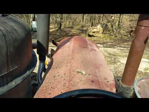

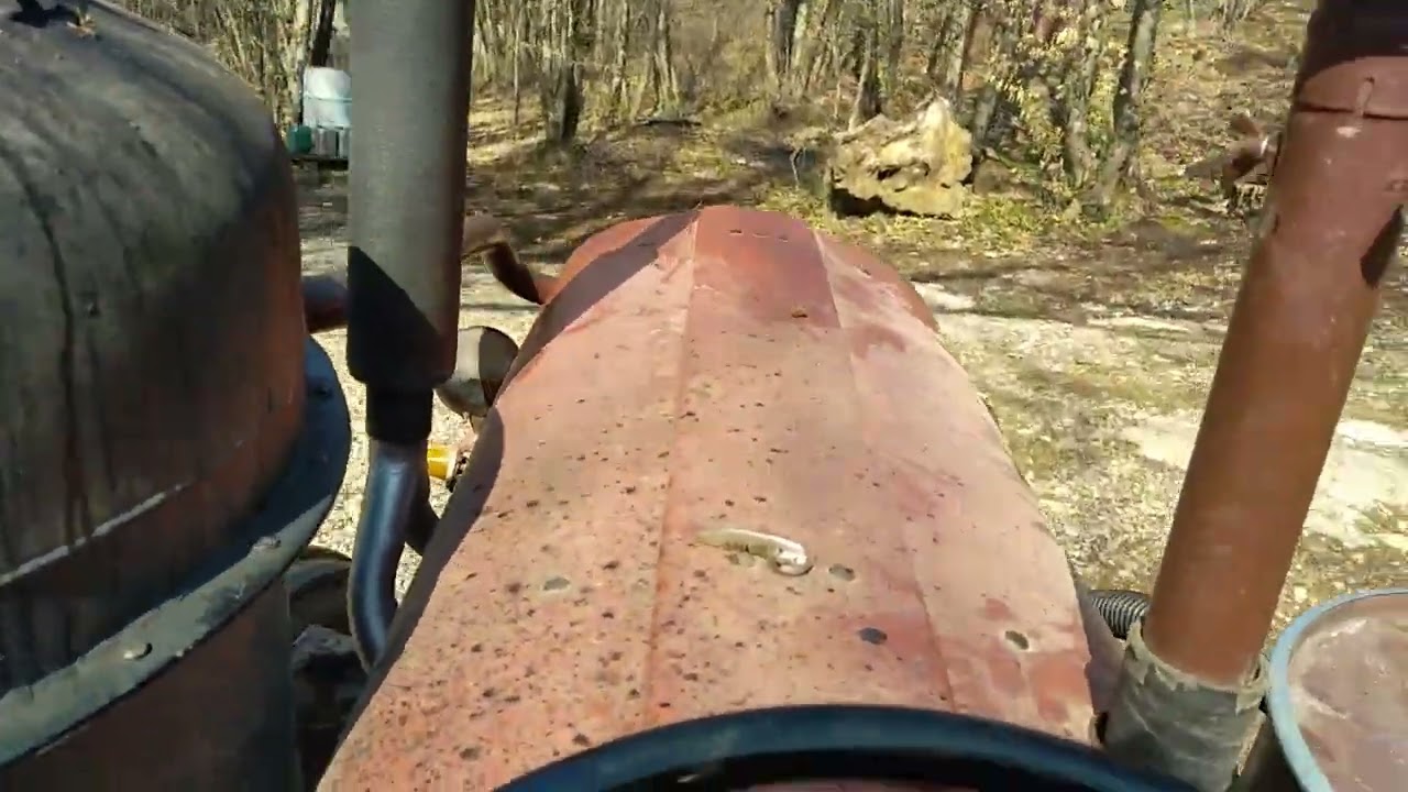

Some progress on remaking Fergi, so I’m not just making jokes at someone else’s expense
