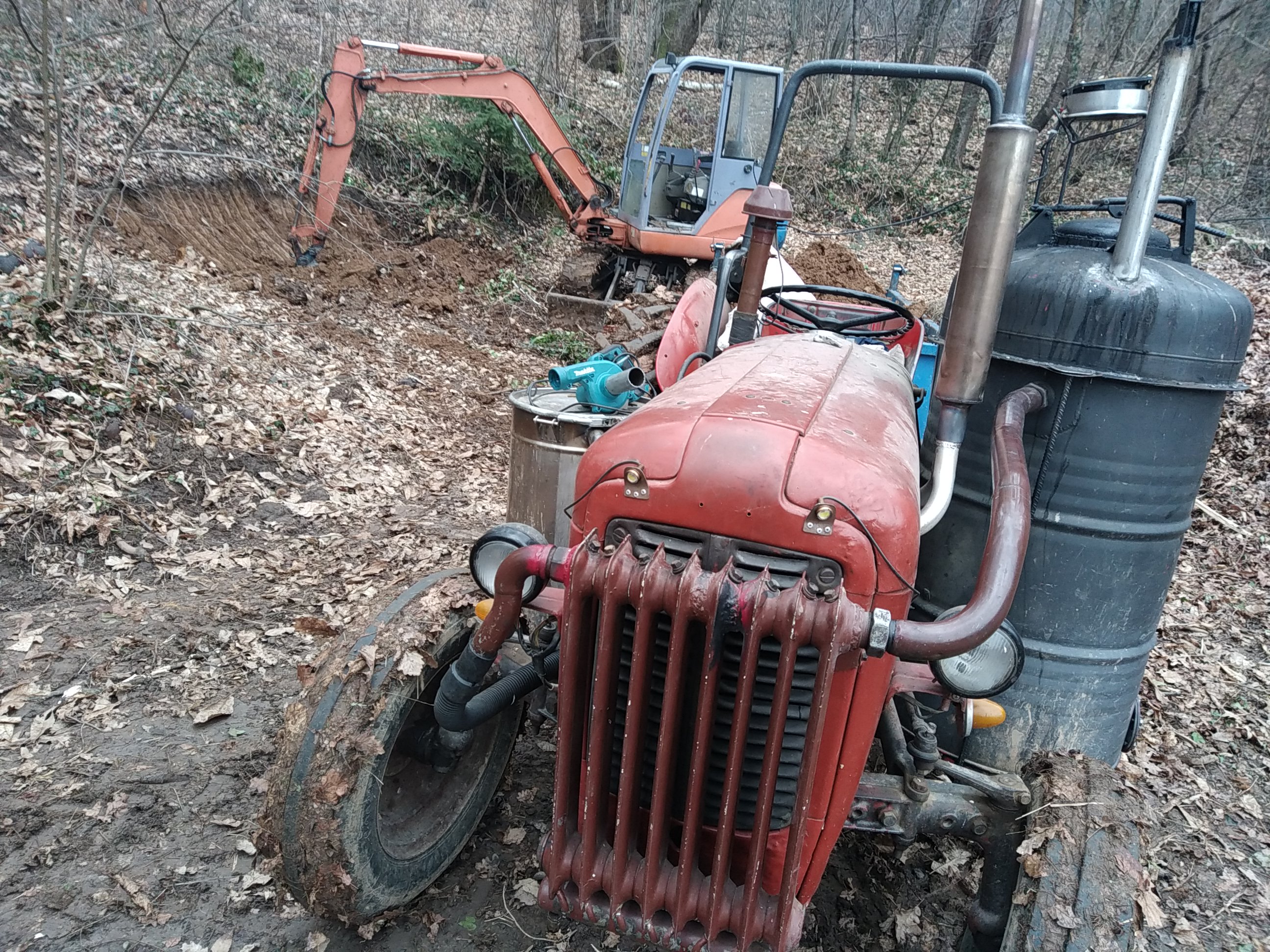

The winter afternoon is short, but there are still a few hours to work. I clear and level the rocky terrain, haul away rocks and bring in soil, Fergie runs at low revs, then at full power, an unfavorable situation for a wood gas engine, but it tolerates it quite well.

I invested 60 Euros in a 12V electric blower to start the gasifier, I will report shortly how it works.
Tone, a rough calculation tells me the poor Fergie has to do 10 hours of work to pay for its new blower :sweat: :smile:
I connected the Makita to a ā€œclassicā€ battery, but it didn’t seem to be working, so I removed the load switch with unnecessary electronics, I already have a switch and a cable for a circulating blower at Fergi, well, with the Makita directly connected to 12V it works well, it has good air flow and pressure, but it needs 240W of power.
JO, your math is pretty accurate, but these are the ā€œvictimsā€ of the ā€œgreen transitionā€. If I were to take into account all the other costs incurred in the ā€œgas tractorā€ project and my working hours in this calculation…
He has now completed 420 working hours, which according to your estimate of consumption of 3.7l/hour, which is quite realistic, would amount to 2500 Euros, yes, if I remove my working hours from the calculation, Fergie has paid off his purchase price, the costs of engine renovation, new tires, the costs of the gasifier and other equipment, he deserves a new blower! :grinning::grinning::+1:
I installed the blower on the tractor and tested it, it really has a lot of power, the gasifier heats up faster, well, I had to add an elbow to the air intake, on which I install the blower,… 2 hours of work,… 20% of the invested cost has already been paid off. :grinning::smiley:
