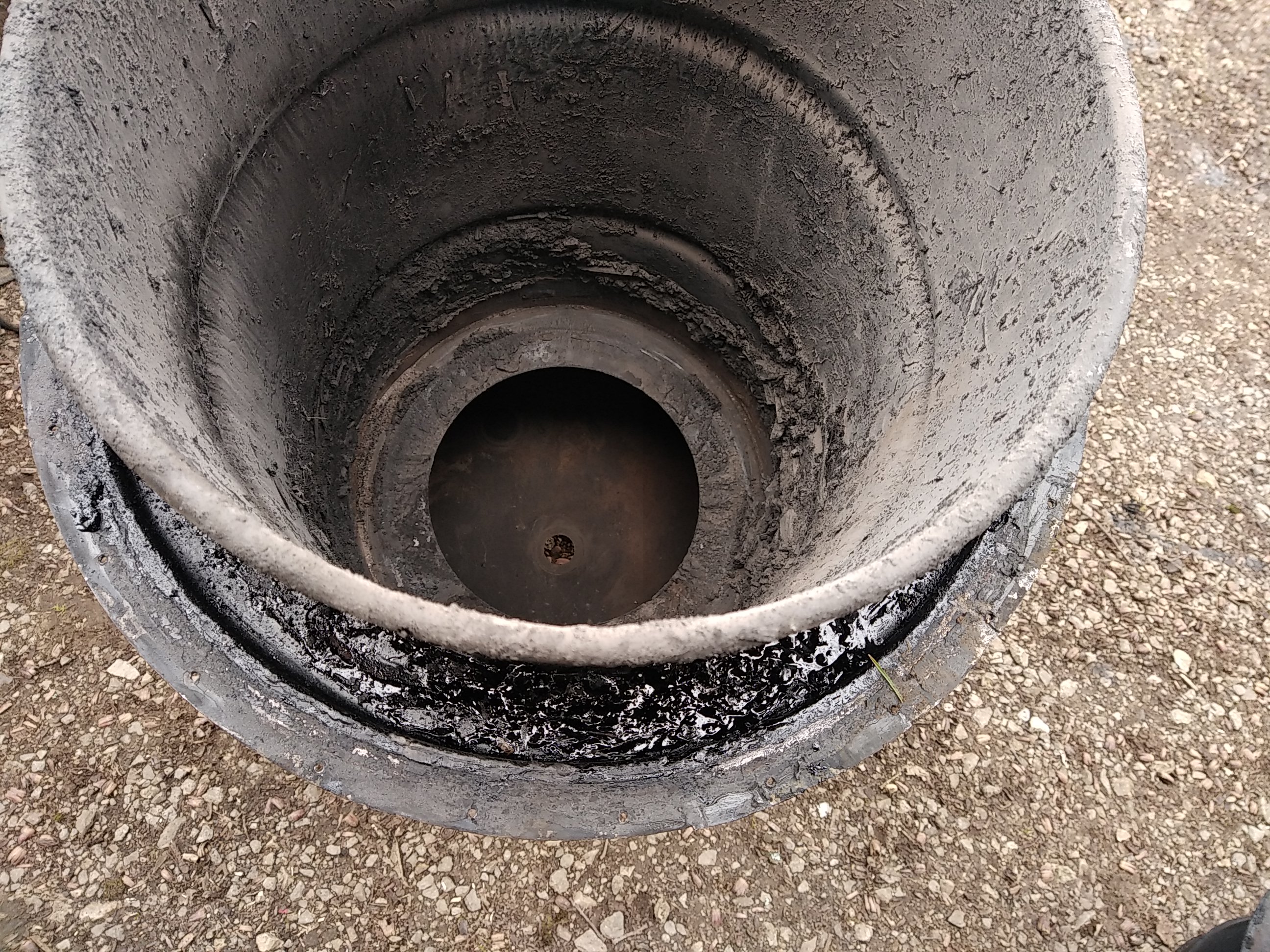

Kristjan, above in the second picture is the oil filter, where traces of oil can be seen, I can say that the oil was a bit dark, but still quite good, you can easily wipe your hands dirty with this oil with a cloth, and they are clean, but if you get them dirty with diesel engine oil, you have to use a strong detergent, and they are still black.

Do I see a drain in the bottom of your stainless container? Also, did your steel barrel rust out and did it have any sort of coating inside to inhibit rust?
The old barrel is made of really thin metal without any special protection, but that’s not the biggest problem, but the bottom is constantly moving, the gravity of the filter media pushes it down, and the vacuum pushes it up, so cracks appear in certain parts. This new barrel is much more compact.

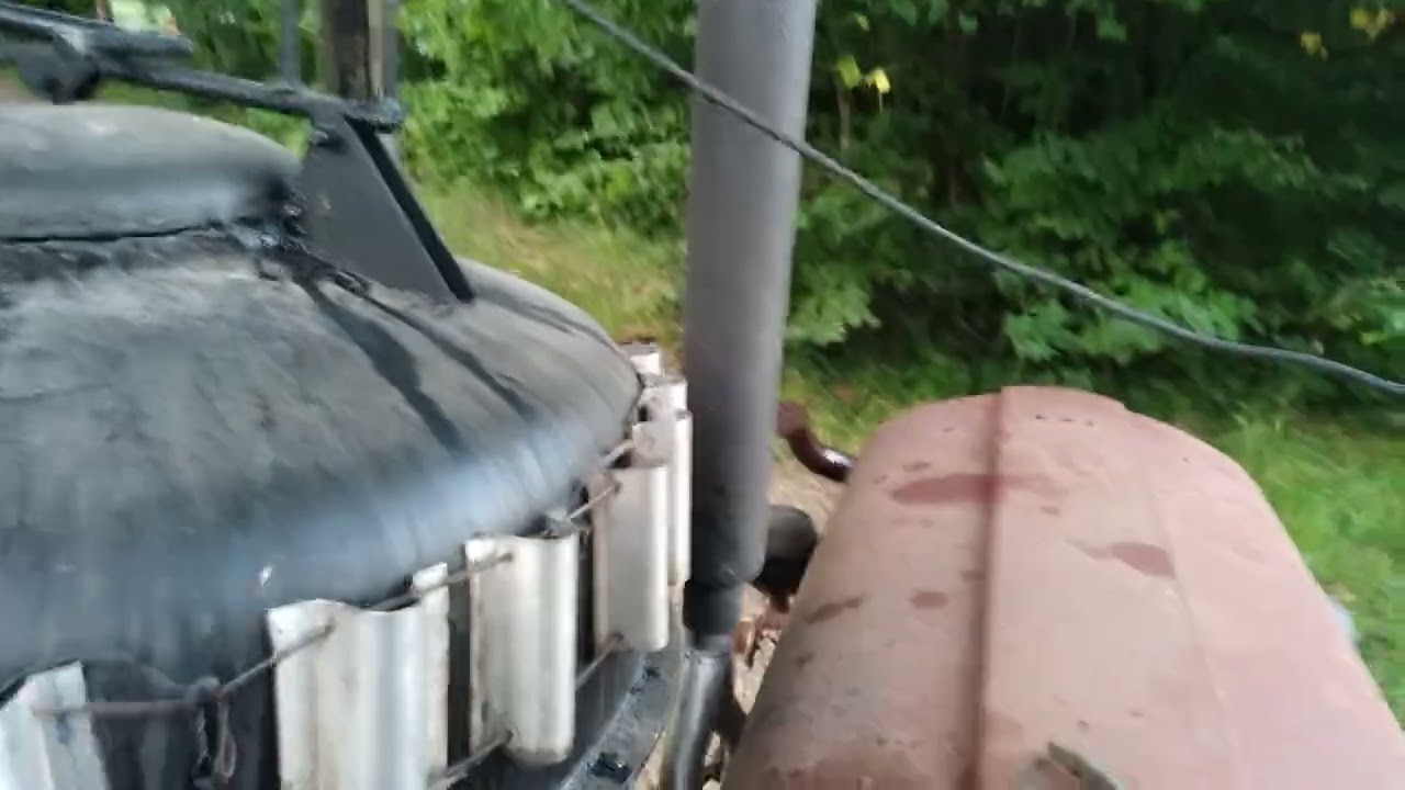

Looks like a glass pack resonator we used to make our cars purr like kittens.
fergie and the gasifier are a really masterpiece, so a stainless muffler is the minimum you can do to the tractor… also a genuine leather seat cussin would be nice, and…and …and…
I love yhe old oil heater as an cooler
