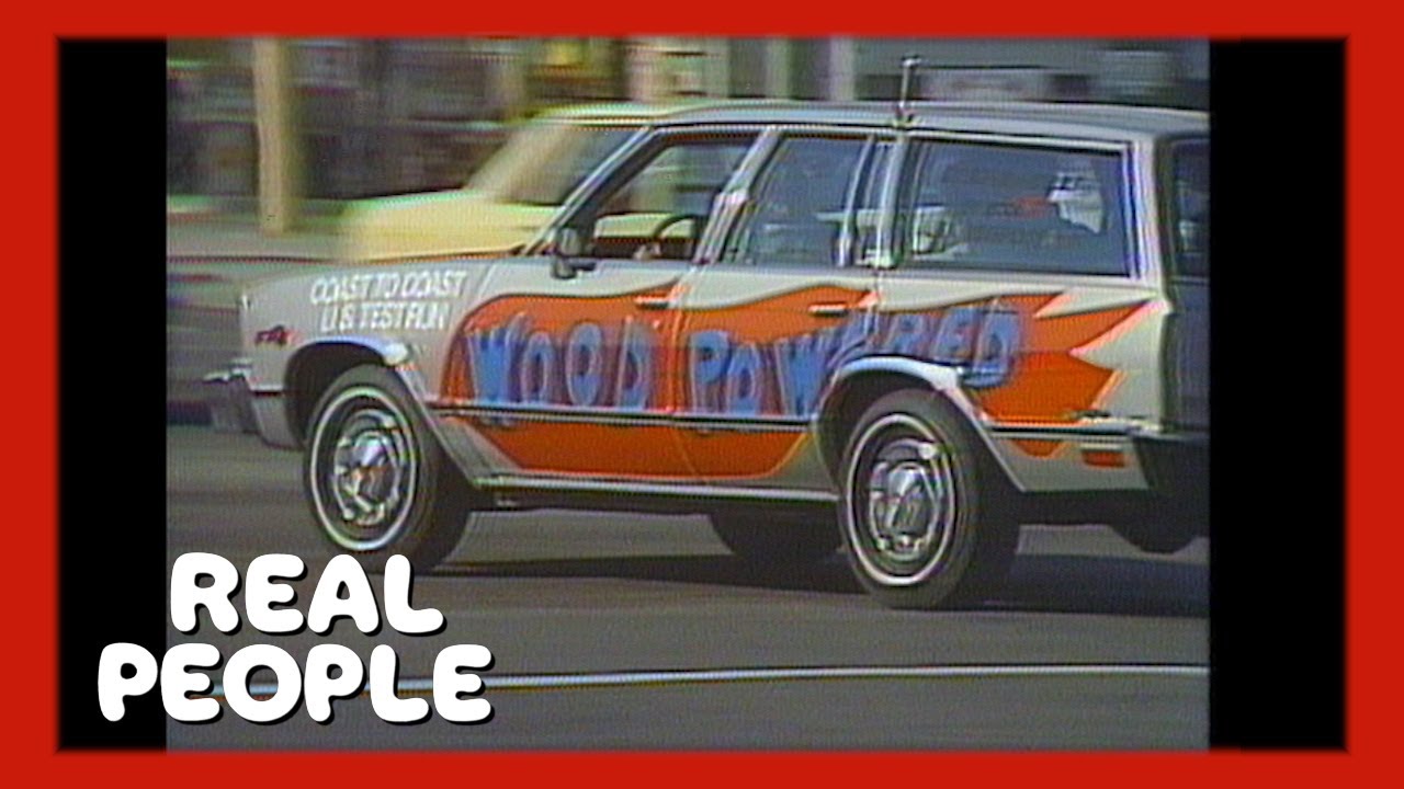

Thanks Kevin for the video! This is the first time I have see this report of the four men from Alabama that went Coast to coast on wood. The fuel price was only 84 cents a gallon. You could drive for 10 cents a mile on petroleum fuel vs. Less than 1 cent a mile on wood gas. And they did in a station wagon. No carburetor, it was removed?
That is was the news report said. I never heard about this on the TV news durning the gas shortages in the 70âs. Oil companies must of suppressed it up north. Thanks for sharing this. And then came another Alabama man named Wayne Keith coast to coast and back home again. DOW. Up next one more Alabama man Jakob North, he will be the youngest to go coast to coast East to West and South border to North Canadian border. Yup there must be something in the water, and I want to drink some of that water at Argos. Please bring us some of that water from Alabama. Good old DOW Alabama water for us Northerners to drink.

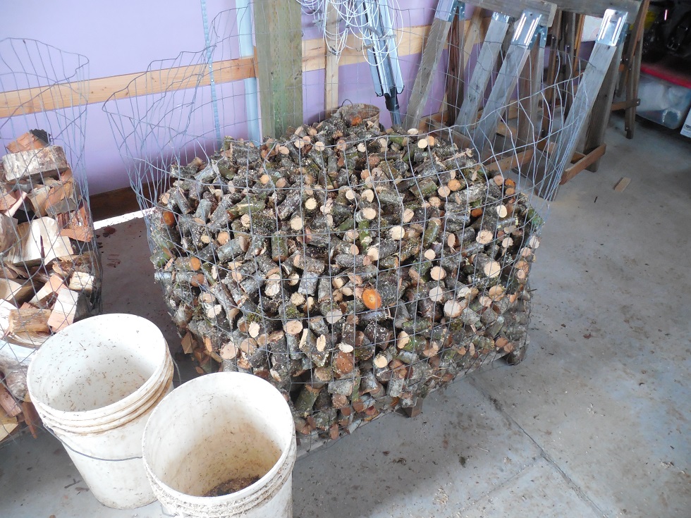

This is the first 18 buckets. I built a drying setup, but have not tested it yet. The weather has been crappy here, and the baby has been fussy. Both conspire to make it hard to get work done.

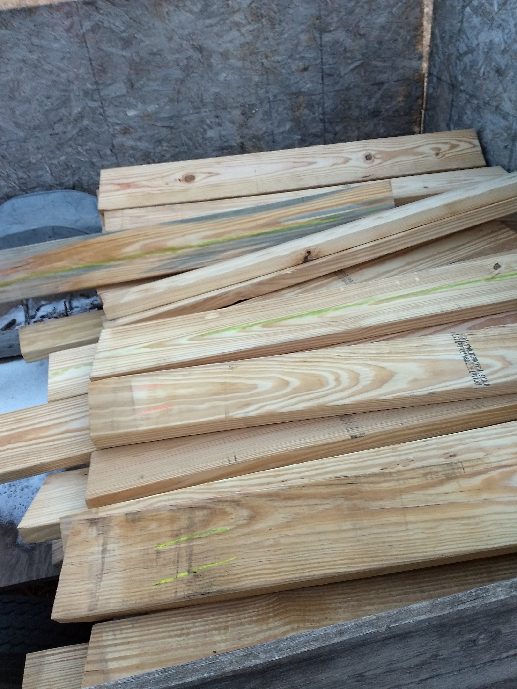

This is the wood I will be chunking for you it is a dense pine grade 2400 with some 2700. It is already cleared for interstate shipping if not international. I have about 1100 lbs now will see if more becomes available. I can fill the gap to 1500 lbs with local wood which will be used up before you reach Wyoming or Colorado saving the denser stuff for the wide open spaces. Will post pictures of chunks later so we can get that dialed in
