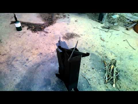

The project is a gasifier cook top. I think Koen is doing something similar to this with a charcoal unit. I attempted something like this last year in a single unit. It worked ok and build cost is why it was abandoned. So this time around Im building a smaller unit to run on stored compressed air. So “no” electricity input will be needed. Depending on how successful this is, I will experiment with higher pressure tanks and use the PCP air rifle pumps for filling it; to extend run times.This time the gasifier is separate from the cooktop and may become a product by itself. It will take the Micro Badging and the current versions will get re named the Utility Series. Then the cook top may be offered on other systems as well. Additionally Ive been wanting to tinker with a rocket stove, so we are going to build one of those for the same purpose of an outdoor cooktop unit.
From CAD to reality and tested. The Rocket Stove are really cool, and they are basically a wood gasifier too.
Matt, you should have no problem selling those. That would be perfect for helping to cure my refractory castings, plus so many other things.
A rocket stove for sale made out of something else then tin cans or cinder blocks… and not an open toed shoe in sight anywhere! Sure looks pretty Matt.
Ok going to build version #2, Im adding a door to the back side for char build up removal. I didn’t like the T handle bolts as the bottom was getting a bit hot to handle. So Im going to the style that is on the tent stove we build. It will come with a poker with a hook bent into it to open those latches. I had a couple comments on the stand, although it is very stable in the current configuration; I changed this to widen the stance. They are now removable as well.
Tomorrow we will have the other version with the tiny micro. Ive made changes to it to give it more height and made revisions so it can work just like this other rocket stove with natural aspiration. A restrictor plate can be installed along with jetting for the forced air mode. Hope to be able to fire that one up by the end of the day.
Well I built the other one and did it work? Absolutely not!! haha
The little gasifier worked just fine, it did what it supposed to and that was to make gas. But getting it to naturally draft just isnt gonna happen. This is majorly detuned in this attempt to try to get it to do that, but its a no go. But it is a neat little gasifier, Im going to keep experimenting with it and I have a plan to build a simple platform for and a small filter system. Im thinking of putting this on my pick up for mileage booster, it will be interesting to see how it goes running pellets and what kind of mileage I might save.
So not all is lost, Im going to take the tower from this and use on the next rocket stove build.
