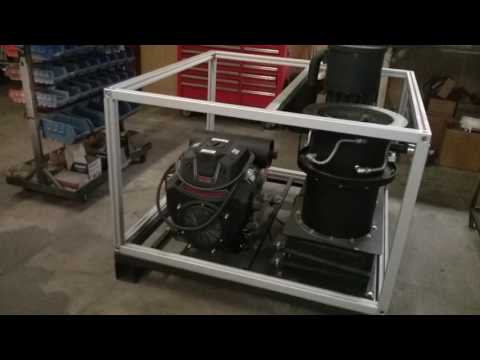

Gears are turning on the new Utility design. I think we are going to outfit this with a small auger feed system. I think this is gonna be our most practical cost effective solution will be able to offer. Its sized large enough to be able to do real work with and yet cost for the base unit is under $2000.00 bucks.The wheels will make it practical to move around and it is light enough for just the two wheeled dolly system. This combined with a simple auger feed with its small size will be quite practical to operate. I think this is going to be a pretty neat little machine with all the bells and whistles.
Here are the first chassis we have built
