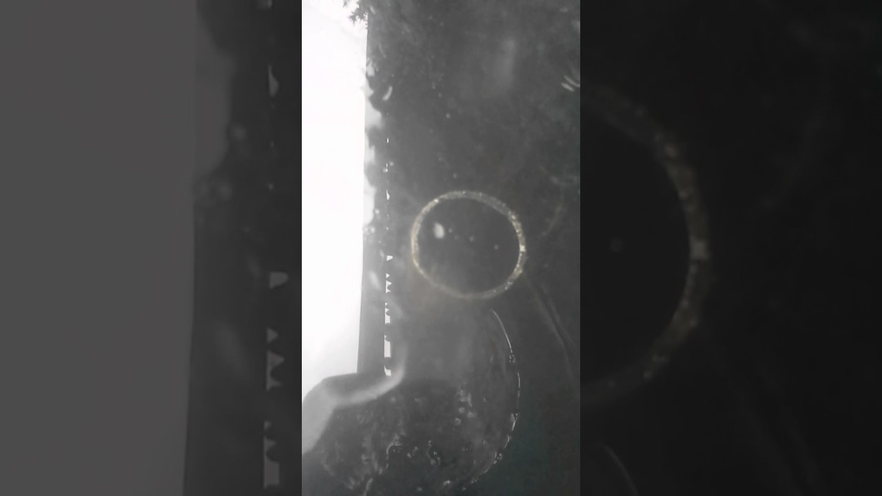

It was a rainy day today so l decided to go ahead with the scrubber.
Here it is!
And in action (engine running on petrol, a peace of glass instead of the hayfilter lid)
As you can see, it works! Pulls lots of aspirated water on top.
The drive was great. The venturi choke doesent seem to effect the pressure drop too much. I started with a 22mm choke, l think l wuld get by with a 20mm.
The water was indeed black after a short drive, but its too soon to say anything about efficiancy.

Ok this is the sistem l currently have installed. So far, it all looks good. I abandoned the secondayry bubbler, too much pressure drop.
Now, the water has much less movement in the water pool. This means soot can settle down on the bottom over night, then not get disturbed at operation. Yesterday l took a look in and saw about 3mm thick sediment of fine soot on the bottom.
This scrubber allso seems to do a good job at demoisturiseing the gas. Kind of funny, drying the gas with water :wink:
l drain the water out of the cooler each day, yet still find a lot more water in the scrubber thain l put in.
ps. there is allso a thin film of tarry compounds on the surface of the water. It does catch tar, but to what extent is hard to say.

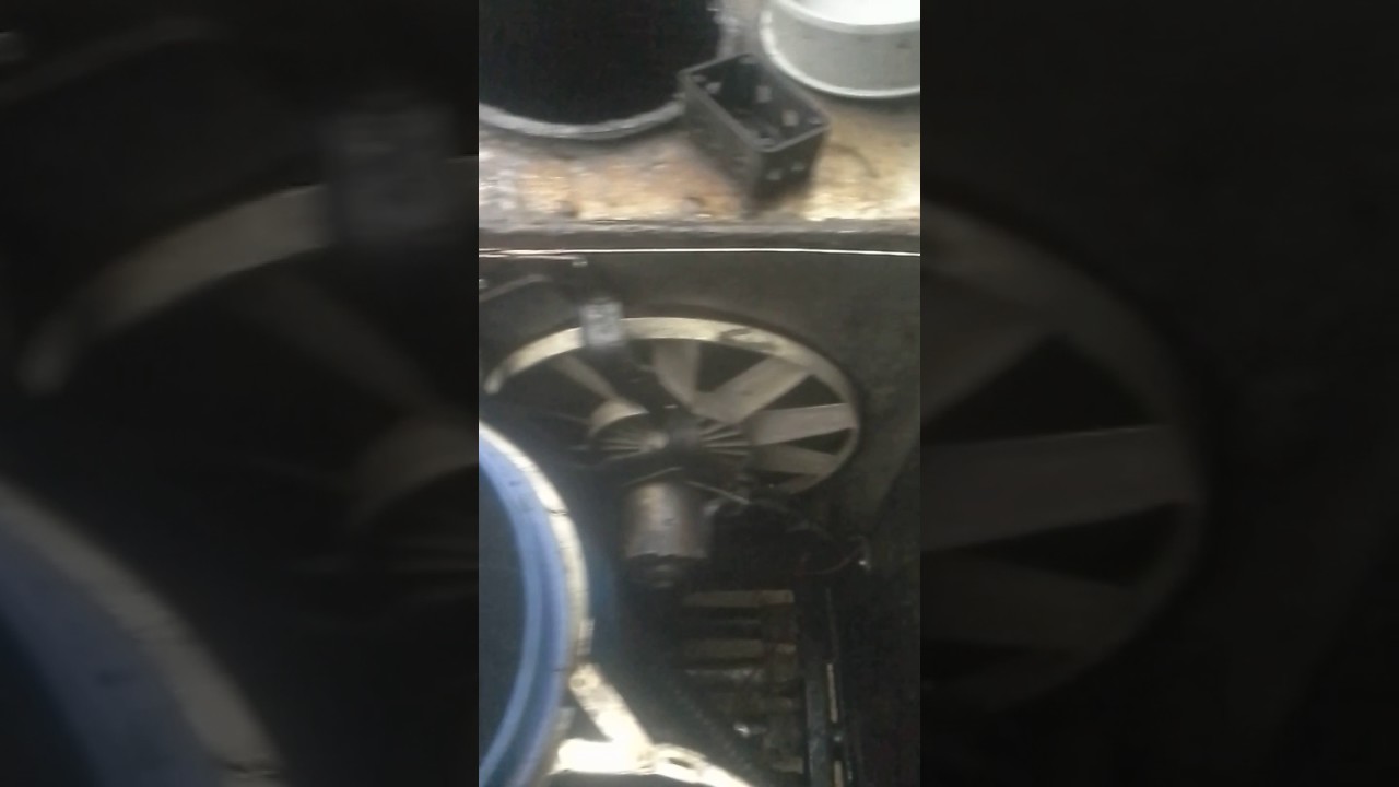

Culd you describe your sistem a litle bit? Perhaps a picture or two?
Hello KristijanL.
Go here and click on the picture with the green generator set in the center:
