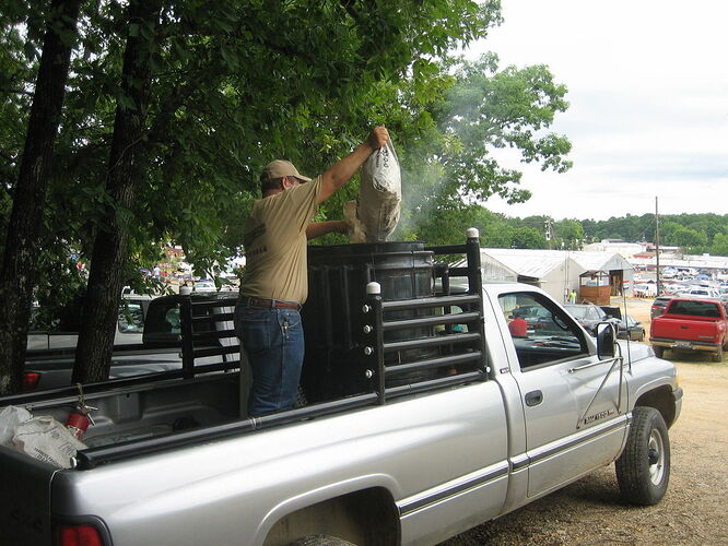

The family and I took a quick trip to the flea market this morning . Plenty of people around but no one noticed we were different . A few folks walked by while the son was refueling but had no interest. They may have thought we were part of the roasted peanut selling group that was at the market that also had similar looking equipment on there trucks and trailers.
The first video shows starting up after a three hour shut down . The truck reaches power in about a minute .( no blowers just motor pull to the gasifier )
The second video shows my son SWEM.

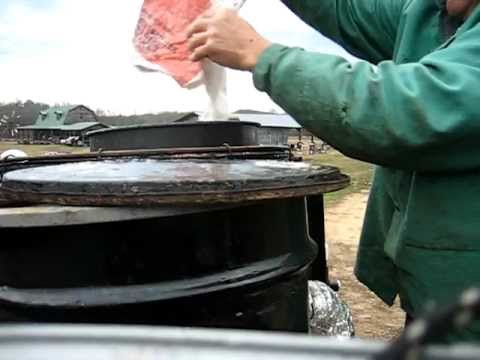

How long can you go before you have have to relight it? Can you just feel the side to tell it’s hot enough?
Morning Bill,
After the trucks have sit for 4-5 hours it could be iffy for them to fire back up without a relight . Depends on a lot of factors of how dense the char bed is , type of wood and moisture content etc. A few times I have had the fire to last over night but the general rule is 3-4 hours.
The above video was with 100% pine and I knew we had fire because of just a little smoke from the hopper when refueling. If we had seen no smoke when refueling I would have turned the reverse blowers on for a few seconds . If still no smoke I would relight .
On that particular refuel, with a little smoke, do you feel there is a danger of a flash out the open filler lid? After being flashed once, I tend to exercise to blowers no matter what.
Hello brother Carl,
I think it is wise to air on the cautious side however I may be getting a little slack on judgement sometime . When I break the seal on the lid and lift it I always hold the lid as a shield in case of a flash . It has been a long time that I have had a hopper flash and usually it is a slow burn and most of the time one can get out of it way. .
