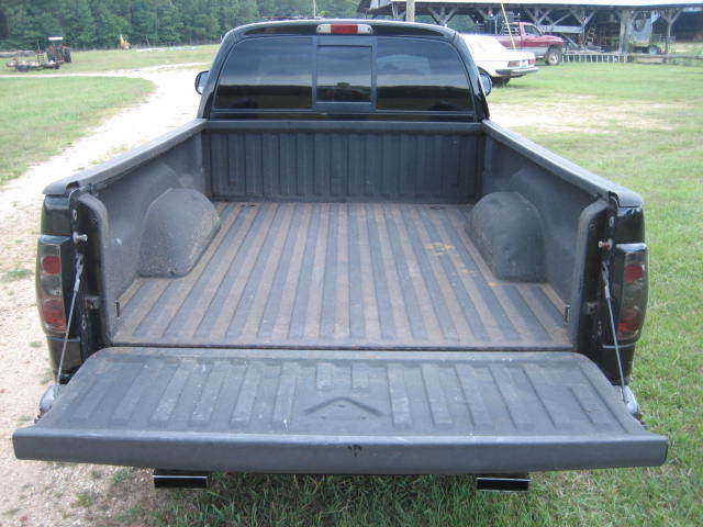

I have a new toy .
I think it would look good smoking

That is a perfect candidate. A little too perfect. Good luck my friend, this will be epic!
Wow dual exhaust, 360 ci, black and beautiful! That is a very nice truck!
More power to you Wayne! Are you going to do anything different on this one?
Wow Wayne that sure looks like a nice one. I bet she will really scoot. You will probably have this one done before me too. Seems the more I do the farther from done I get. I am down to a bare frame now , bottom side getting slathered in paint. No part of it will ever have a shine like yours, very nice.

I have been looking for a long time . This is a city truck , I found it down town Atlanta by the air port .

It does feel very torquie Anyone that has driven the dakotas with the 318 on gasoline already understands they have too much power. The 360 has even more torque .

I am not sure the later model truck will even run from wood gas but I guess I will learn soon
By chance does this one have a after market computer on it?

There are a couple of stickers on the computer that reads " rebuilt by an independent re-builder "

I weighed the dakota this morning before any cutting or welding or modifications .
4105 pounds including spare tire .
Ha! Ha! Well Mr Wayne just figure on doing an intake manifold take-off-check-and-reseal-the-baseplate to get access to do your ignition distributor modifications!
This was a part-capable transition to full OBDll model having still an ignition distributor.
Should still be doable for you.
If every there; engine/trans parts swapping watch out for a different flex/flywheel tone wheel to allow for mandated OBDII individual cylinder mis-fire identification. And this on top of 318/360 flex/flywheel parts different for counter-weigting.
Check your front ball joints for wear/play on these as the early production chassis had a problem.

Now that you’ve bought the 500 pound heavier “pretty”, you be working harder to make it Do-on-wood.
I have all confidence you’ll getter’done WayneK.
