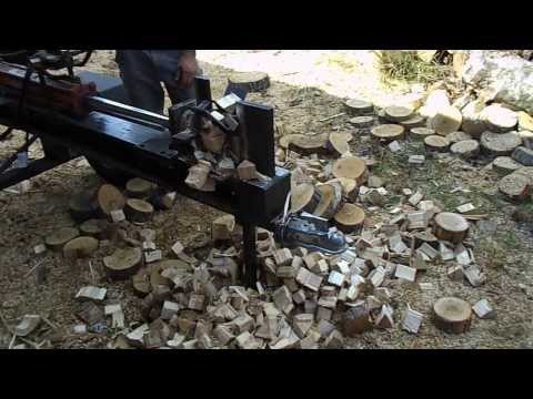

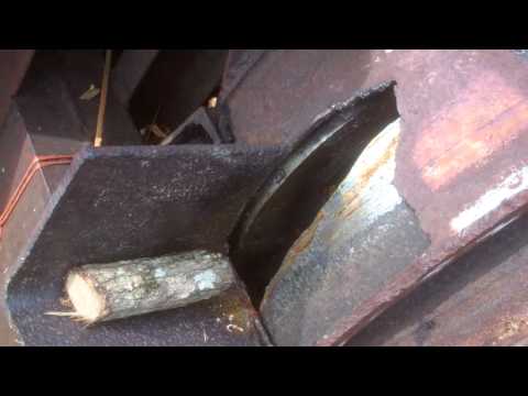

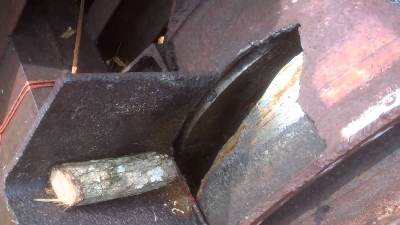

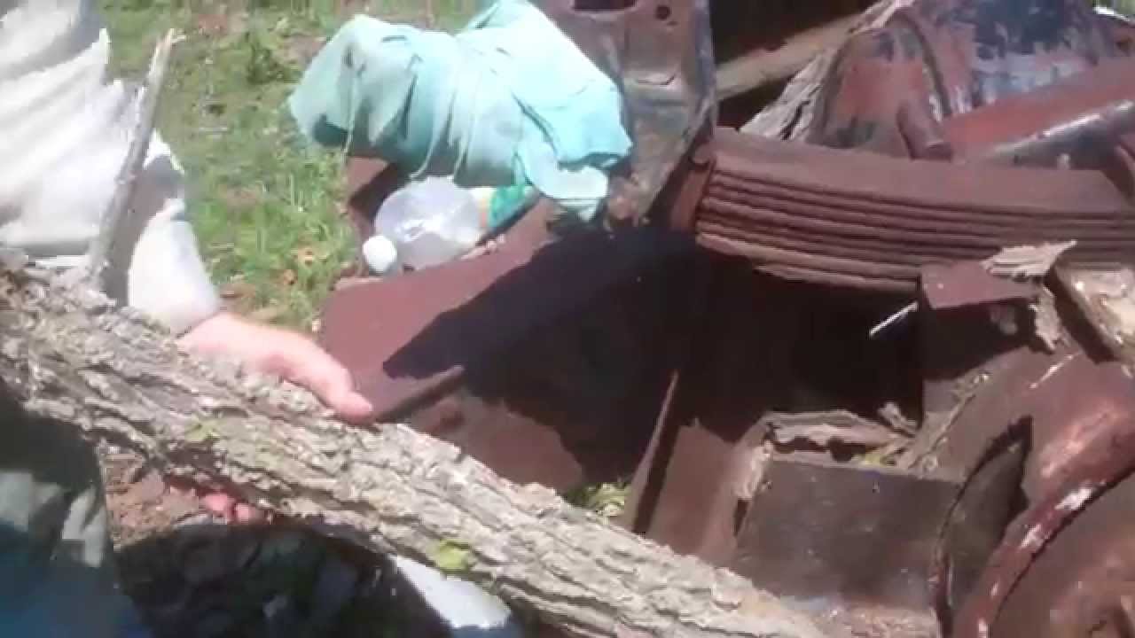

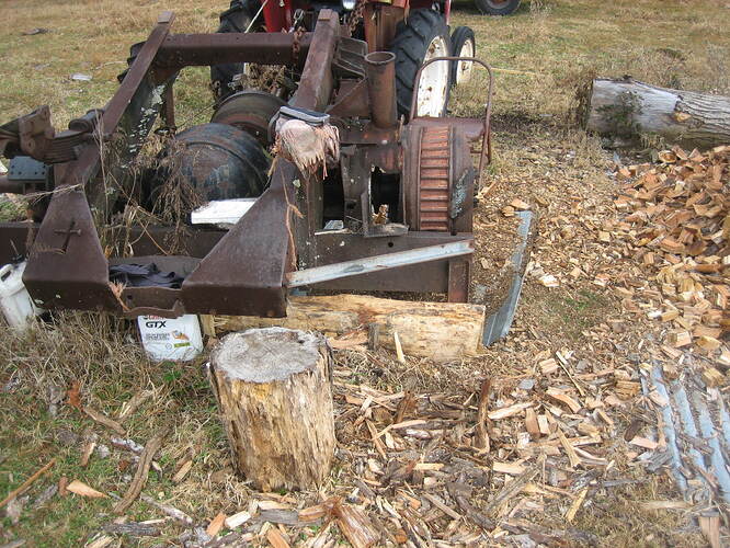

Update on the ole chunker .
This petucular slab was about 40 pounds.
Chunking short wood.
Powering the wood chunker with wood .
A few details of the chunker and trying to estimate how much wood we have run through it. Just a wild guess I thinking near a hundred ton over the years .

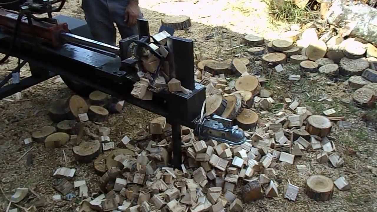

hi wayne I was wondering if you can recall any problems with the splitter head nathan puffer had made I stumbled on one of his videos looked like a good way to chunk cookies . I would like to be able to chunk whole trees branches with the dozer cookies with something like nathans or herbs set up . thanks paul

This may be the video you were referring to .
I haven’ heard from Nathan in a while but it looks like his splitter is doing good.

I’m not sure of the capacity of the chunker axle. It was from an International road tractor , single axle , six cylinder gas , and about mid sixty on the year .

that’s the one wayne thanks just didn’t know if you heard anything bad I couldn’t find anything on his post .

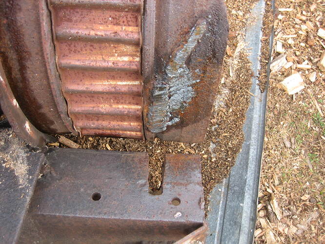

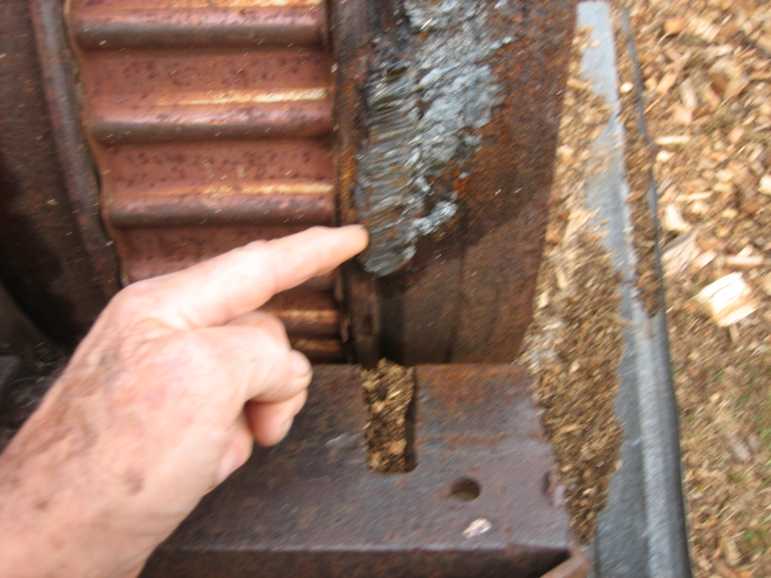

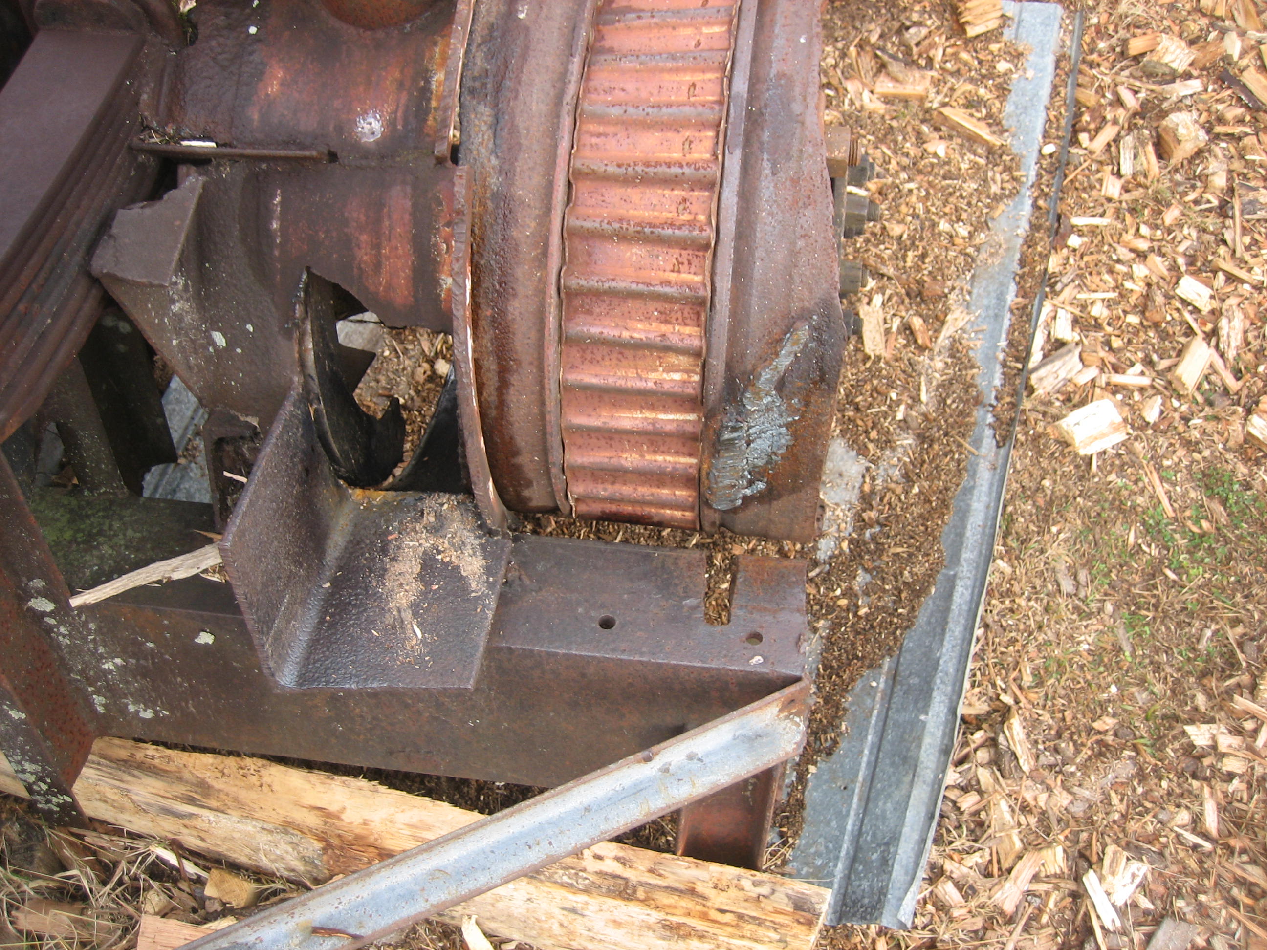

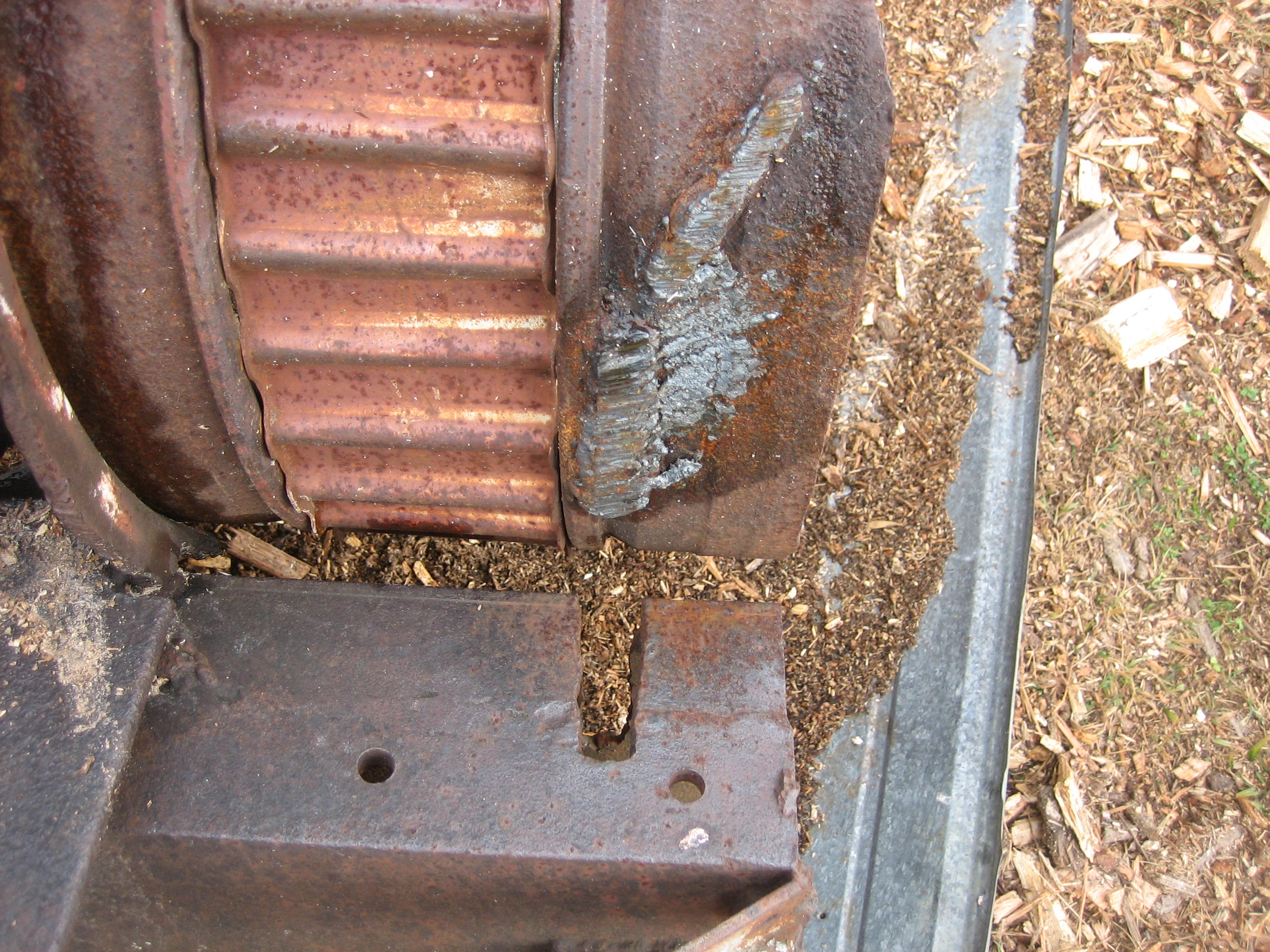

Hey Wayne could you post a picture of the splitter you added on the right side? Can’t get a good look at it in the videos
Hello Marcus
See if you can make heads and tails of this .
Perfectly what I needed Wayne, thank you very much!
