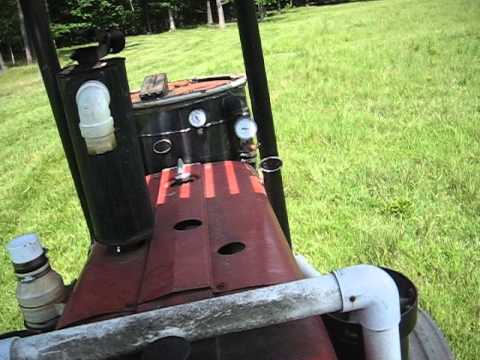

I am using the 444 tractor daily with hay harvest however I did set the gasifier off just last week. It is bolted to the tractor with 6 bolts and easy to attach .
Right now the tractor main job is working in the hay and I am always in a big rush .
Also there is a carburetor issue I need to address. The carb is an updraft and has a very small venture about the size of your little finger . With just a little carbon build up here cause breathing problems and power loss. The carb has to be taken off and cleaned because I can not burn the intake out as I do on the fuel injected trucks.
I have some bigger carbs I plan on modifying to put on the tractor but just haven’t had the time yet .

When I gasified the tractor I gave bringing in the WG above the carb a lot of thought but the details got very tricky . On a tractor a manual throttle just doesn’t work out . It has to be throttled from a governor and hooking up the carb plus the WG butterfly gets complicated.
I have some big updraft carb I could use with some modification of the governor linkage but it may be a while before I get to it . Most of the work around the farm I need my tractor with the frontend loader and the rear hydraulics . When I use the IH it may be 5 min here and 10 min there not long enough to justify firing it up. It’s main job is in the hay field fluffing and raking hay . Most of the time while in the hay it is operated by someone other than me and I am not comfortable with it in knee deep bone dry hay

I might have missed it, but cant seem to find in either this or the other thread what you use for a filter on this tractor. It seems small and compact.
Thank you!
Good morning Kristijan ,
I used a well sealed military canister . I don’t know the original use
. I found them at a local flea market .
Thank you so much for the pictures!
And you just put hay in? I imagine you rinse it more often thain the big ones?
Seems wery simple!
Hello Kristijan
You can go here and find all the details. Drawings, pictures and videos .
http://forum.driveonwood.com/t/waynes-international-gasifier-build-thread/1209
There is a canister on the left side of the tractor that serves as the condensate tank. It is post cooler rails and severs same as the tank I use under the trucks at the rear of the bed. .
The gas travels from the condensate can over to the right hand side of the tractor where the canister is filled with hay .
No more rinsing of the hay than the bigger filters on the trucks . The tractor uses much less gas than the V-10 or V-8 .
