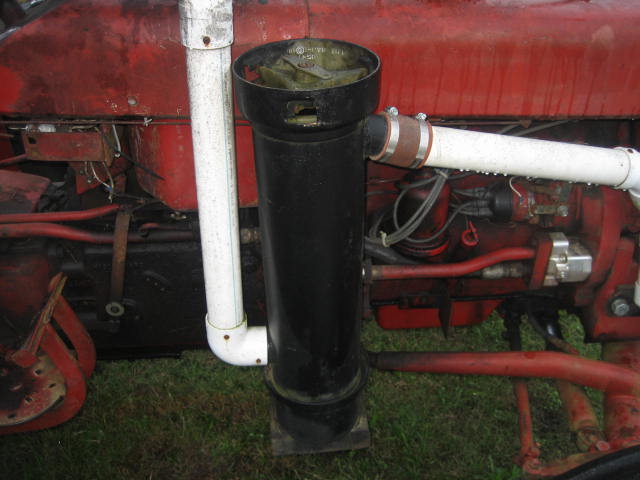

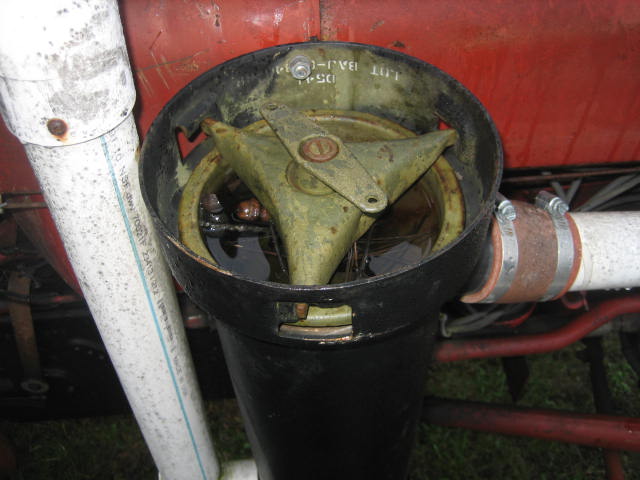

Hi Mr Wayne,
I might have missed it, but cant seem to find in either this or the other thread what you use for a filter on this tractor. It seems small and compact.
Thank you!
Good morning Kristijan ,
I used a well sealed military canister . I don’t know the original use
. I found them at a local flea market .
Thank you so much for the pictures!
And you just put hay in? I imagine you rinse it more often thain the big ones?
Seems wery simple!
