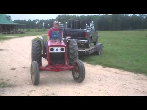

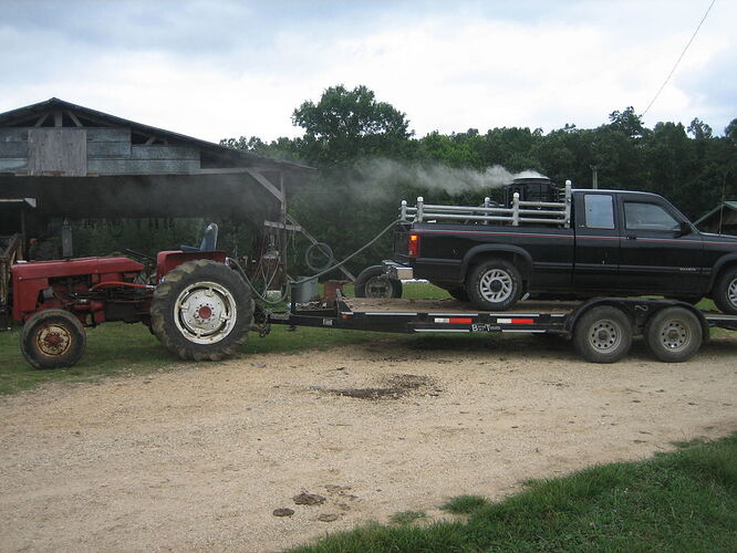

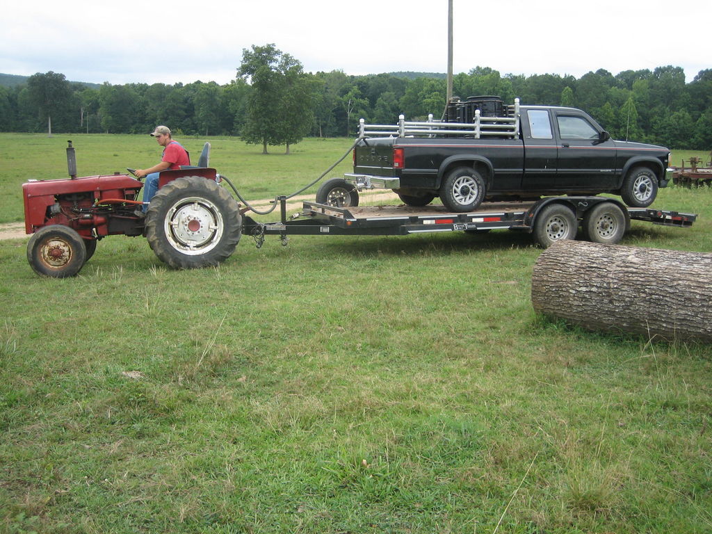

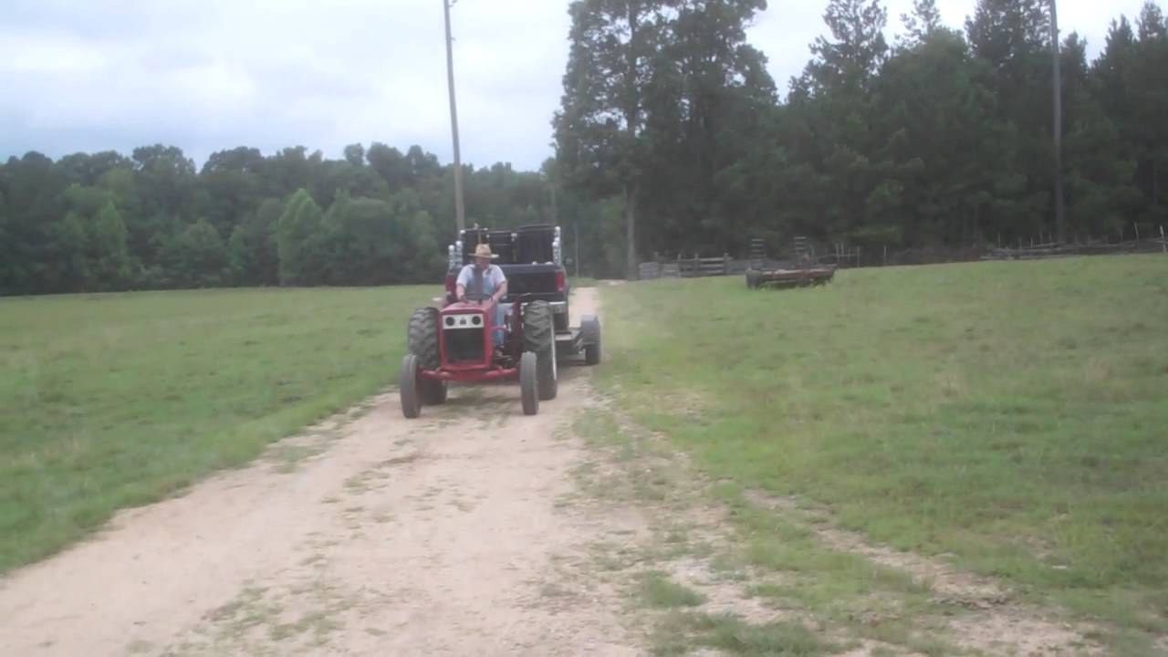

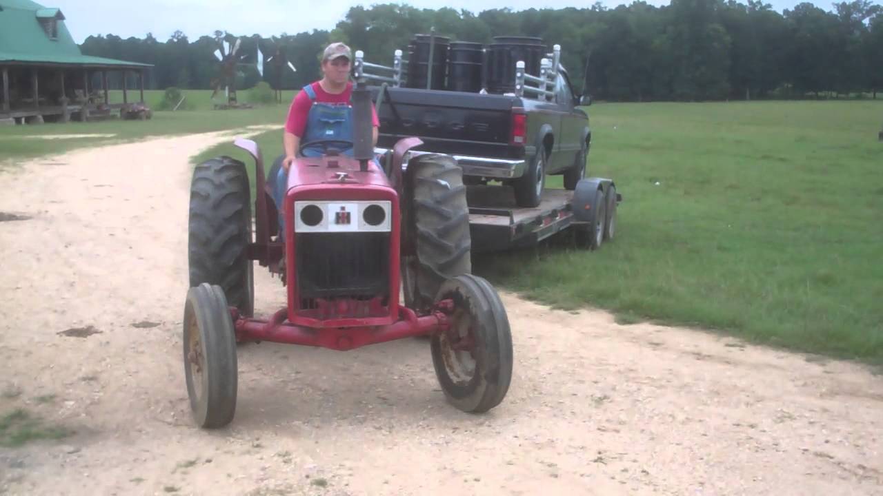

Today I hooked a trailer to the ole tractor , loaded the dakota on it and fire the dakota gasifier . I run a flex hose from the gasifier to the tractor and played with it about an hour.
It ran well , never missed a lick !
BBB

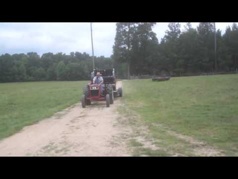

Hey Don , I did have fun !! Late this afternoon I fired it up again and drove it around,
The transmission is a 8 forward and 2 reverse

Wayne,
Did you need to change out the constriction plate before running the tractor? If not, with the internals set up for the truck and the tractor engine being smaller, would it eventually develop problems like making tar if run too long? Or do you feel there is enough CFM’s pulling on the gasifier that it is not a worry?
Good Morning to all,
Thanks folks for all the nice comments.
Bill, I didn’t change the restriction before running the tractor . If I had planed on running the tractor several hours I would have changed the restriction . The tractor is too small to bring the gasifier up to good operating temp. It wood be like the truck idling for a long period .
I knew the gasifier was left in a good state from previous drives and good deep char bed . With a good char bed it is OK to run for a while at low draw because you are using the char which will be clean .
