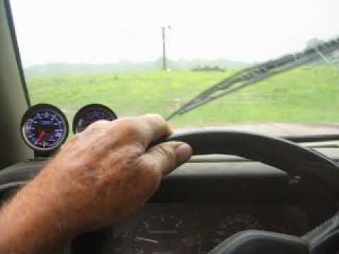

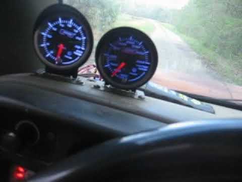

What are the two gages that you zeroed in on at the end of the first video? TomC
Hello Mr. Tom .
The gauge on the left is the temp in my crossover pipe from gasifier to drop box . It is set to beep and flash on and off at 1000 F.
The gauge on the right is the fuel hopper temp. It is set to flash on and off at 200 F.
