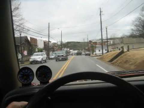

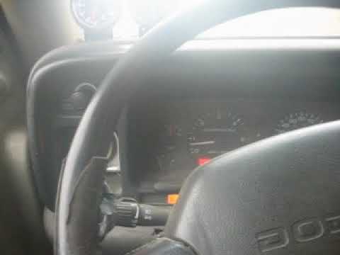

How are the new gauges working out for you on the dash board. I really like where you mounted them.
I have notice my eye sight is not as sharp as it use to be. Looking in the rear veiw mirror at the gauges it takes a little longer to tell what temperature I’m reading, maybe having to look twice. Lol. Get old you have to love it, you have no choice, it’s going to happen.
Hello Mr. Bob
The gauges seem to be a keeper . I have them on my dakota , v-10 and will be putting them on the new truck I am building :smile:
