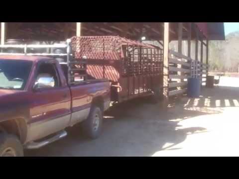

Not a lot to report but the daily routine which is about 30-50 miles . Just a little over that today as I hauled cattle to the market . ( Will get a payday this week !! )
I seen the stalls in the back ground.

This video is kinda off topic but the calves were hauled there on wood gas and the hay they have been eating was farmed and hauled with wood gas. Also wood gas took me there and back just a little while ago to pick up my check.
