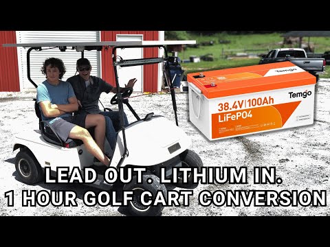

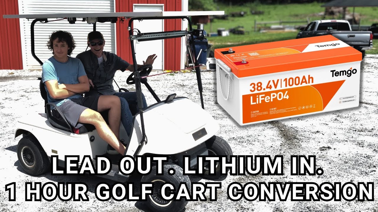

What comes with this kit is AMAZING for golf cart upgrade
They have both 36v, and 48v comes with charger, and dc to dc…
Amazing price.
School me here. Those Trojan batteries are 225 amp hour and the lithium is 100. I know that the lead acid can’t be cycled as deeply as the lithium and are much slower to charge as well as weigh a lot more but just in terms of supplied capacity. How does 100 amp hrs beat 225. No arguing that the lithium isn’t better. Just want to understand why and also for the same money as the Lead Acid why not double up the lithium.
You totally could double up the amp hours if you have the space for it.
But I think the idea of those lithiums is you’d go the same distance with that many as you would on the lead acid cells and weigh a whole lot less.
Mwa, or put as much in it as possible, ad an inverter and you have a movable powerbank.
There are a few factors here…
Lead acid batteries you can only take 1/2 of the amp hours of that of a Lithium battery, with a Lithium battery you have access to 100% of the amp hours…
Another consideration is the weight, if you are not carrying the weight of lead acid, one can go much father…
I have not done the math, but I am sure he will get some distance out with his setup… As mentioned before, there is room for more lithium if they need more…
I have seen a video on youtube of a guy who uses an electric chain saw + inverter to saw up his wood for the winter.
All kinds of options with this…
A * V = Watts.
The lithium batteries are more volts. in what appears to be the same size package.
The depth of discharge is 80% for LiFe batteries and no impact on battery life, and the output voltage is constant.
The depth of discharge to preserve LA batteries is around 50% and the voltage drops accordingly.
If you -really- take care of LA batteries which deteriorate every cycle you might get 1200 cycles. The LiFe batteries are in the 5k range and they don’t detiorate if you drain them completely so you don’t need the trickle charger.
At this point, I think LiFe batteries, cost roughly 2x what a LA battery is.
There are certain circumstances that you would want a LA battery like cold weather but usually golf carts are used in the snow. Some have heater to keep them warm.
Generally, most people are better off spending the extra money to get the longer life when they need energy storage. When they first came out like the big cabin cruiser boat people were driving the market even at 4x more expensive, they are safer in the cabin, hold more usable energy and a lot less of a problem. Most of those people just hired out the battery replacement and maintenance. Now they are good for 10+ years without even thinking about them.
Yeah 80% discharge is better with lithium than 100 % battery will last far longer.
Another factor is internal resistance of the battery, lead acid batteries have a higher resistance so it takes more to charge them than Lithium batteries. Indeed cold is a factor, can’t charge lithium batteries when the batteries are cold else they will be destroyed.
The LiFe batteries drop from 100% output to about zero at 80% depth of discharge, but it is okay to completely discharge them, it doesn’t hurt them.
The wear on LA batteries is proportional to how much charge they have used. The deeper the depth of discharge, the more wear and tear they encounter.
I don’t know if the LiFe batteries will be destroyed if you try to charge them when they wont take a charge or not. I haven’t ever heard that one before. But certainly the ions don’t move.
One thing before changes to lfp starter battery is the c rate. LA is good for starting. Lfp I do 0,5 C load and not to much spikes.
