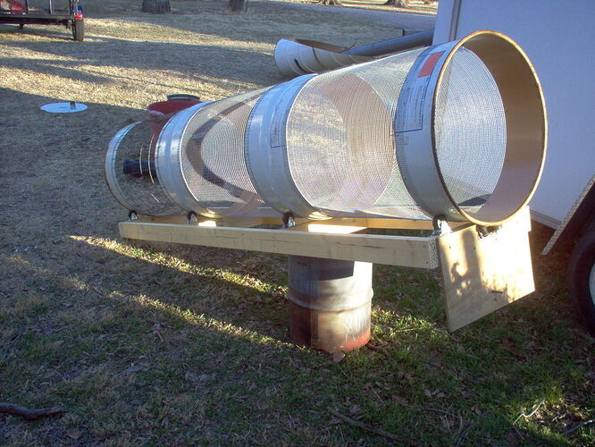

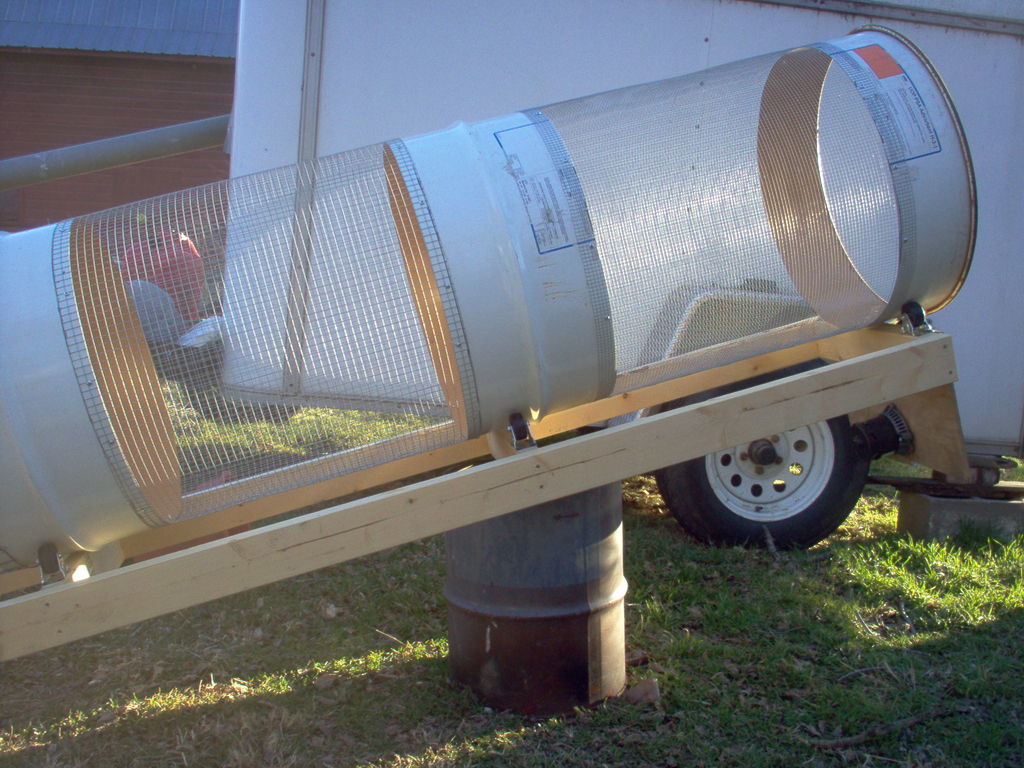

Here’s some pics of my woodchip classifier under construction. I have since added plywood separators to keep the classified chip piles separated. I have also tried various means of powered rotation, but haven’t found one I’m completely happy with yet. I simply toss in a 5 gal bucket of chips then slowly turn the classifier.
http://driveonwood.com/sites/default/files/gasifier%20026.jpg
I’ll look for some updated pics.

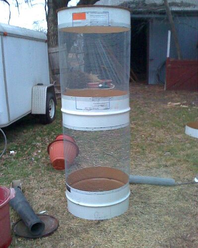

This is nothing more than a 55gal drum cut into 4 pieces with 1/4x1/4, 1/2x1/2 and 1x2 screen screwed between the sections. 2x4 wood frame with 2" castors. Pic during assembly:
