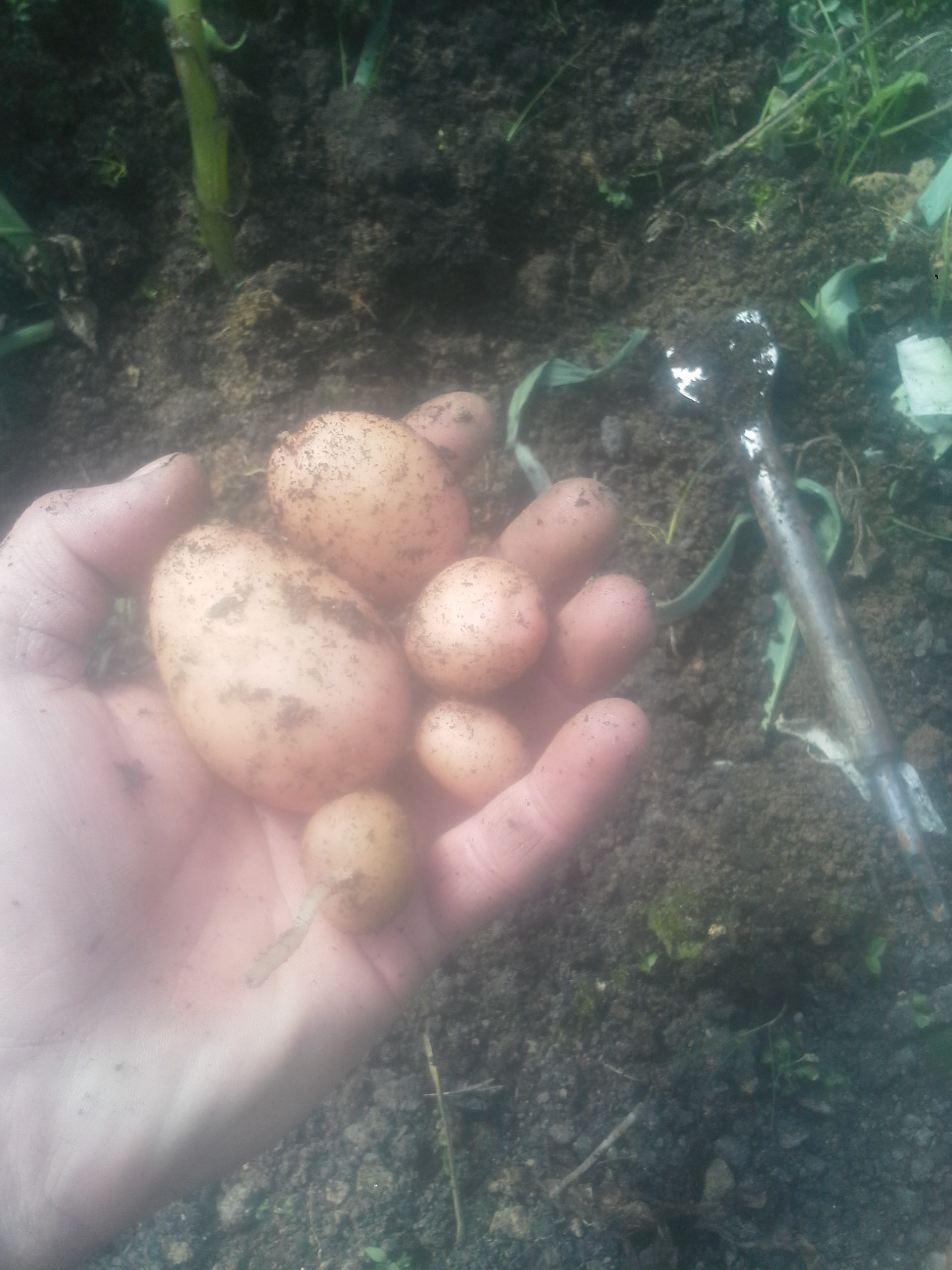

Potatoes in March? Wood power!
All growing well, l hadnt fired the heater for more thain a month now. I have a bit of a problem with one persistant bugger, the mole. The litle beast doesent realy eat anything, he just makes a maze in the bed. A bit of sulphur/potasium nitrate mix burned in a barrow will smoke him out

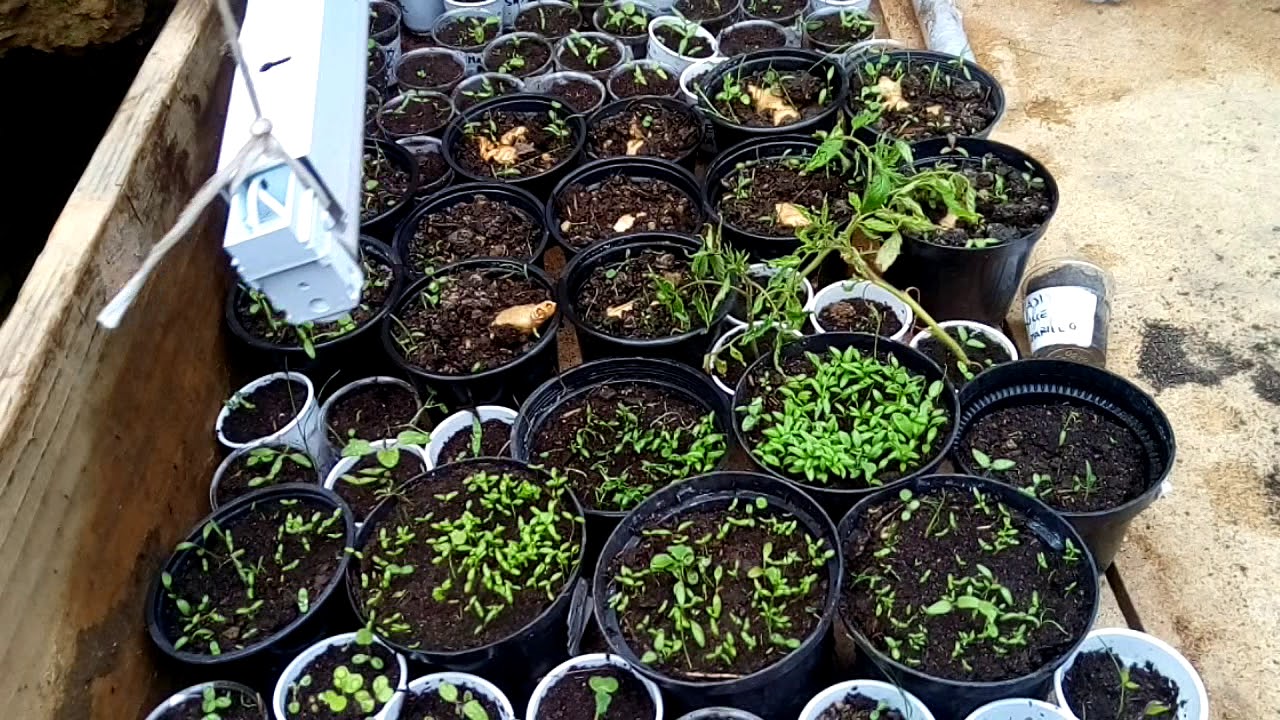

Not many unfortunaly. In adition to the light being shorter its allso much weaker.
I only lit a small neon above the seedlings in the end of January.

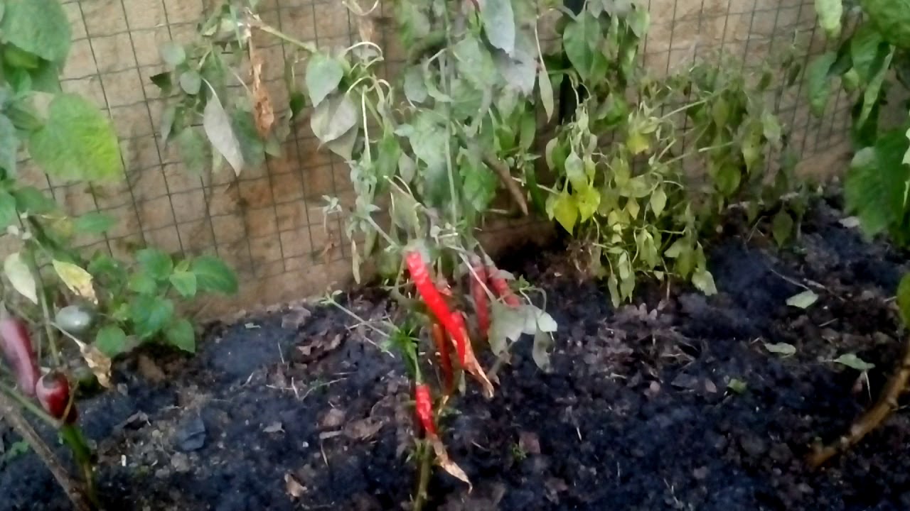

Thisis exactly the purpose of this project too. Grow mature plants in the fall and harvest all winter while they slooowly grow. Allso, to over winter heat loving peranual plants like tomatoes and peppers. The bushes l overwintered are fully developed and in flower at the moment, in comparison l wuld usualy just have a inch high seedlings at this time of year to be planted in mid May.
