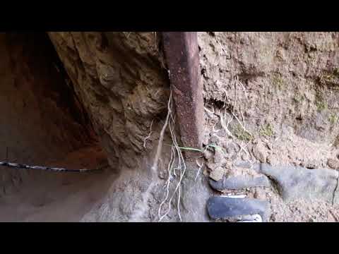

impressive achievements with your greenhouse! And you were quite busy digging into the ground. Two things I want to mention here:
I don’t know your soil/rock conditions and how stable it is, but if you are expanding your cellar, maybe think about installing some supports or pillars. There is an enormous weight above your head and I don’t want to imagine a collapse.
Also, please keep ventilation in mind. There is an oven in the greenhouse and CO2 might accumulate in your cellar.
I don’t want to sound too much nanny-like and most likely you have thought about that. I just wanted to mention it.

Thanks for the concern!
I visited a famous Slovenian wine county south east of me before l atended the project, they are famous for their root cellars. We have identical material to work with, its a super compressed quarz sand, sandstone basicly. I visited the largest cellar in the county,
https://www.google.si/search?q=repnica+najger&oq=repnica+najger&aqs=chrome..69i57.7595j0j4&client=ms-android-samsung&sourceid=chrome-mobile&ie=UTF-8#lkt=LocalPoiPhotos&trex=m_t:lcl_akp,rc_f:nav,rc_ludocids:3734156578377431638,rc_q:REPNICE%20NAJGER,ru_q:REPNICE%20NAJGER&viewerState=ga
As you can see they use nothing but what nature provided milions of yers ago. Just carved sandstone.
The owner provided me a simple stability formula. Minimum sealing thicknes is 4m, max room diameter allso 4m and everithing must be arc shaped. They tested their cellar first with 6 sticks of dinamite blown inside, then with a 10t tarmac roller on top with full vibration. Not a crumble was seen. The callar allso survived 2 nearby earthquakes with the workers not eaven noticeing it from the inside.
My cealing is 6.5m thick and the “social room” will have a radius of 3m so shuld be ok.
I will cast the stairs and hallway in concrete thugh!
Ventilation. Your concern is valid here. Not so much becouse of the wood burning stove but becouse of the wine fermenting in the cellar. Its a death trap if not made correctly. The mentioned cellar has a 4" pipe hiden under the floor of halways with a fan constantly pumping air from the lowest point of the cellar. I will do the same. Plus, kerosene lamps will be the only sorce of light alowed down there. Shuld the co2 level rise criticaly the lamp will extinguish and warn the people to get out.

I am impressed at how much digging you have done Kristijan! It looks like you will have quite a nice storage space once you are done. Have you thought of digging out some sort of sump in the floor for your spring?
As for your CO2 problem, you will produce much less if you do your primary fermentation on the surface, and then transfer the pressed out wine to the cellar to age it. Also, I am not an expert on CO2 and closed environments, but a quick search turned up this link: Latest Power Generation News and Insights
“Carbon dioxide is inexpensive and nondestructive to equipment, but is lethal at the concentrations required for fire extinguishment. According to NFPA 12, Carbon Dioxide Extinguishing Systems, the minimum required CO2 concentration for fire extinguishment is 34 percent, which is adequate for fuel and lube oils.”
I also found: Carbon dioxide - IDLH | NIOSH | CDC “a few minutes of exposure at 70,000 ppm and 100,000 ppm produces unconsciousness” (7-10%).
I would be very cautious about putting anything down in that hole that makes CO2. We dont want it to wind up being your tomb!

The nature of CO2 (being wery heavy) can be your friend and enemy here. If the flame of a candle/lamp is lower thain your head you will be warned in time. But shuld for any reason feel dizzy and sit down you are screwed. Every year there are about 1-2 cases of CO2 related deaths in wine cellars in Slovenia. People go down without a candle, feel dizzy, sit down and fall asleep iternaly. The sadest thing is usualy there are more thain one victims as bystanders usualy try to lift the winekeepers and they pass out as well. As a matter of fact, my wifes relative allmost lost his life this way 2 year back. It is no joke and every percusion must be taken to concideration. I am actualy more afraid of CO2 thain CO. The unbearable headacke from CO will usualy tell you something is off (dont ask how l know this) but the CO2 will just drain your life slowly and unnoticeably.
Hey, A quick search of the internet confirms my hunch - off the shelf CO2 meters are mostly geared towards industrial applications - so there dont seem to be many cheap homeowner models. I guess most people are not digging deep pits in their backyards and fermenting things in them - how boring. It does look like you can get something for 100-200$ - I would personally feel like my life was worth that much… then again, if you wanted to spend a few hundred bucks, you could have made yourself a beer fridge and brewed your lager in the garage without all that digging!
I was going to ask if you knew anyone who was smothered in one of these cellars - and so clearly this is a dangerous situation. It seems to me that the idea of using an open flame to detect pockets of CO2 is a recipe for disaster, as my (very hasty) research suggests that a flame will stay lit well beyond the safe range for you to breathe.
Clearly this type of cellar is in use, so it should be possible to do it safely. I think your idea of venting the CO2 from the fermentation lock would be a good one - as well as an active ventilation system pulling air from the lowest point and discharging it far enough away from the opening to ensure the heavier CO2 doesnt sneak back in.
From a design standpoint you could probably reduce the risk somewhat by ensuring that your floors all slope to a single point, and then put your exhaust fan there.
Also, it seems like it would make sense to crunch some numbers. Like, how much CO2 is produced by fermenting 20L of lager? Roughly how many cubic meters of air do you have? How long would it take your fan to completely refresh that air? Using those figures, you should be able to come up with a relatively good idea of what would lead to an unsafe concentration of CO2 - and then dont do that.
One last thought I had - you are on a hill, right? How far sideways would you have to go to get to daylight? I am guessing far enough to not be worth trying to dig a ventilation shaft, but thought I would at least float the idea.

How about building (digging) (drilling?) a vertical hole near the rear of the cellar to the surface with a straight ladder and a hatch or scuttle at the surface. It would just have to be large enough for you to get in or out and would give access for air ducting and hoisting heavy objects. It is hard for me to visualize the (sandstone) material your hillside is made of. If I dig down a few feet of the flat farm fields where I live, the hole will soon be filled with mud and water.

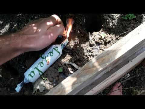

Here is a method that works realy well on gophers. Harmless on the soil as all the byproducts of the burn are potasium salts, carbon and some sulfur. If the smoke doesent kill the gopher, the smell certainly changes his mind if he is thinking of making the new home permanent.
Ps. I just realised, on the first cartridge (made of newspaper) there is a title “hudiča spekel” wich translates to “bake the devil”. Coincidence? :smile:
Nature never seases to surprize!
