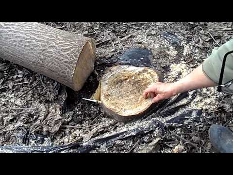

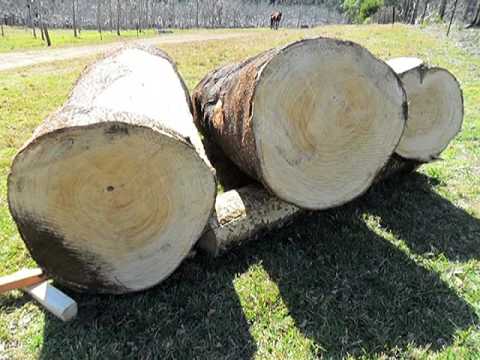

Pawlownia harvest in Bosnia. 5 years after planting. Its not exactly oak but even if the wood is super light such a harvest in such short time must make some sence in todays energy crisis???

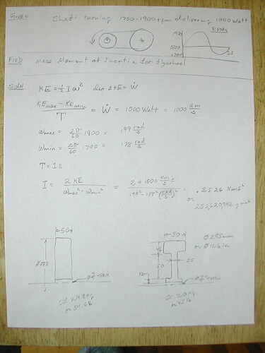

What size flywheel would you use?
Had to ask the director for translating. Didnot know that it grows so fast, maybe faster then willow. The nice thing with willow is, you cut it and it grows again. This ones are cut and you have to plant again? Very fast grower. That is for sure. And straight. Nice for timber?

I asked the question on here a little while ago: Truck Powered Chunker, would it work? I got a strong negative response from people here. But still, I think it could be done somehow. The exact setup on that thread wouldn’t work. I see that now. I think the speed would have to be reduced 2:1. I’m worried that your tire full of cement might be hard to balance. A flywheel from an old baler would have been made to turn at 540 rpm, and it seems that most chunkers turn between 60 and 120 rpm. I flywheel stores energy at a rate proportional to the square of its speed. 60rpm/540rpm=1/9 so a baler flywheel turning at 60rpm just isn’t going to be anywhere close to storing enough energy.
Here is a preliminary calc I did to estimate the size of a flywheel turning at 1800rpm. This is based on @Chris baler chunker video which he was powering with a 9 amp motor. Right now I’m thinking I could power with a 212cc predator on chargas.
Ah, sure, your “director” certainly knows the translation better thain l do :smile: l understand 80% of the language but still l usualy miss the important bits. And it just happened my Bosnian coworker wasnt on the shift today. I got most but failed to understand what was the exact reason why he harvested them at this age and not a few years later. He did say his main goal was firewood if l understand right…

I don’t know if your question is about @Jan’s chunker or chunkers in general. I don’t have that type chunker but used a flywheel from a stationary bicycle for my rebak chunker, only because it happened to fall in my lap.
I think most of us would first if all use whatever we could get our hands on and secondly just try to estimate if the rear end, gearbox or whatever we’re using can take the torque and abuse of the flywheel coming to a halt. I’m not familiar to balers, but at least if you’re using a vehicle rear end the flywheel would spin 3-5 times faster than the cutting rim.
Yes, that is wath is told me too. Didn’t think that Palowna looked like that. A friend of mine has a real old one in his garden. Not so straight at all.
Well there are many vorietys. I know wich one you are reffering to, its more of a ornamental kind. But those straight vorietys are stupid fast growers.
Actualy, a guy just a few miles down the road planted 8" saplings in June? This year and today they are over 3 feet tall. I will post pictures tomorow if l remember to take them.
I am interested in them as well, partly allso because they flower strongly when mature. Bee stuff…
As for growing back from the stump, l know young ones do because years back here was only one woriety that culd be purchased and it wasnt wery winter hardy so people sugested cuting it down the first or second year to make it more hardy. With newer vorietys this seems to not be nessesery.
As for older trees, l dont know.
Althugh my mother did sew seeds years back and nearly all sprouted and turned to 10" saplings same year. So even replanting isnt a big deal.
She moved since then, l am curious how the trees are doing after all those years…
But allso, the fact they sprout so easy and row so fast is a potential recepie for a disaster. If this thing becomes invasive it wuld be a catastrophy. This is why l am still hasitant
This Serbian guy got it smart! He says he did cut it to the ground the first year for aclimatisation like l mentioned. But the wayl look at it, and the way he presented it, you culd plant it in alternating rows with corn on year 1, combine or silage the corn and pawlovnia to the ground, next year the pawlownia grows on its own and does so for the next 5 years. Harvest, repeat.

Maybe I went off on a tangent before. Its been known to happen. I guess my main point was that a flywheel running at 540rpm stores 81 times as much energy as the same one running at 60rpm.
Can you tell me the approximate dimensions of this flywheel and how fast are you making it turn?
I have thought about an exercise bike flywheel, but I have not found one yet.
I have this old harmonic balancer from a big v8 engine, but it’s much too small. Maybe I could shrink a 20 lb (9Kg) aluminum ring onto it. It would be very good for removing very high frequency vibrations. But I feel ridiculous. I want to find a proper flywheel.
It’s 12.5" in diameter and I guess the weight is 10-15 kg. Most of it at the very perimeter.
I clocked the cutter shafts to 108 rpm and the flywheel shaft turns about 4 times faster.
With 4 cuts per turn and 7-8 chunks a second the flywheel gets very little time to recover, but it’s still better than nothing.
