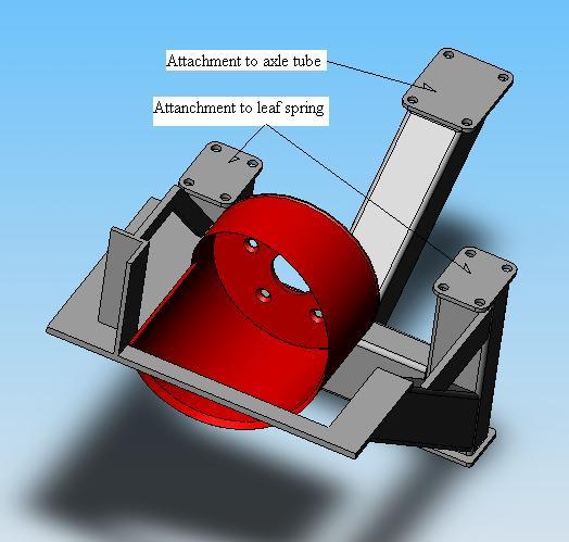

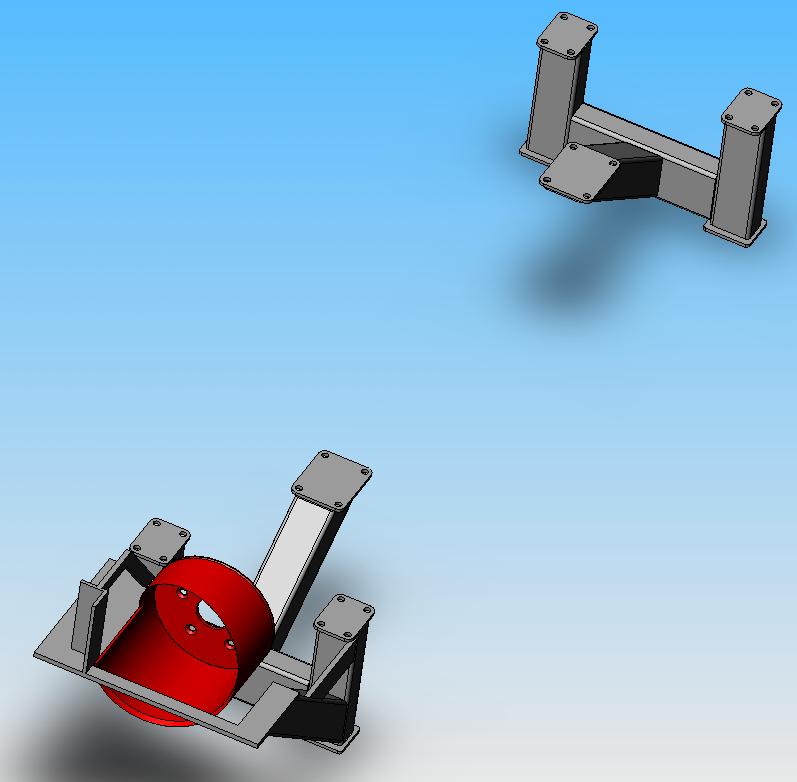

I’ve been kicking this idea around for a while now. I want to be as safe as possible. This isn’t a treadmill, which I understand are dangerous. I know how to brake the only the wheel on the other side so it would act as a safety slip clutch. This seems simple and low cost so I have to believe that people have at least thought about it. Has anyone tried this?

Stopping one wheel doubles your speed and halves the torque. All the strain goes on the spider gears, you could blow up that diff on a hard chunk of wood.
That framework looks difficult to install. Is this a permanent conversion or one you want to drive afterwards? If it’s dedicated to chunking, weld the diff, add a flywheel and slip clutch to the input driveshaft.

I think it could be portable If you built it on stout enough of a trailer, but it would be heavy. When I was out there Dr Larry and I did a little playing around with this. the main Idea to avoid the slipping diff problem would be to build a steel pipe on a set of bearings mounted to some really stout hinges that would swing down when you wanted to chunk, to lock the two wheels together. Then to mound a dual wheel hub on a single wheel pickup and use the outer rim to mount your cutter head on to and build the anvil inside the side of the bed. I would probably do a flat cutting disk on it line BobMack or Jan just built one with the same style. The reason being the room they take up unless you want this thing sticking way out the side of the vehicle yo are working with a very limited space.
I would be concerned if you are doing this on a light pickup truck. I believe Chris is right you have to do it properly or it will destroy a diff in no time.

Thanks!!! That’s exactly the kind of thing I wanted (and needed) to know. I suppose Wayne’s diff doesn’t blow up because it’s from a 3 ton truck?
if this were to happen the way I imagine, setup and take down might each take an hour. If I were to chunk up about a ton of wood I would probably then be able to drive for 4 or 5 thousand miles. Two hours spent setting up and taking down doesn’t seem that bad.

Learn about how a differential works:
The two small spider gears only spin during cornering, and transfer very little power. When one wheel stops, all the power from the engine must transfer through them to one wheel (double their normal design load). Their bearings are smaller and not made to take that pounding. And, as I mentioned the wheel speed doubles and torque halves (not what you want for a chunker).
Wayne welded the spider gears to the side gears, making it one solid chunk. But the big ring gear still turns, and the axle bearings themselves take the abuse. Full torque and lower speeds.

The style of shearing chunker head you pictured develops a tremendous amount of axial thrust in force.
Your c-clip retained light duty Ford Ranger axels will fail at this c-clip groove/retainer lip area.
A true truck rear wheel drive axle will have thust capable opposing tapered roller bearings on each side. The axle is retained on it’s forged outer flange end by many bolts to the heavy cast bearings hub.
So “maybe” begins at true F250/2500 axles.
With for sure at the proven much larger, lower geared truck&bus full floating axles

Yup, those Timken tapered roller bearings sure are nice. They take both axial AND radial loads. I might look into that c-clip groove/retainer lip thingy. But I can remember hauling flagstone. I did didn’t go extra fast but I wasn’t a traffic hazard either. I just know that going around corners had to generate some big thrust loads. Hard for me to imagine that chunker doing worse than that.

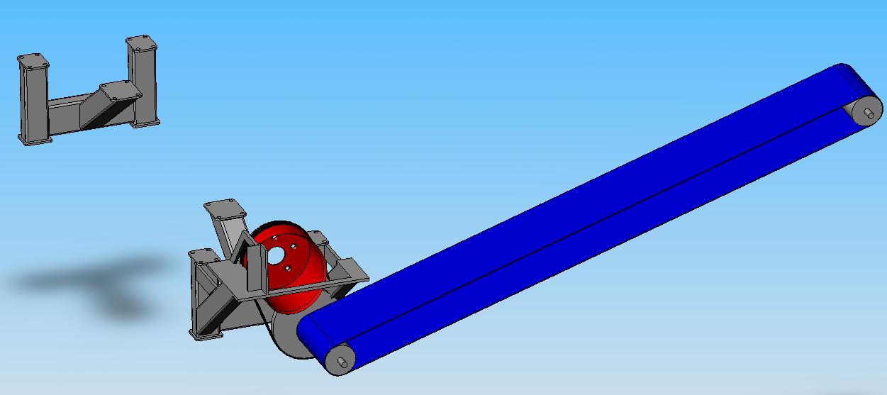

So i was just doodling. I think if I actually build an elevator I’ll tear up an old treadmill and reuse the electric motor so it would be independent of the truck and speed controllable. But wouldn’t something like this be nice for filling bulk sacks and storage silos, putting the chunks on a trailer and things like that?
