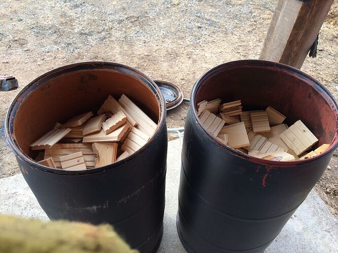

Last year I went to an Amish saw mill that made hardwood flooring and was able to buy 55 gal drums of kiln dried scrap for $5 a drum and each drum weighed 150#. It was worth the 20 mile drive for when my gasifer is done. But alas my hopes were dashed when this winter I drove by and found it to be no more. So today on my way home from working on the mixing air cleaner and starting blowers I thought I would stop in at a Amish saw mill that is 4 miles from my house. Low and behold they have a dry kiln and produce hardwood flooring too. I told him I was looking for scrap pieces of which he showed me (2) 55 barrels full and said it was free for the taking. So I took one barrel and put it in 2 of my 30 gal drums. If I leave my drums there he will fill them. I told him what I was up to and he warned me it was pine. I said thank you, and he insisted in seeing the truck even though its not functional yet. I’ll take the free wood.
Welcome to the gravy train Wes. Gotta love these places, they trim their ends to improve their quality, and we reap the “quality” benefits too. Win, Win!
Good score Wes …

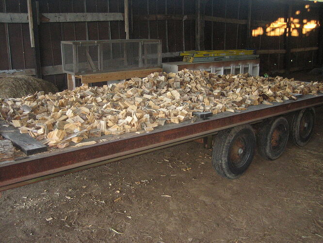

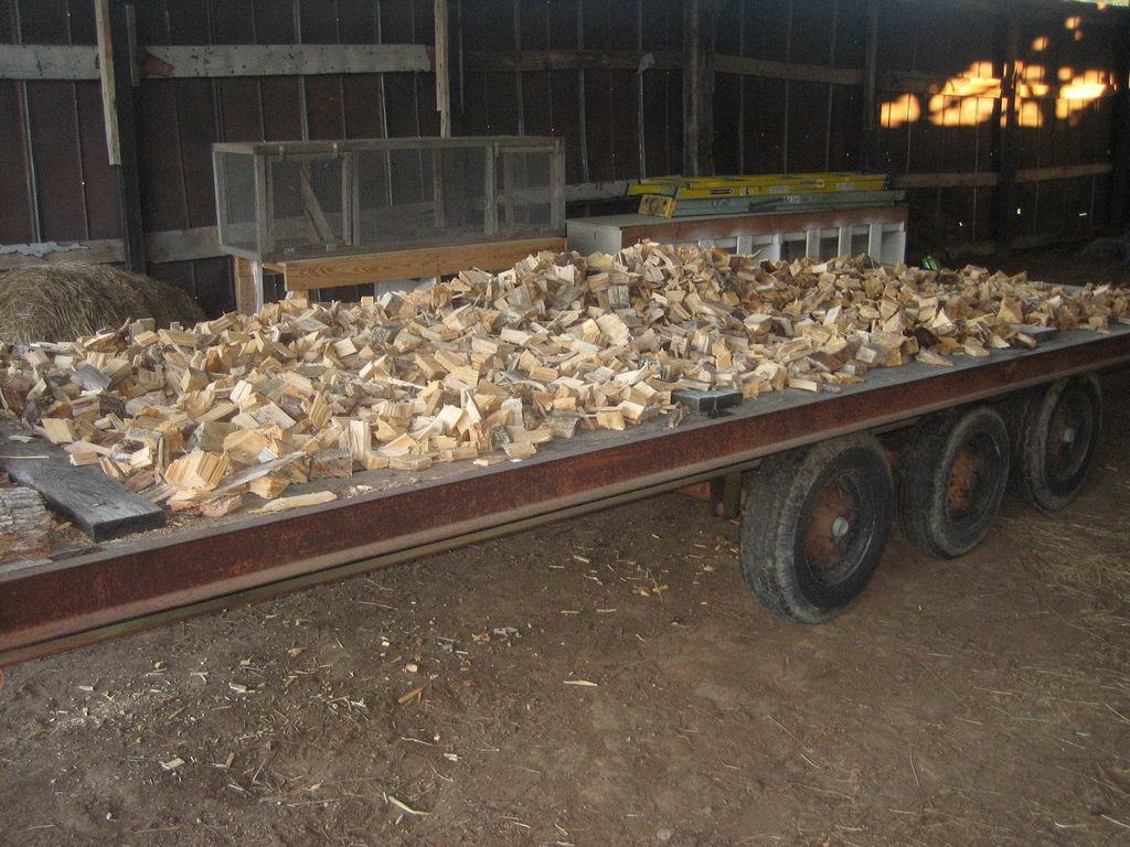

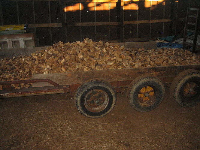

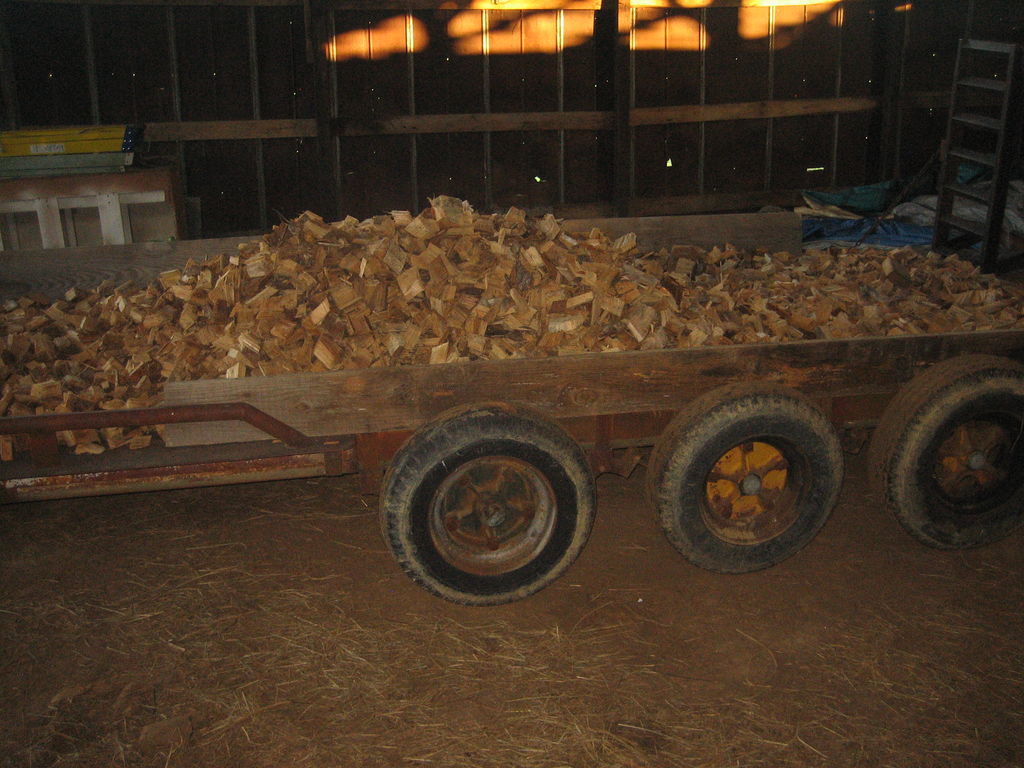

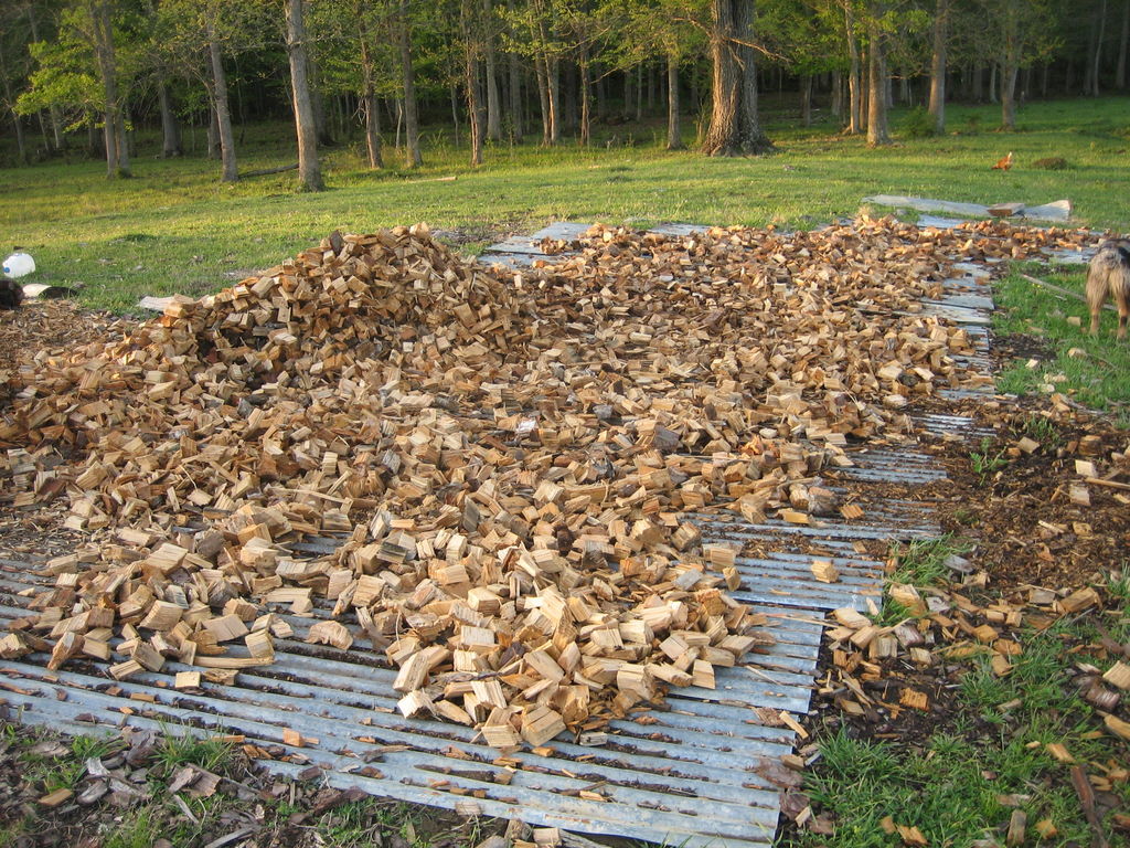

The wife and I bagged about 40 sacks yesterday. The pics below show what should be dry by the end of the week .
Would hate to buy the equivalent in gasoline !

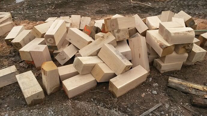

Im envisioning a stationary setup kinda like this. 90% of my wood supply comes from one of our mills as the cut offs from our crossties being cut to maximum customer length. I get them by the truck load for free. The rest are board ends from the trimmer. Everything is hard maple or oak. So should be good fuel.
Wood Cutting & Splitting Attachment:
Attached is an image of my wood supply.
The controls I have covered. Does anyone have any recommendations for hydraulic pumps, or fabrication advice for the splitting wedge? The idea is to cut the blocking at short intervals then press them all against a 5 or 6 point star style wedge. I have no idea how much pressure it would take to split that. The more wedge points I have the more pressure I would imagine id need.
Hey Ian, welcome to the site.
I guess it would depend on how big of a stationary unit you want to build, what is it going to be used for for the size of blocks to make.
It’s hard to judge by the picture here how big those blocks are.
Hello Ian and welcome aboard .
When I first looked at the picture I thought the wood was 2x2 but then looked closer and realized they may be 4x4 . For most application 2x2x2 should be about the right size .
Thanks for the welcome.
They are 7x9 and range from 10-30" long. All of our crossties are for railroad use and must meet a certain margin of size. The most our mills cut are 16’ to fit through our trimmer. The most our contract customers can take are 12’ so we cut to size by the bundle. Im wanting a more efficient way to process gasifier fuel from the blocking. Im not against a good days work but id rather work smarter than harder producing fuel for the week than by chainsaw and axe. Which could range anywhere from 50 to 110 miles a day on a 318. Hopefully soon a swap for 360. The supply is not in question as when I travel its from mill to mill. Collecting a surplus I could even share and still be over stocked. Just processing efficiently is my goal.
