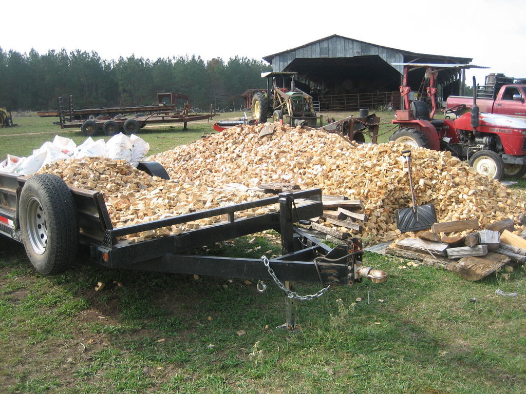

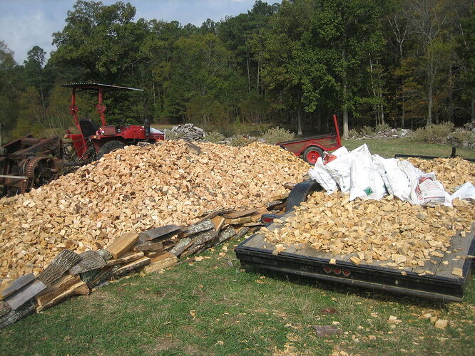

Impressive work Wayne. Do these pictures mean that even in Alabama, the harvesting of chunks holds off until spring time?
Hello Joseph,
If this wood was in sacks and dry I could give some estimate of work or energy it might contain . It is not but I will give a WAG ( wild ass guess ) . The pile is 12 foot wide , 34 foot long and near 4 foot deep in places . I think the dry weight would be between five and ten thousand pounds . My dakota on the open road will get 1.3 mpp ( miles per pound ) 7,500 . X 1.3 = 9,750 miles .
The above mileage could be dropped to half if short trips or stop and go traffic. A better way to look at the pile is there could be between 300 and 600 gallons of gasoline in it.

Winter is fine for chunking . Also I have enough wood dried , bagged and stored to last out the winter . The reason for this chunking is I had some pine saw logs laying out for over a year now and haven’t sawed . I think if I sawed them now I would have to slab off too much wood to get decent lumber and I really don’t need lumber right now . I was tiring to salvage the wood before it was to late .

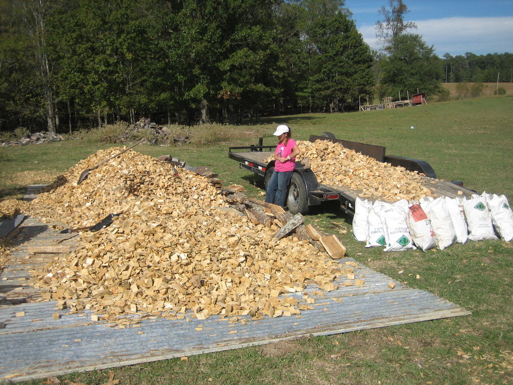

I was trying to get some dead trees out of the woods before wet weather sets in. I pulled one log all the way to my chunker and chunked some before I realized it was to far gone and discarded it.
The load on the trailer is just one tree . It measured 24 inches at the butt and is 8 inch diameter at 90 foot where it broke off. . I wouldn’t want to guess the miles it has in it but there will be many !!
I also noticed three more pines near this one and near the same size that are dead or dying

A lot of work.  A lot of miles and heat for the house.  Can’t say I blame Lisa for taking a break to play with the dog

I like how you have fuel holding up your fuel on the sides. It seems like a corn crib could be a good storage container for all those chunks. Marvin W had a good idea about an old gravity trailer too.
Nice pile of wood. Sure looks like it took a lot of work to make that.

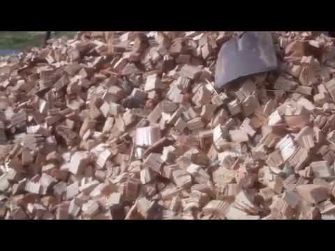

of where the chunker “throws” it up in a neat pile to dry.

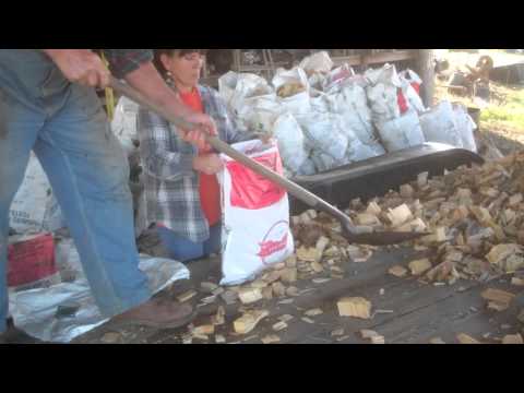

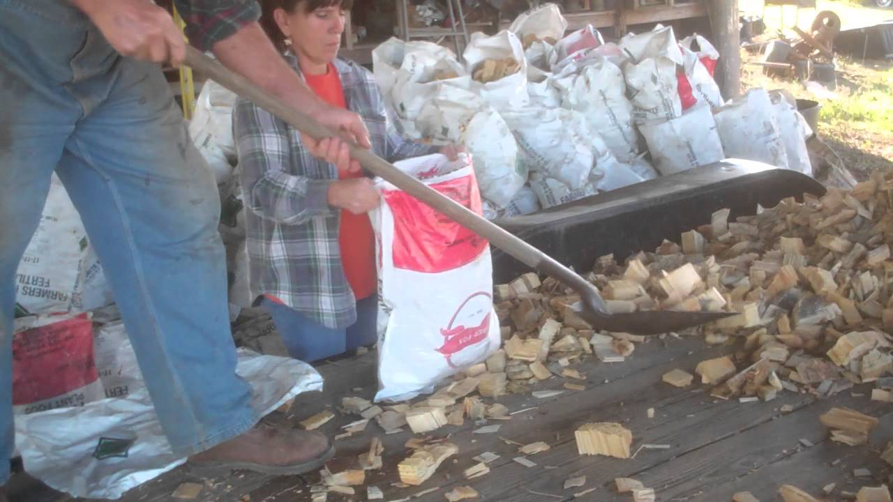

Hi Mr. Wayne, thanks for the picture of the wood pile. It takes a lot of wood and work to keep a gasifier running but it is well worth it.
That is an easy transfer, and Lisa doesn’t seem to have big arm muscles to handle them. Julie, my wife could agree to doing that. A few weeks ago I spotted orange web poly bags for sale over in Hudsonville (10 miles away) but there was no company name on the building (after hours). My employer is overtime demanding again, so I found a solution. Entice Don M. to fetch for the both of us. We now have tons of 10 cents a bag supertanker volume. But Wayne, there’s a gap in your vast library of how to videos. How about from the ground to the trailer?
