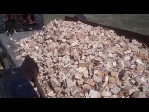

Hey Tom, I just don’t see dirt, rocks, foot long sticks and such on that trailer, so there’s some filtering process or a bunch of chunks left on the ground by the chunker.
Big as Wayne’s pile is he can just skim the top for the next year and not get down where the nasties are. : *)

Thanks, Wayne. I have so many of your videos stored that I’ll have to create categories to sort them out. Looks like I’ll be bolting several sheets of corrugated or pole barn metal together and riding my 2 wheel chunker right over it. Looks like I’m going to have to retrain your son on my last name
Did some one say “chunkier”? I don’t recall hearing about your “two wheeled chunkier”. Mr. Wayne, I have always understood you to say you took the stickers from the saw mill and chunked them and then, dried the chunks. When you were shoveling, the wood “rattled” like dry wood. As you know I have been chunking very dry oak and it shatters badly. I like the looks of you “chunks”. I like the product that Hartman is getting and I have sawed cow patties and give them the ax. But that is soooo slooow. I’m still looking for something that produces a good product with minimal effort.TomC
Hello brother Tom,
At one time I was doing a lot of saw milling but in the last year I have gotten so fare behind with other projects that I had to turn down most sawing jobs. With the sawmill waste I was using the stickers and slabs for gasifier fuel but this last year I have mostly used trees that are dying on my place .
The wood you saw us shoveling today was chunked Oct 28 and was wet enough it would squirt water in my face . The pile is outside in the weather but we haven’t had but a couple of small rains in that time span. Because of the smaller fire tube on my tractor I have started making the fuel a little smaller and seems to work well in trucks and the tractor.
I think the wood we shoveled on the trailer today would be OK to sack but to be on the safe side I will spread a portion of the wood out 4-5 inches deep and give it another day on the trailer, sack it and spread more of the pile and repeat .
