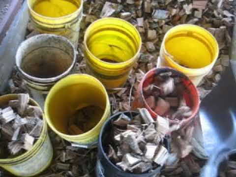

Each bucket weighs about 12 pounds which means each bucket is worth almost a gallon of gasoline .

You better get it while you can, last time i checked, at the used steel place, it went from 40 Cents a pound too 140 a pound, crazy high around here.
Them must be gold in them there buckets, I caint hardly wait too get my dakota wood truck finished, befor gas goes up even higher again, if they steel the election again, in a couple years.
