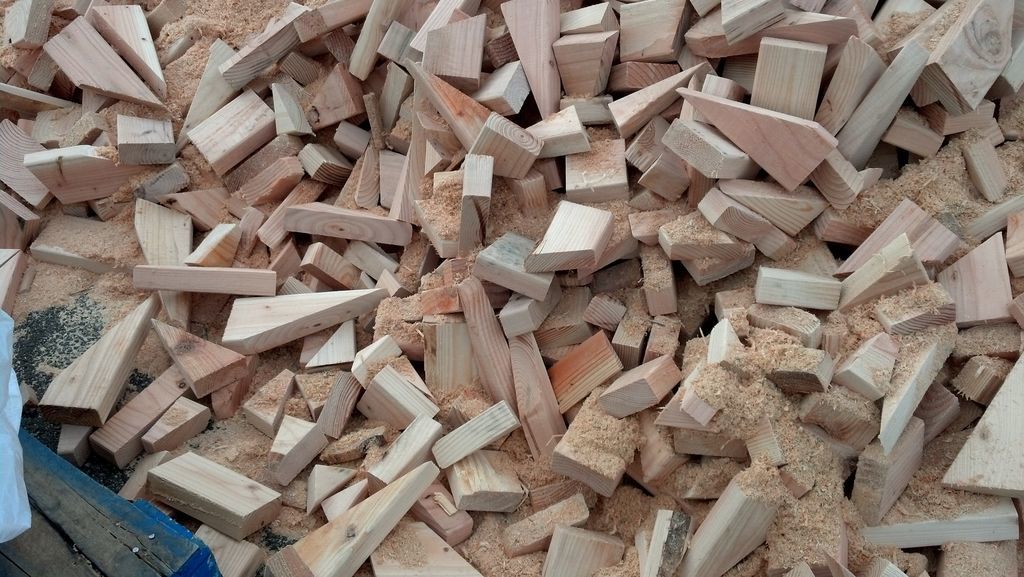

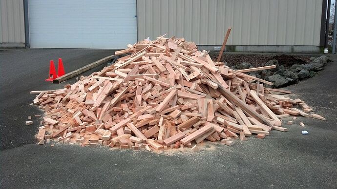

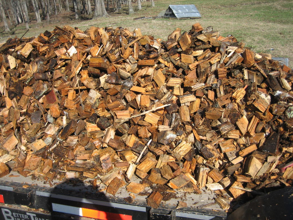

I got a load of “mill ends”. It was an ad on craigslist. He says it’s 2+ cord, I believe him. The price was $175 however when he came to deliver he told me it would be $100 because it was not a great quality load. Too many small pieces. He was right, I have a lot of fuel ready to go now for a bargain. I told him I wanted small pieces, and he mentioned that next time I could come to the barn were he stockpiles it. People come to buy wood and take all the larger pieces leaving the small ones.
Hey Derek ,
Good catch, lot of miles in that pile.
Did he know he was delivering motor fuel?
He didn’t, and of course I’m sure he would be quite surprised or unbelieving if I told him.
I got some free super sacks previously used for grain. I filled two of them in the same time it took me to cut up all the pallets I’ve used thus far. While I was doing it, I felt like a squirrel that found a huge pile of nuts trying to store them away for the winter.
Hi Derek, that is some nice looking gasifier fuel.
Ron,
Burned some today, seems to work alright. I’m guessing it’s Hemlock or Fir. Found out it came from a truss company.

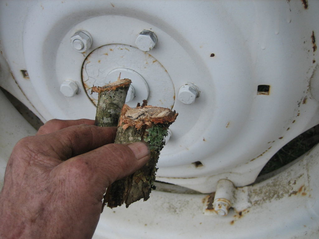

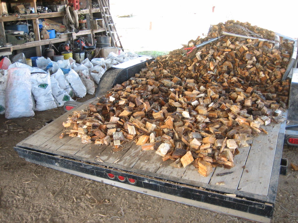

I have been busy the last three days getting some logs to the sawmill. While cutting the trees I also bring in the branches for gasifier fuel. I don’t really have time to do the chunking right now but the slabs and the limbs chunk so much faster while they are green that I made time .

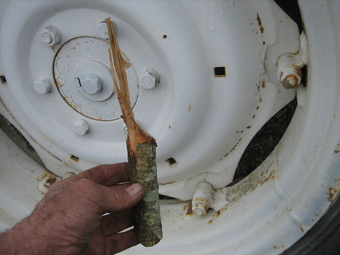

The chucker was cutting the big limbs and slabs with no problem but the very small limbs were leaving a stringer. See picture 1

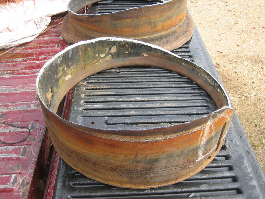

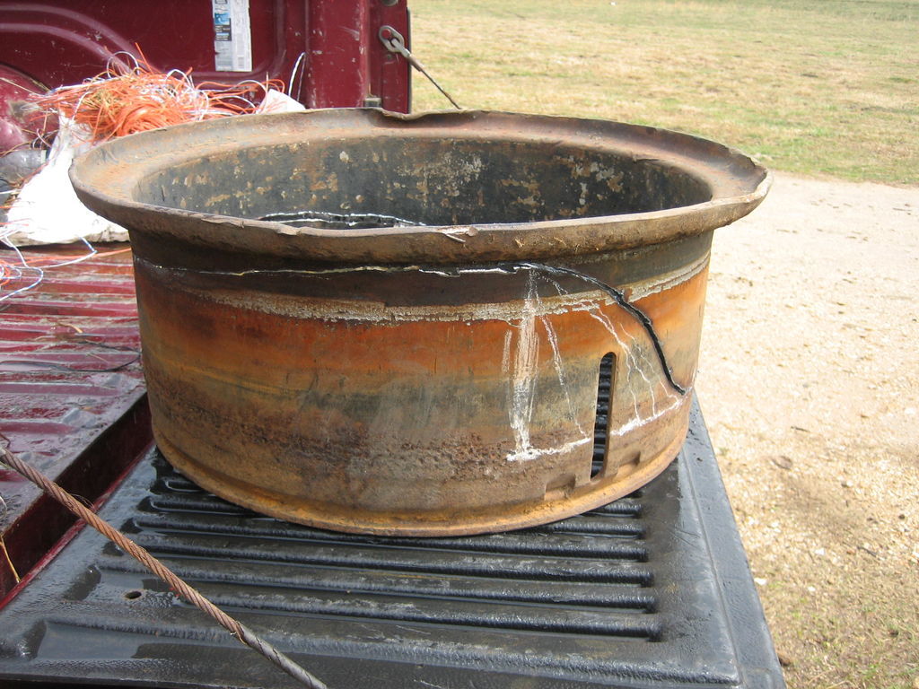

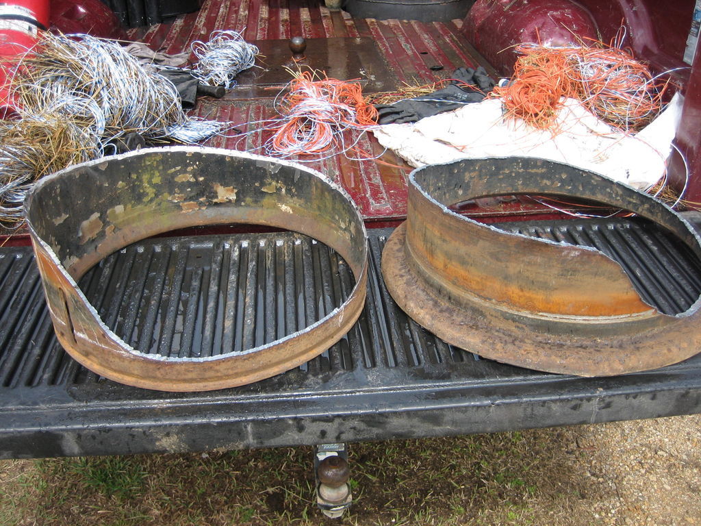

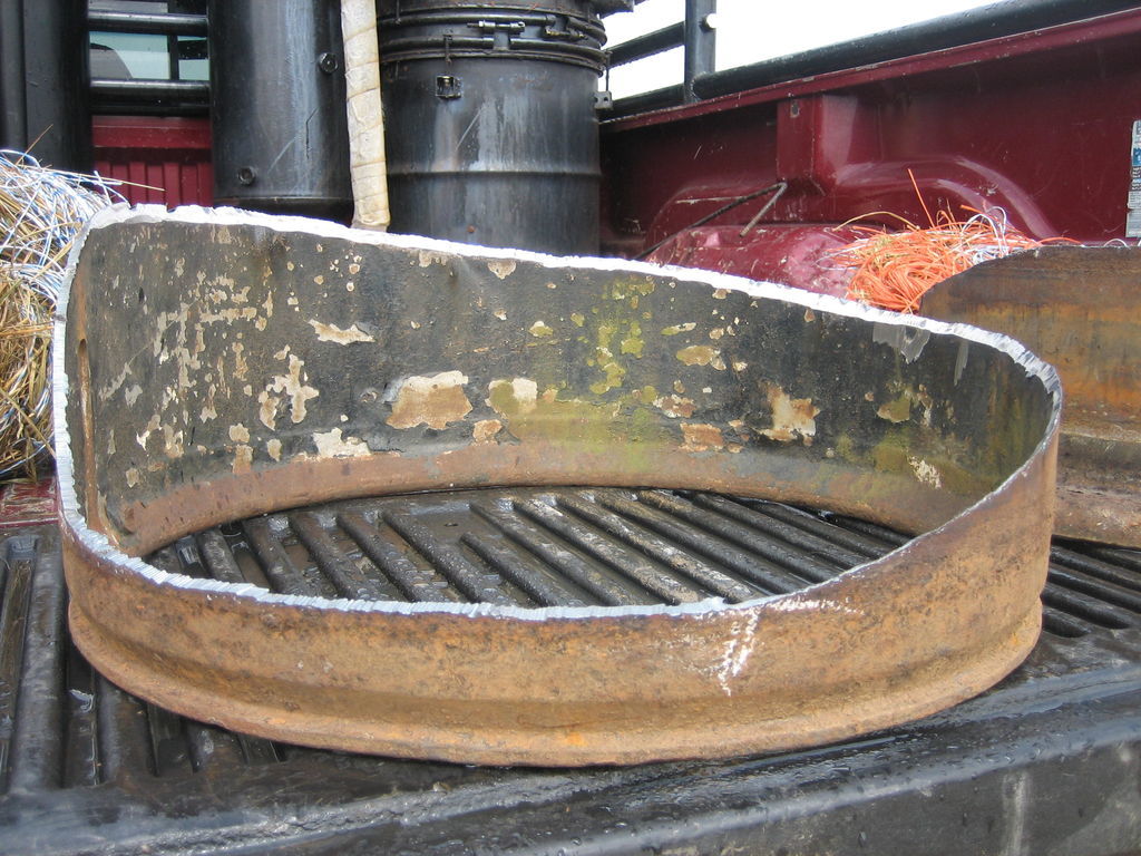

The truck rim that does the cutting had beveled just enough so that the scissor action wasn’t happening.
Picture 2 ( old rim )

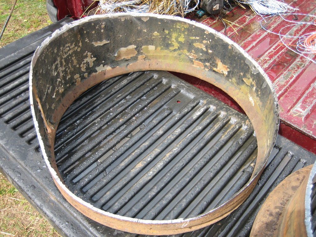

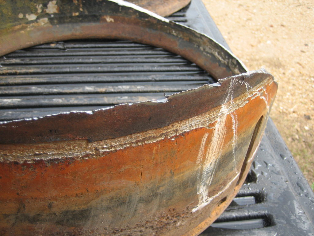

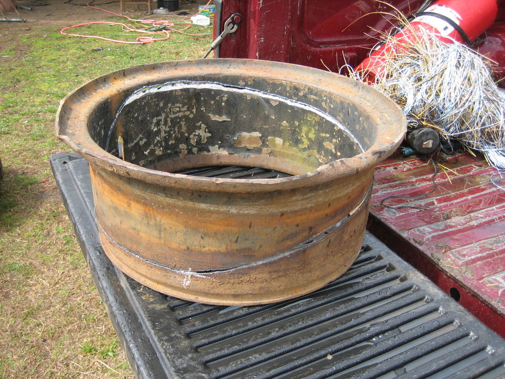

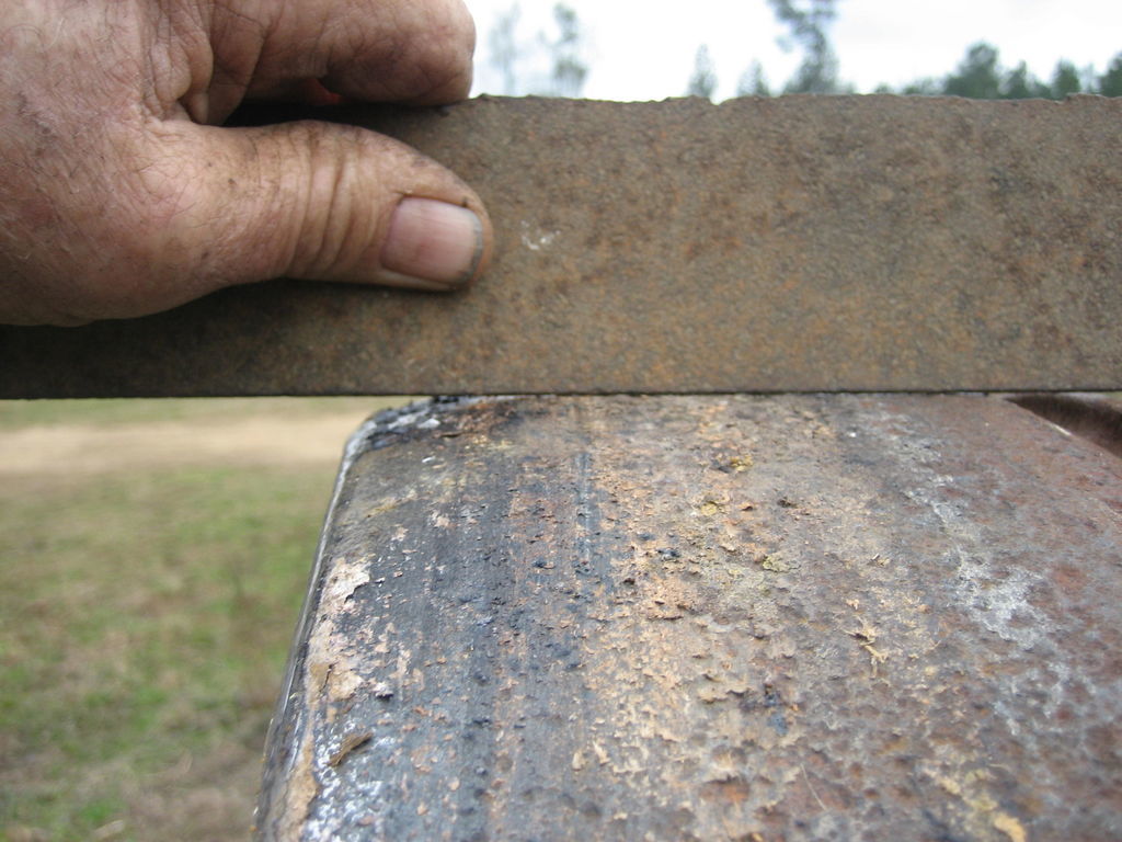

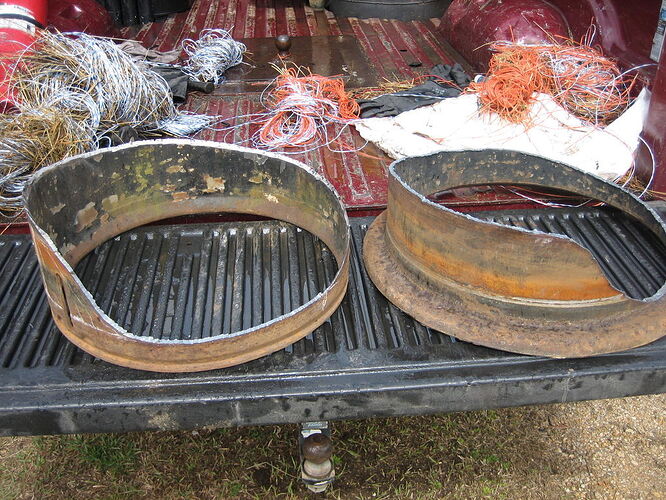

I made a quick trip out in the junk yard and got another rim and cut the spiral in it. Notice I sharpen the inside but not the outside so the force will be toward the anvil to cause the scissor action.
The last picture shows the clean cut after the repair even with the small limbs.
I figured it was a shear rather then a wedge shape. We were just hanging out and wondering how long a wheel rim would last before sharpening or discarding. How many years or tons has it been?
Morning Carl,
I think I have used the rim about 4 1/2 years. I don’t know how many tons or cords .

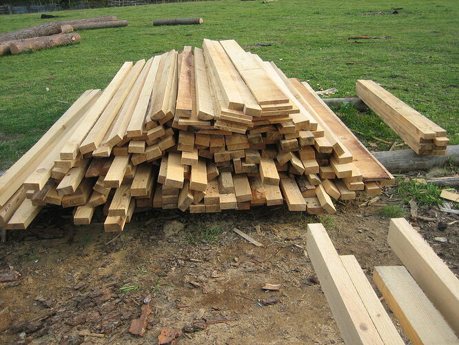

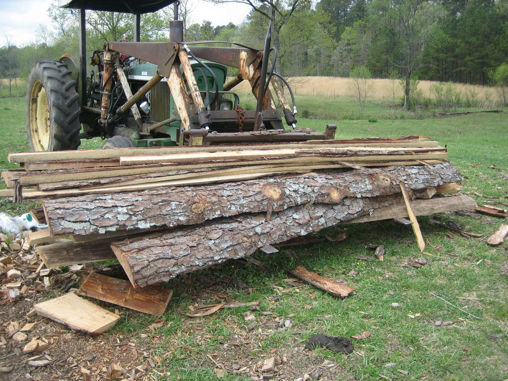

I have been sawing timber to put the top back on my barn that was destroyed a month ago and will need to get back in the woods for timber. I did get some sawing done today, picture below.

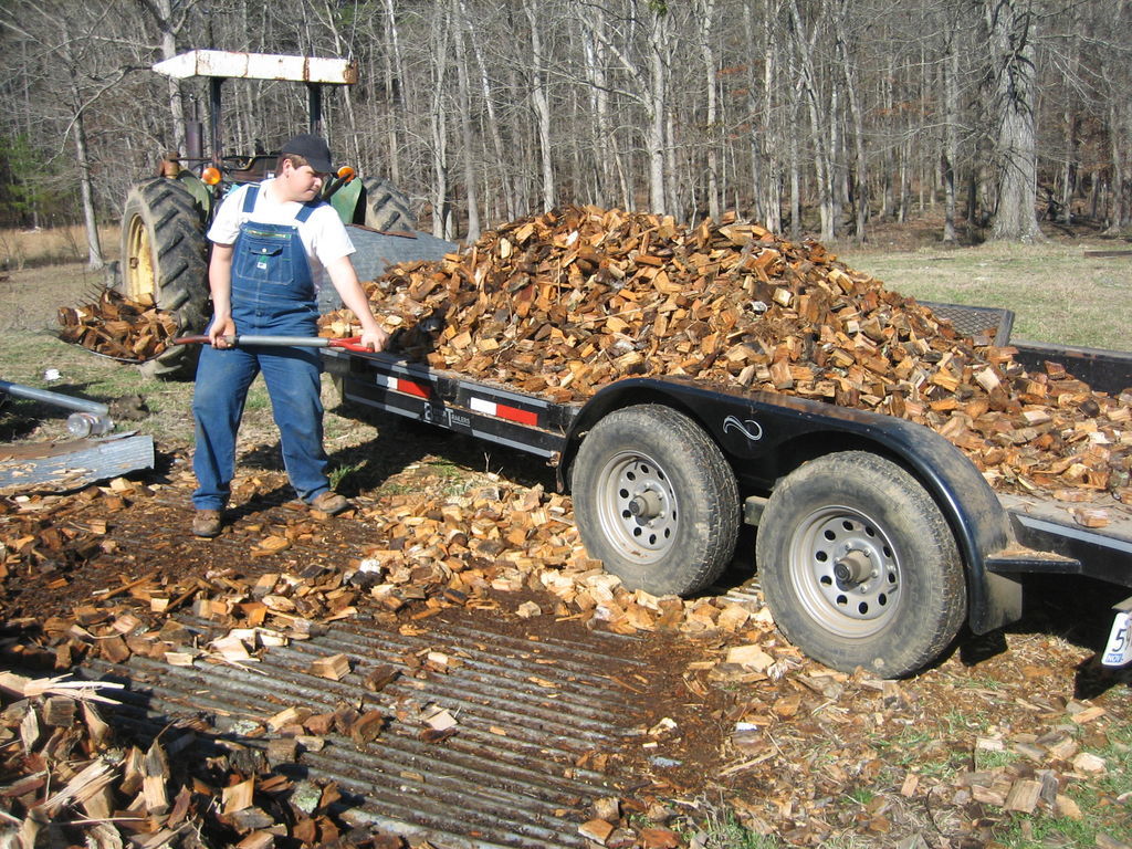

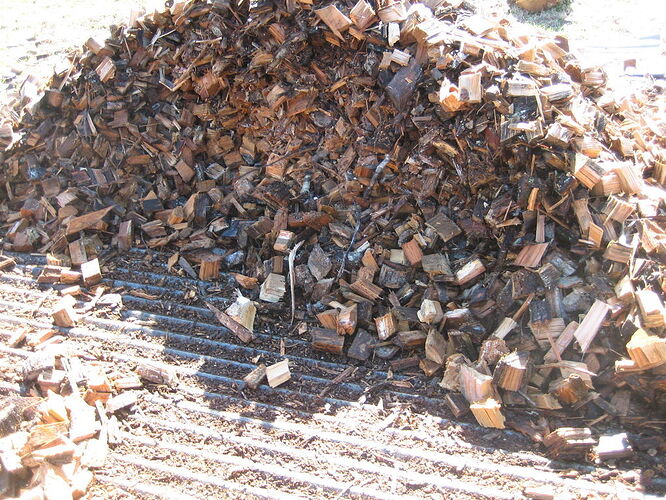

I have plenty of wood chunked right now but the slabs chunk so much better while green that I chunk them each time I get a load on the tractor forks. Just three or four days with the slabs laying out can make them a lot harder to chunk.
This video shows knocking the slabs down so they will go through the chunker.
