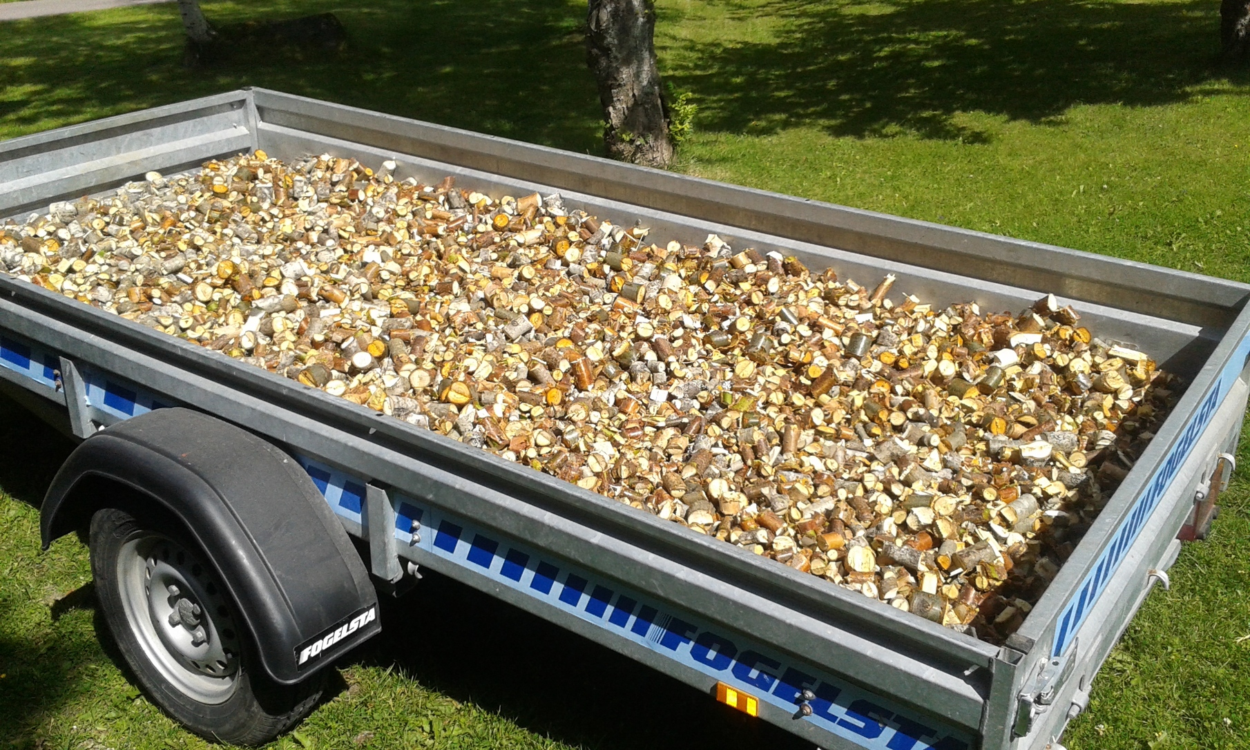

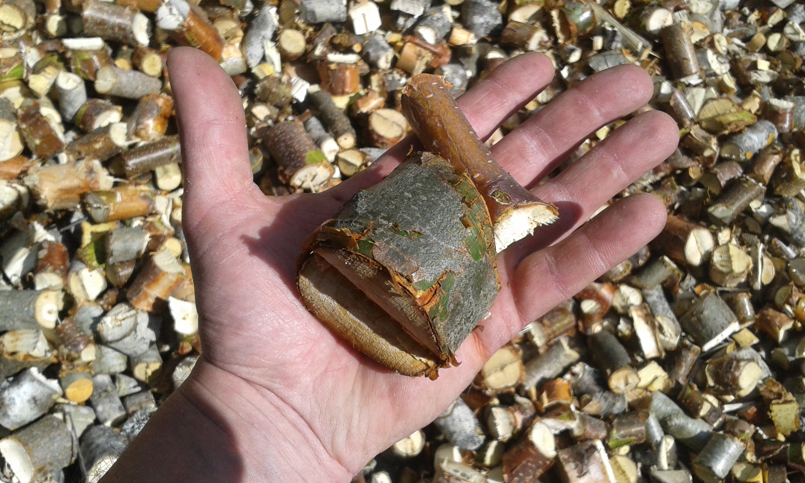

Still not perfect thugh. Woorks good on beech and oak, but hazel, chestnut, alder do not work. Blades are too far apart and leave a few fibres that hold the chunks in a long sausage…

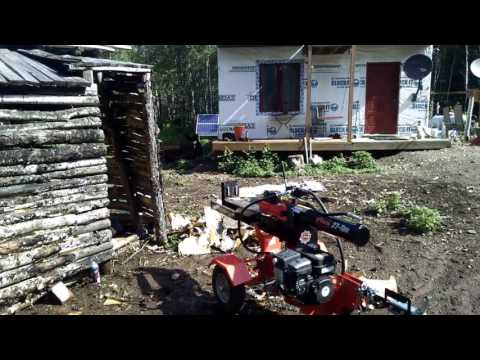

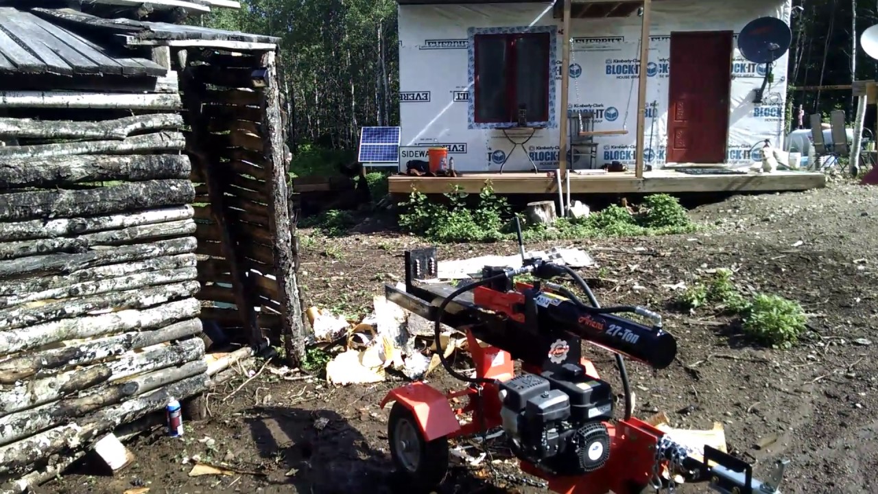

I made a 4 way adapter for the log splitter. I wish I made the wings longer and maybe still will.

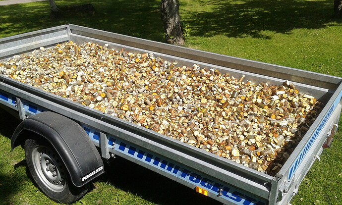

That sure makes a nice uniform wood chunker, and fast indeed, wounder how large of branch it will safely too you and the machine can handle, either way you could clean up the city or country for fuel with that Gem just with branch’s in no time.Thats the idea we all had in the back of our minds, is the guy that built it selling any plans?Thanks kristijan.
That rebak works good Kristijan! Small premium fuel for open road high speed performance :grin:
I see you bag up straight from the chunker. Do you always dry your fuel in bags like them? How do they handle UV-light?

It eats up to 4cm thick limbs.

Green wood, yes. They dont show much uv deterioration althugh you can easyaly make a hole. They are practical thugh…

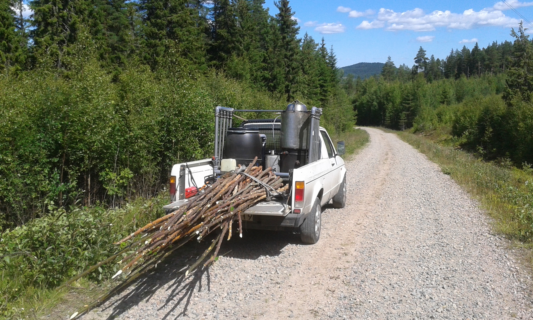

I went down by the river last night and delimbed a small batch of young growth until the mosquitoes chased me home. This morning I went for another one up by the power line until the horse-flies chased me home to the rebak chunker.
Looks like the bugs dont like wood preparation. I got chased by wasps yesterday :smile:
