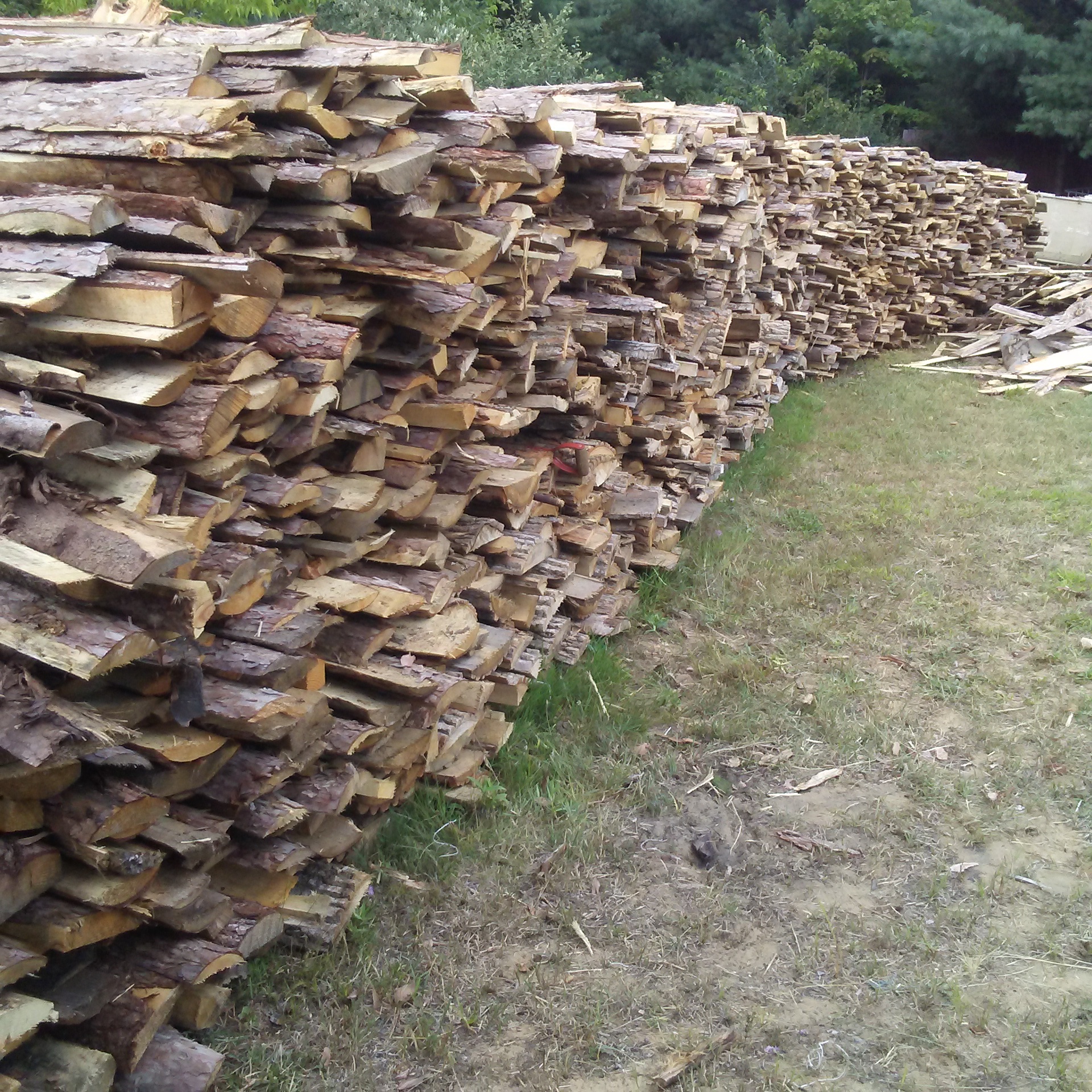

Got more wood too SWEM and looking forward too a warm winter with plenty of wood, i have twice that much too got get yet. Chunker trailer steel is in the shop too start on next.
6 feet tall 50 feet long 3.5feet wide.
