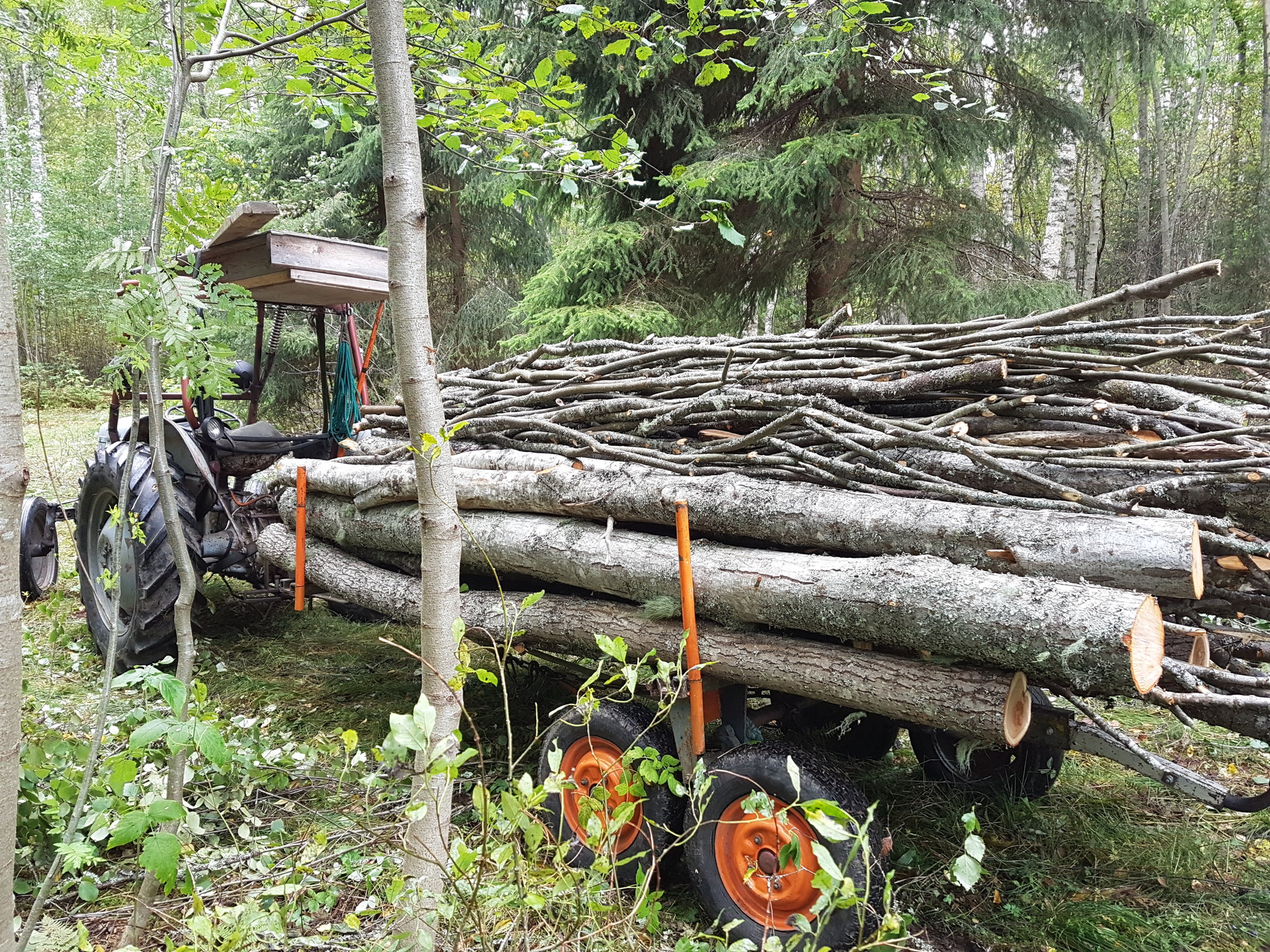

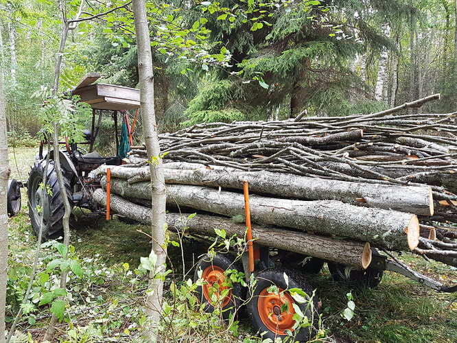

Whats the wooden thing in pic1 on top of the tractor?

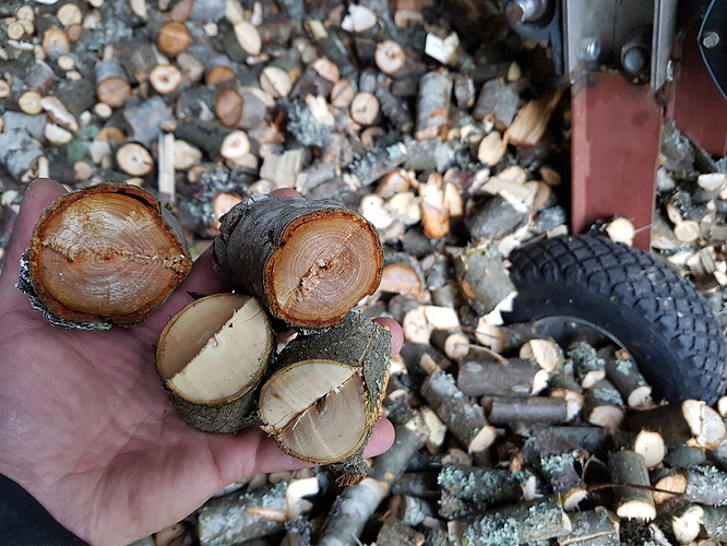

Kristijan, it’s a mix of gray alder, sallow, mountain ash and birch. The top two chunks in my hand is our gray alder. Turns red just minutes after the surgery. When dry they get pale again. Very bulky. If I run 100% I get only 60% of the distance :smile: Rich clean gas though. Almost no tar in gray alder.
I call it my skylift :smile: Convinient around the house doing painting, gutter cleaning and tree trimming.
Also it serves as a roof and an equipment box reachable from the drivers seat.

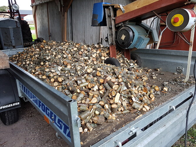

The homemade conveyor is stored away until spring. It’s for firewood only. It’s has a flat belt and the roundies I produce with the rebak would probably just roll back to where they came from.
I just put the rebak on top of the trailer and let it sprinkle the chunks. That way I don’t have to shovel them from the ground.
This video is from last year.
That video did it. I thought the equipment in the the trailer was the end of a conveyor. I see now it IS the rebaker. TomC ( I guess the conveyor wears blue pants and jacket and a cap )
