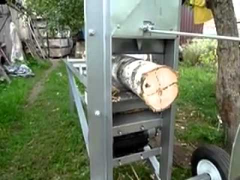

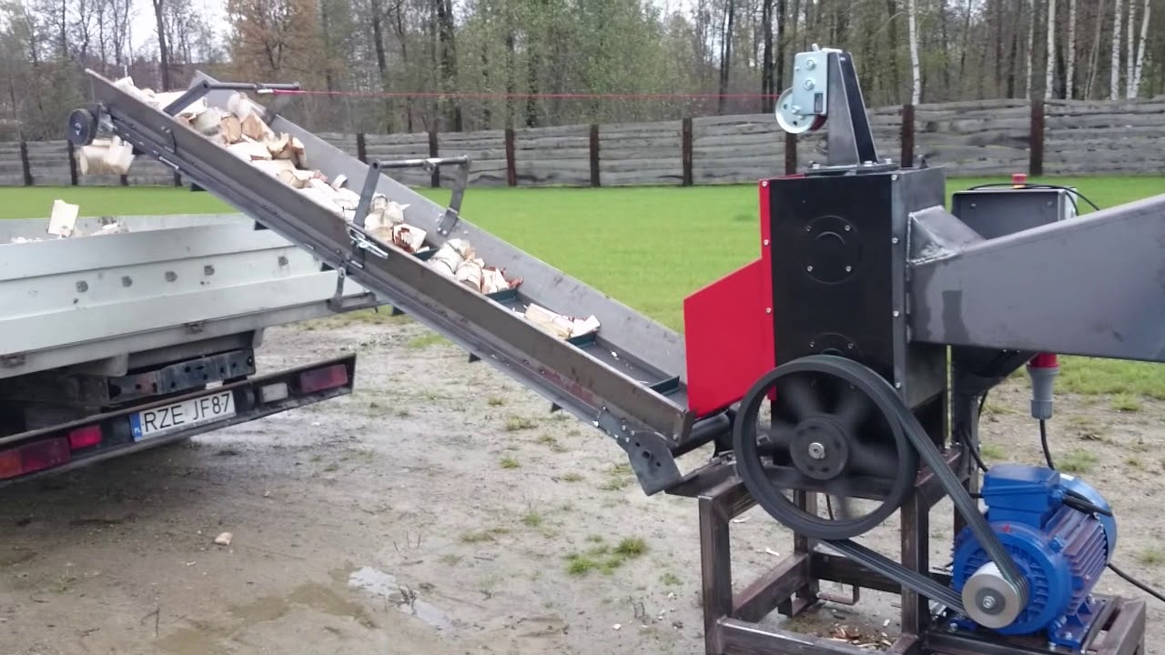

Everyone on this side of the pond cuts logs into 18–24 inch lengths and then split each of those into 4 or 5 pieces. I notice a lot of rebaks and other type chunkers over there that allows them to bag the wood and transport it to the furnaces. Is that process so that they can take the wood to town and sell it a few bags at a time? Here if you buy “fire” wood cut, split and dried, it comes by the cord or truck load so you need much space for storage. Is this a pretty good understanding of what is going on over there/? TomC

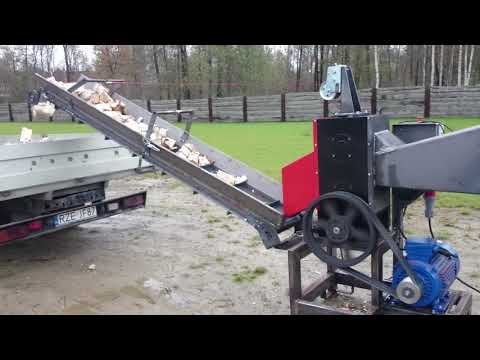

Dang that’s one nice machine sure does make short order of loading that truck.
Quick amount of water extracts wood by cutting it!
I like that one Pierre! My Chomper squeezes the water out like that. I plan on build one like in your video that is powered on charcoal. Use that style splitter. It would be nice to have the cut on an angle but then the splitter may not work out.
Tom,
Rebaks and similar are wery rare here too. automated firewood preparation is inly starting to become popular.
We have cords too. 1x1x4m of wood is our cord. Its the traditional way, but nowdays people often buy wood staked on special pallets, about half a cord, delivered to dorstep. But its wuality is always iffy, so the smart people sticks to good old cordwood
Tom,
If you asked me only a couple of years back I would have answered we all do it the same way you do it.
It’s only recently (since I got involved in gasification) that I found out about rebaks and all this short wood handling. That includes the 3-4 foot lengths across transportation.
I think this is an Old Eastern Europe fenomena. If you look at all those rebak youtubers, most of them are from Poland or other countries that used to belong to the East.
I never heard of anyone around here that owns a rebak (apart from myself :astonished: )

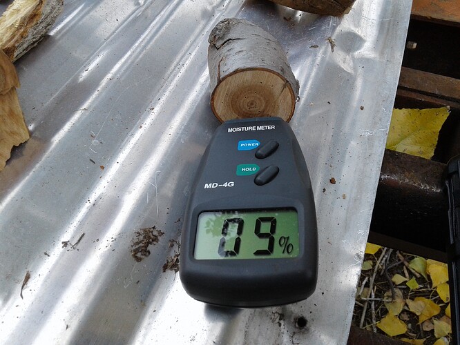

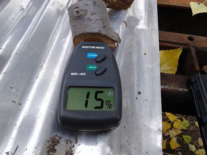

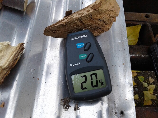

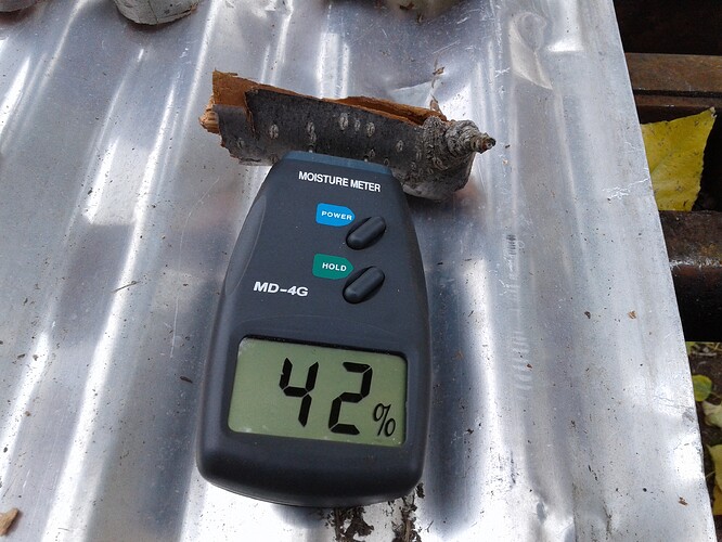

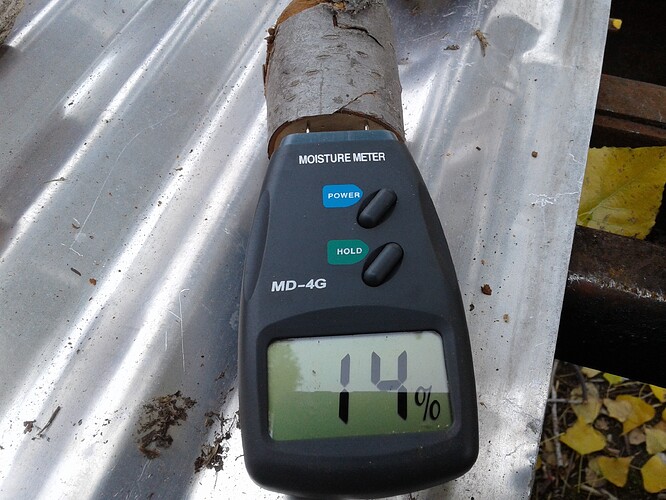

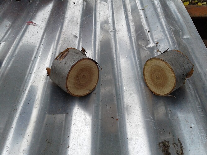

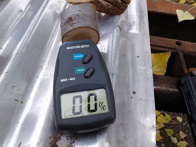

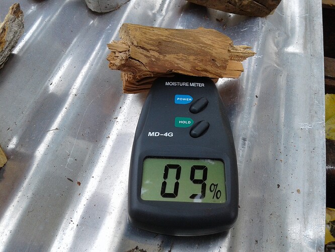

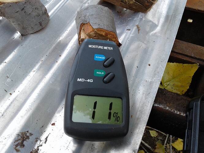

I thought I would post the pictures of my results of moisture contents I found of some random pieces I pull out the bags I chopped two days ago. Some of the moisture % is hard to believe. It might be on the saw off pieces I could barely nett the four pointed probe to go into the wood, and those points a sharp. I will let the pictures talk for them selves. I went back and forth on pieces of wood several times.
Okay I took a lot more pictures and I will stop boring you now. What is my conclusion to all this is this, if you chunk, chop, dice, slice, or saw it , it all depends on what part of the piece of the wood you place the probes. All these pieces came from the same uncovered wood pile. I would not hesitate on burning any BAG in my truck. Even the higher % reading wood, my gasifier does not care, it just condense more water out of the hopper and into the condescension tank. This is the beauty of the WK Gasifier. I now have about 800 lbs. of wood and a lot more to bag. HWWT, I’m going for a drive.
Bob, that confirms my believes: You can’t trust electronics :smile:

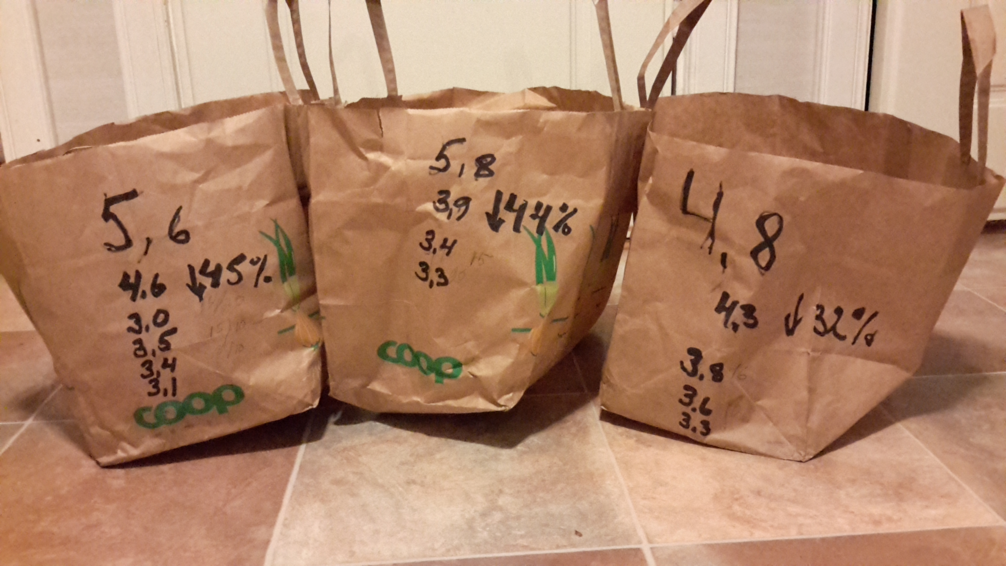

I did a test myself resently. I stored a few small paper bags with fairly green chunks indoors (don’t tell SteveU :smile: ). I put them on the scales as often as I could remember. After 20 days I forgot about them, but the weight loss had already leveled off. After about a month they still had the same weight.
All three bags were 100% pine. Could be the right bag contained some dead wood that was somewhat dried out from start. However 2 bags outof 3 lost 44-45% of their weight.
I still don’t know the remaining moisture content of my chunks. What I do know now is that if I were to fuel up with 20 pounds of green chunks, they contain a gallon of unnecessary water.

JO; I read what you wrote and looked at the photo and was impressed by the fact you lost 45% of the weight. But, it wasn’t until I converted it to pounds that it really struck home. 12+ pounds to 6+ pounds. Had you just cut the tree down and chunked it when you started the test, or had it already had some time since being cut. Just a few days of sitting around in the trailer could have already dried it out some. Very impressive. I have 20 bags sitting out in the shop that have been there since I took my truck apart last year. The wind may just blow them out the door if they loose that much moisture continually ( kidding ) I have had to rebag a couple of bags that the plastic they are made of deteriorated from sitting where the sun hit them. These are heavy farm bags like the old burlap ones only they are now made out of a woven plastic. Must be very biodegradable. TomC
Hi Tom, I agree that is amazing how much water comes out of the wood. Your wood is going to produce some fine wood gas when you burn it. Hope you get the gasifier up and running soon. I 'm still planning on making it to Argos next year. It will be a long drive from Washington State, but it will be worth every mile. Hope to see you and your truck there.
Tom,
We have been felling timber this fall. After the heavy equipment guys left I ran around with the little Fergie on the cleared area and collected a couple loads of leftovers to add to my backyard woodpile. The wood had been laying around on the clearing for a week or two before I brought it home. I sawed some cockies off from a few different logs and chunked them up with the hatchet just for an experiment. I guess the wood may have already lost a tiny bit of moisture when I chunked it. However, fall is damp and the bathroom scales might not have noticed a few drops were missing.
