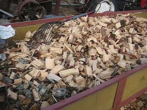

Chunking hickory this morning . It is tough and dense motor fuel and harder to handle than pine but will take me a long way down the road :grinning:
Ha, it seems your cattle are quite sociable and have a real interest in the chunking. I wish I was there to lay down beside them and watch your progress :smile:
That is funny. I have to keep my cows away from the tractor they will lick the paint right off looking for the grease and oil leaks… My late uncle always joked if you wanted to clean up something to work on it just park it in the barn in no time the cows will wash it right off. besides if they where loose like that here I am sure my neighbors would have a thing or 2 to say. Besides the fact that my road has alot of traffic.
