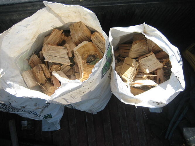

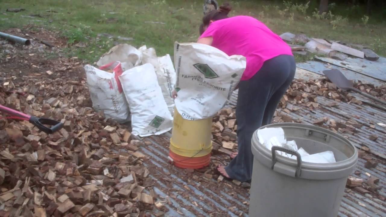

Thanks Don; The thumb part, I had forgotten and the internet didn’t say anything about it. I think that will make my knots much faster. My uncle had a flat rack truck so when we combined, everything got bagged. I held the bag under the spout until it was just about full then my uncle would take it while I got another bag. When the one was full he drug it up to the front of the rack and tied a piece of twine around the mouth. The miller’s knot is easy to untie when the time comes. No wonder I forgot how to tie a bag, that was 65 years ago. I was 8 or 9 and I drove the truck around to the combine when the hopper got full.
While fueling up this morning I took this short video.

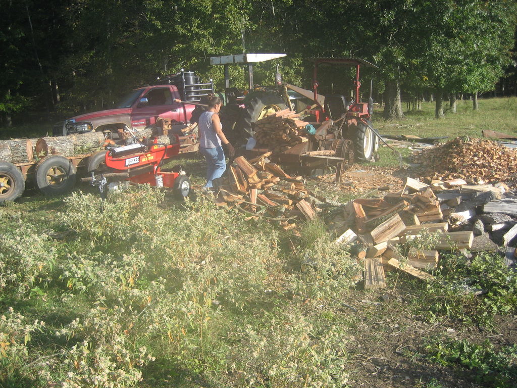

If there are two of us one can hold the bags while the other shovels but the wife will usually have plenty bagged up ahead.
Each bag will be 13-15 pounds.

At the moment I have 2 guys doing it, one holding the bag, the other filling.

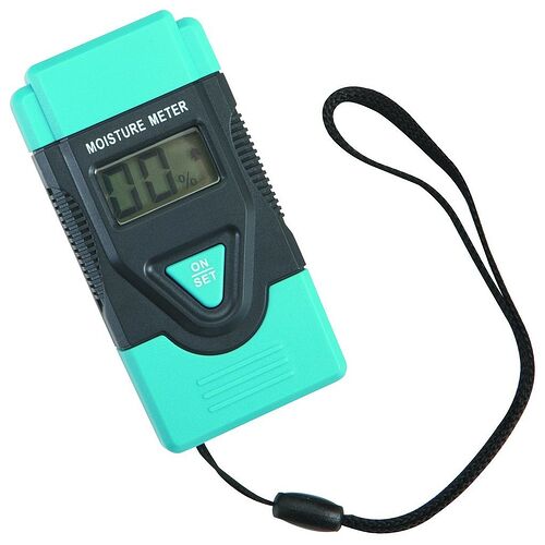

Got a new toy at Harbor Freight today. Under $15, and very compact. This little fellow is sure handy for checking gasifier wood.
I’m running a little time-crunch experiment to see how wet of wood I can run in the gasifier - a lot of this will be over 40%. “Dry” would normally be under 20%. So it’s not ideal, but we’ll see how it handles the extra moisture. So far so good!

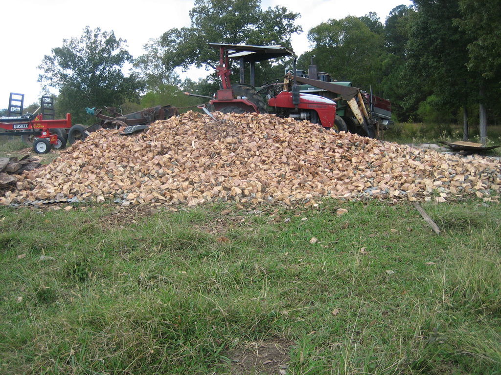

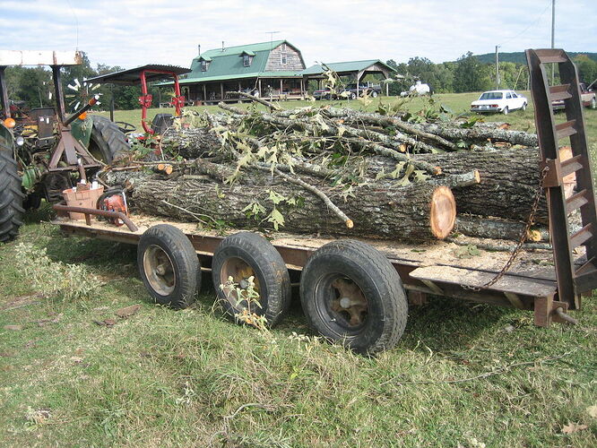

The wood I had outside (pine) I was able to get it inside and will be bagging it up in the next couple of days. I usually use saw mill slabs but this summer I did very little sawing so no slabs. Chunking the wood can go fast when the sawmill edgings and slabs are already sized for the wood chunkier.

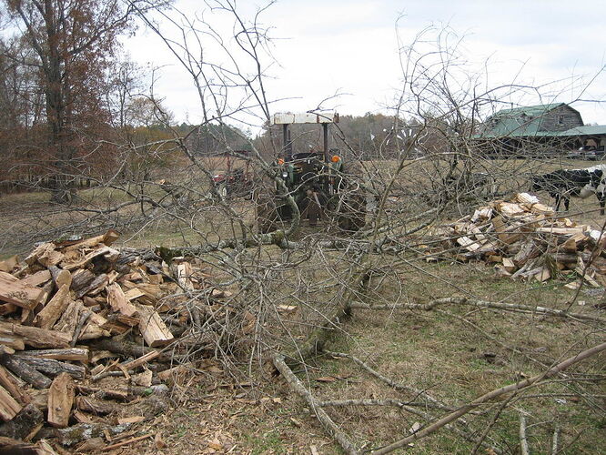

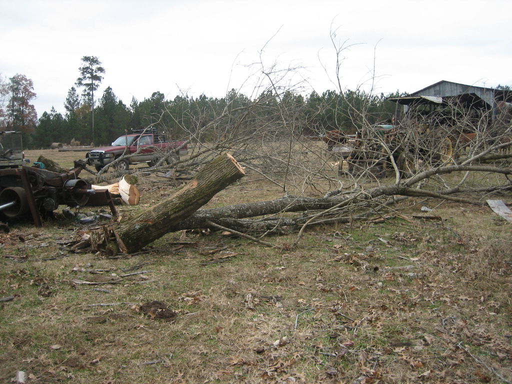

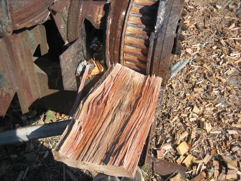

I cut some cull oaks and hickory’s and chunked them. Any of the limbs that are less than four inch diameter work out really good but for the trunk of the tree I saw in lengths, spilt and feed the chunkier. If the pieces are straight grained I can leave them wide and use the wood chunkier to split them down to size before chunking. (Picture below)
Once the wood is spit into pieces I waste no time. If there are some juice in the wood the chunkier will cut the oak and hickory easy.

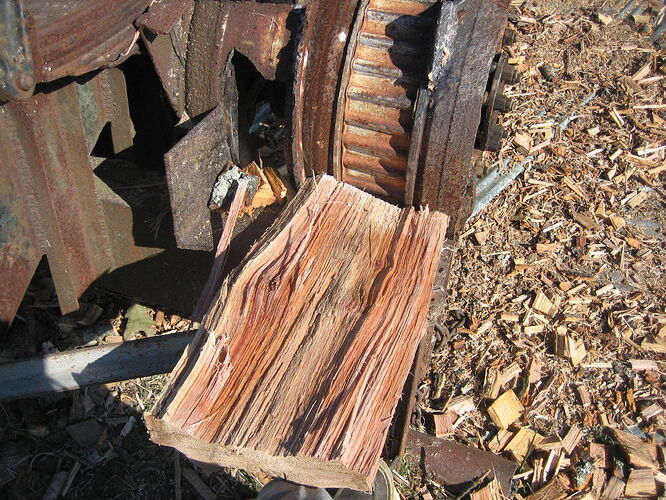

I think the chunked wood will dry faster than sawed wood and also faster than the disc and hatchet method ( http://driveonwood.com/forum/1174?page=2#comment-18710 )
If you look close at the chunked wood you will notice how it has been fractured . Also the pressure from the chunker will squirt water from the wood as it crushes it.

I have several dead trees close to the wood pile but one was across a ditch and will be too muddy after this weekend to get to until next summer. Almost too much mud before the forecasted rains. I pulled it to the wood pile and making use of it.
